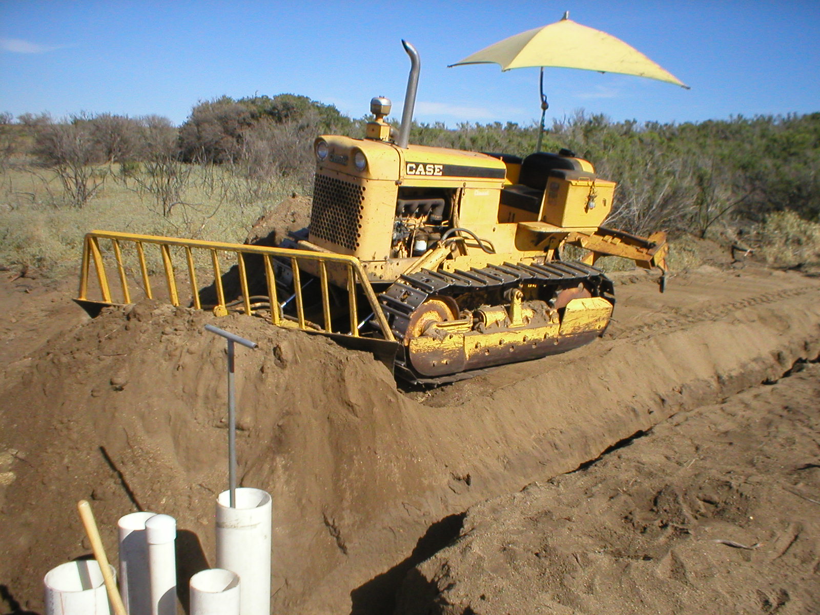

@mtn view ranch,I enjoyed your pictures of your dirtworking project and such a nice view. The case dozer looks very nice and looks right at home on the range.:thumbsup:

Cool little dozer. Did you fancy it up yourself or buy it that way?
I did the rebuild myself. Here is what it looked like before I started. I used it as purchased for 3 years, before doing much of anything to it. It is a good little machine. ;)
