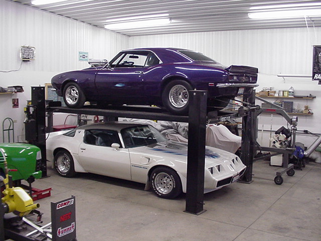

That's what I did in my shop...bright white steel, the ribs keep it very stiff and it's alot lighter than sheet rock. My contractor hates the thin "liner steel" (29ga maybe) so he did regular building steel (25ga???). Finished part of the shop is 40' long with trusses 8' on center...a 24' and a 16' did the job and it looks great. You can get it cut to length. You will need a poly sheet above.
A neat trick I learned from him (he does this for a living)...lay several sheets together. Mark out your screw holes and bang them HARD with a center punch. Peel the top sheets off to install but when the lower sheets start to lose the dent, slip new sheets underneath and hit the old dents again with the punch. It makes a very straight line and that dent is all you need to start the "pole barn" self tapping screws.
He learned the hard way that you can't drill them (rust issue). Amazing that you only have to lay out the screw holes once. Thought I'd share that.
Do you have any links for the material you used? Prices? Store? I like that idea.
When you say "poly above" are you referring to a vapor barrier? between the steel and insulation?
Poly is just HD poly sheeting stapled to the bottom of the trusses before the ceiling material gets attached. The problem with steel ceiling is condensation might lead to rust (although I doubt it anymore...the coatings are much improved). Regardless of your choice of ceiling material I would do that anyway if you have a steel roof (I've heard about "rain" in the shop from when moist air hits the underside). Cheap if you do it now. Just google "steel siding" and poke around (you'll notice Menards is listed there). As noted above, my builder used standard building steel on the ceiling rather than what they call "liner" steel. It's more rigid and is only attached to the 8'OC trusses.
