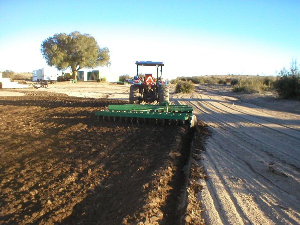

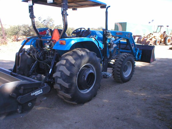

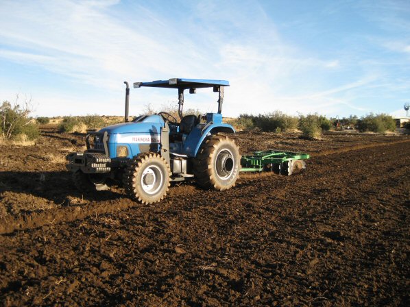

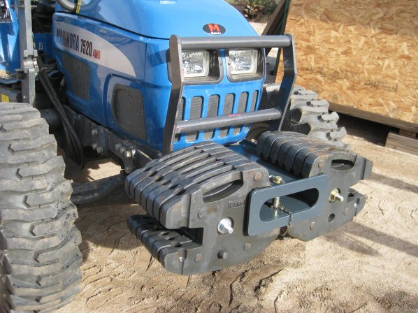

I can run with the loader and be at about 12,500lb or take the loader off and run at about 11,500lbs.

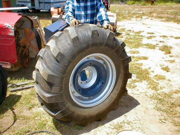

As you can see, I doubled up on my front weights, I run 6 wheel weights per side and I have all 4 tires filled. This is what I had to do to be able to get the maximum capabilities out of the tractor.
Our property was burned in a wild fire and there were just to many potential tire disasters waiting to happen if I had gone with Ag tires. So because of less traction with the R4s, I had to add a substantial amount of weight to have maximum traction and not just have the tires spin.

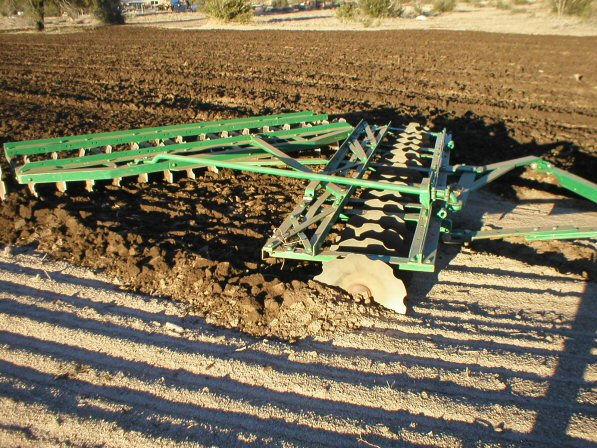

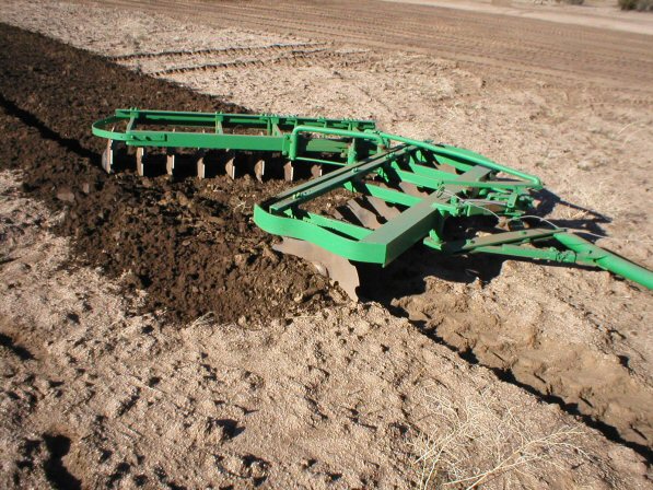

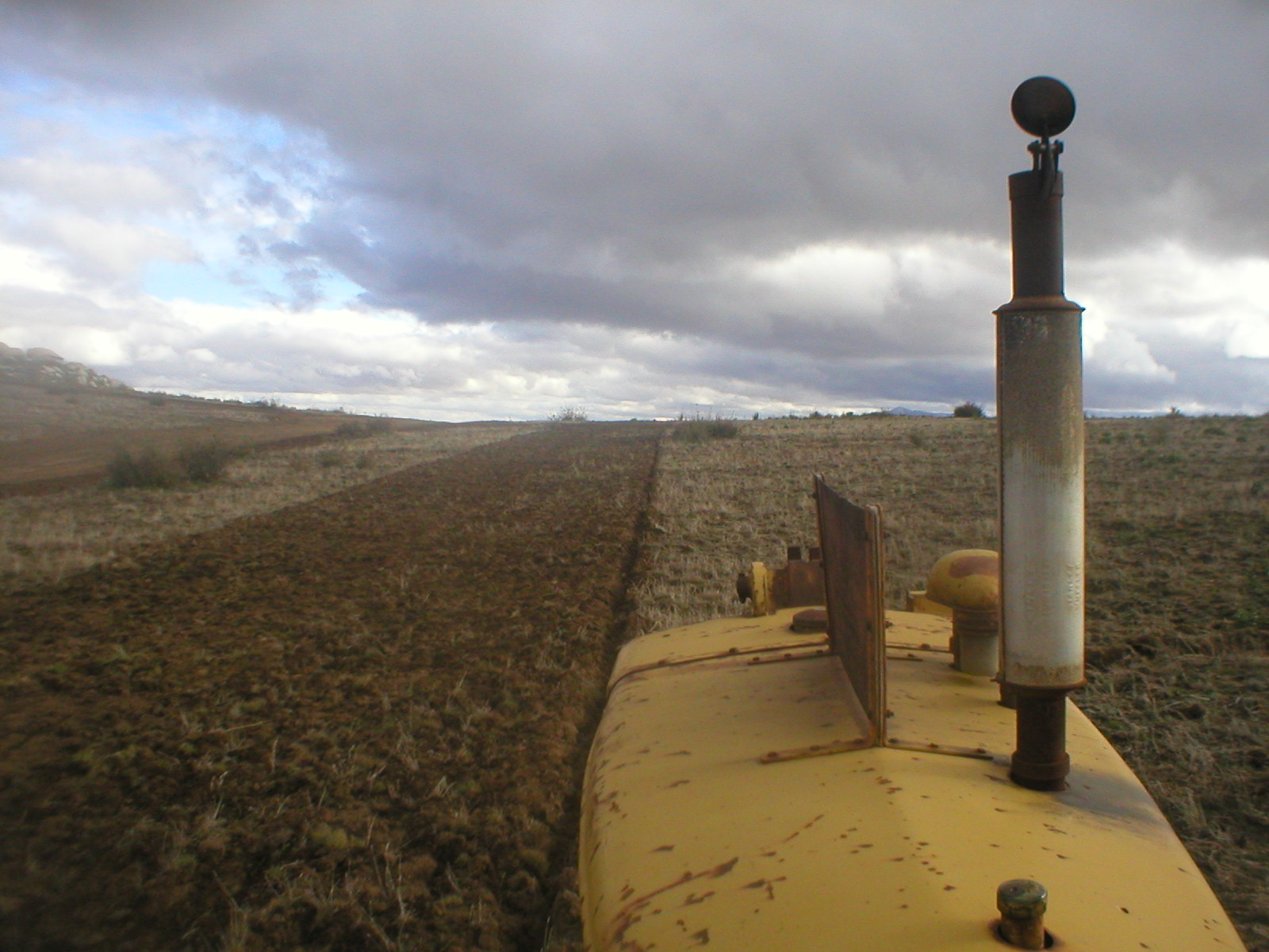

I can just pull our 12' set on flat ground, typically use the D6 because most of our land is rolling hills. The 7'6" set is like there is nothing back there on the flats, but on 2nd pass going up hill at about 9" deep it's all the tractor wants.
Our disks are the old John Deere Kielfer pull disks. No transport wheels, you lessen the angle if you need easier pulling. We always run at maximum angle.
