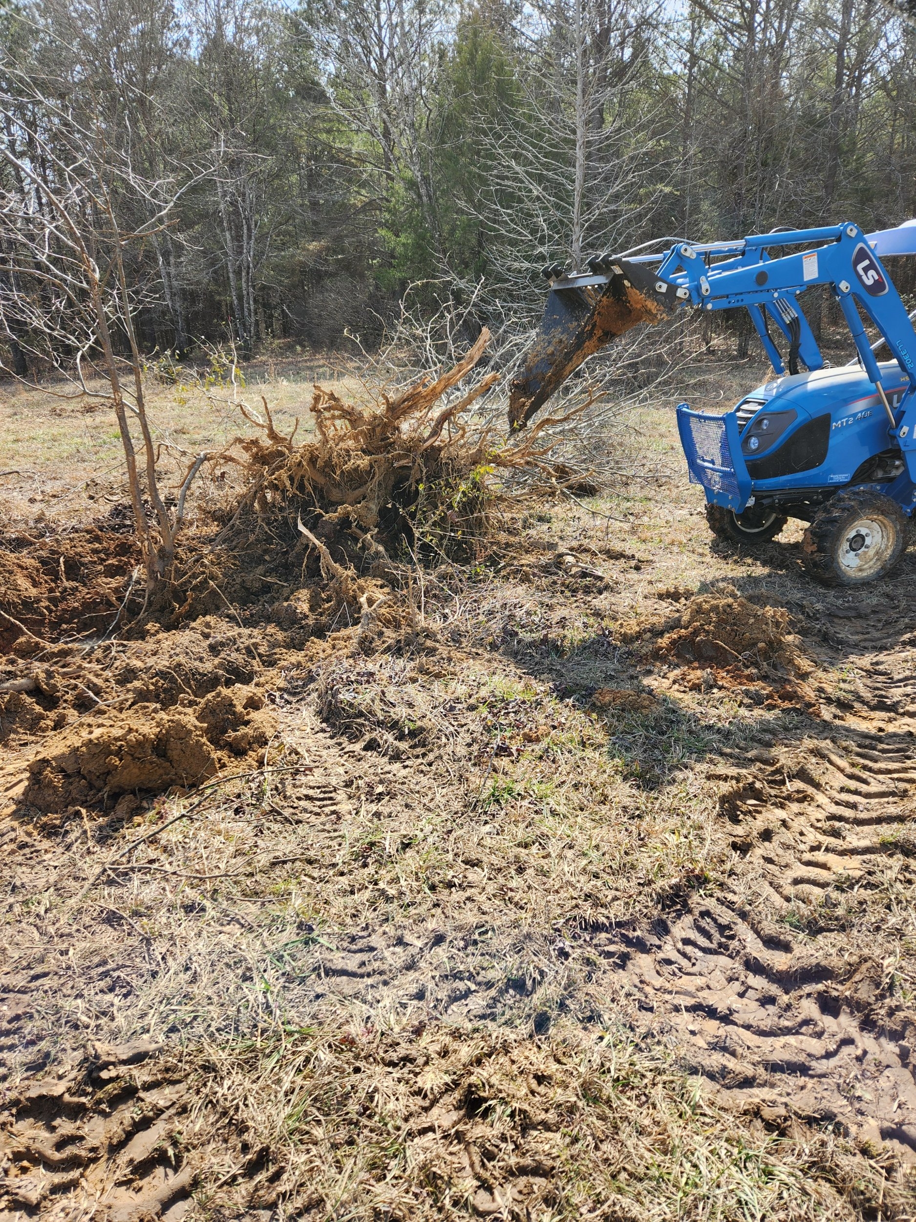

I have one and have used it quite a bit.
It is not a backhoe but it does have it's place
It takes some getting used to and the problem child is the stumps with a "deep" tap root.
Best to use it in damp soil after a rain.
The easy ones is the old stumps, 3+ years and they just dig out with very little digging (most of the time).
I have not worried about damage to the FEL since the my stump bucket comes to a narrow point on the end and I am able to keep it centered.
It's great for digging holes for planting trees and stuff.
I am satisfied with mine and would buy again.
Pictured is a group of 8 trees bunched up, largest was over 6" and 15ft tall. Most difficult was the one remaining standing. It took an additional two hours to dig this one tree out, the tap root went down over 4 ft and I was worried about getting stuck when the hole kept getting deeper and deeper.
