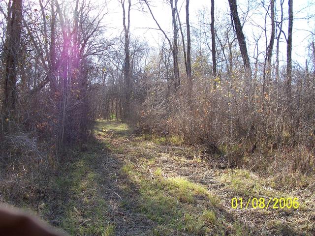

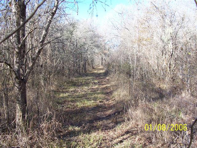

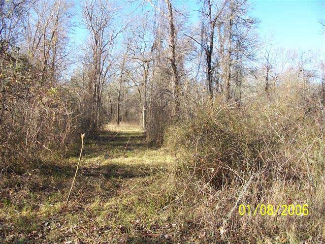

I use my little L all the time in the woods and thickets. Just mow the shooting lanes and ATV trails. Mowing will also mulch up the trees and not leave them piles up anywhere. You don't want them bucks to go around a mess!! :D :D
couple pics...first pic the left side of the fence use to look like the right side..
second pic, the lane I cut looked just like the left and right...
third, again look at the left and right, I just picked a line that didn't have a large tree in the way.
And the last...my tractor in the woods. These trails have lasted 3 years so far. They get some ATV traffic. The grass has grown up a bit but nothing worth mowing yet.
