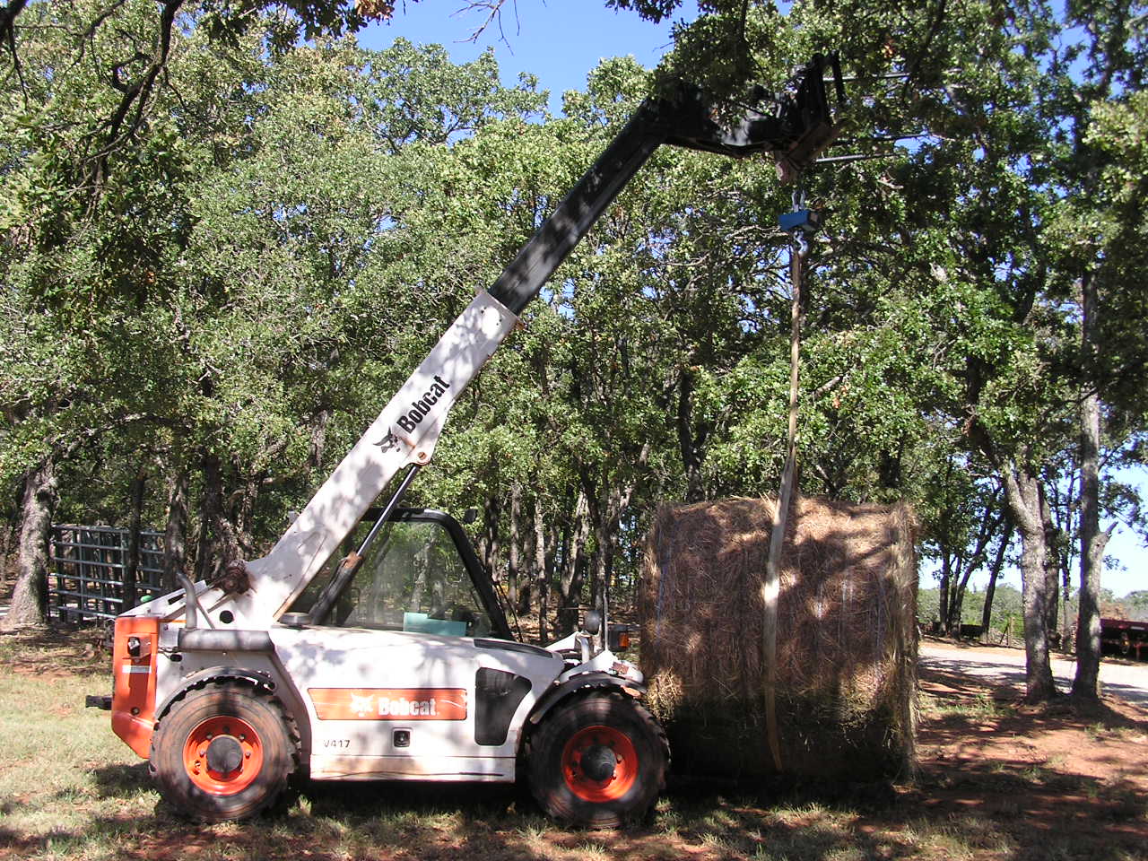

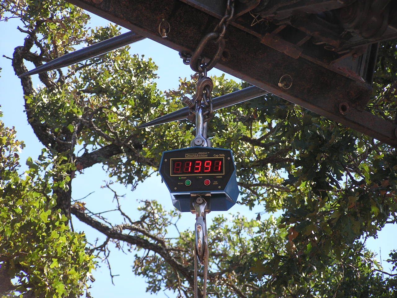

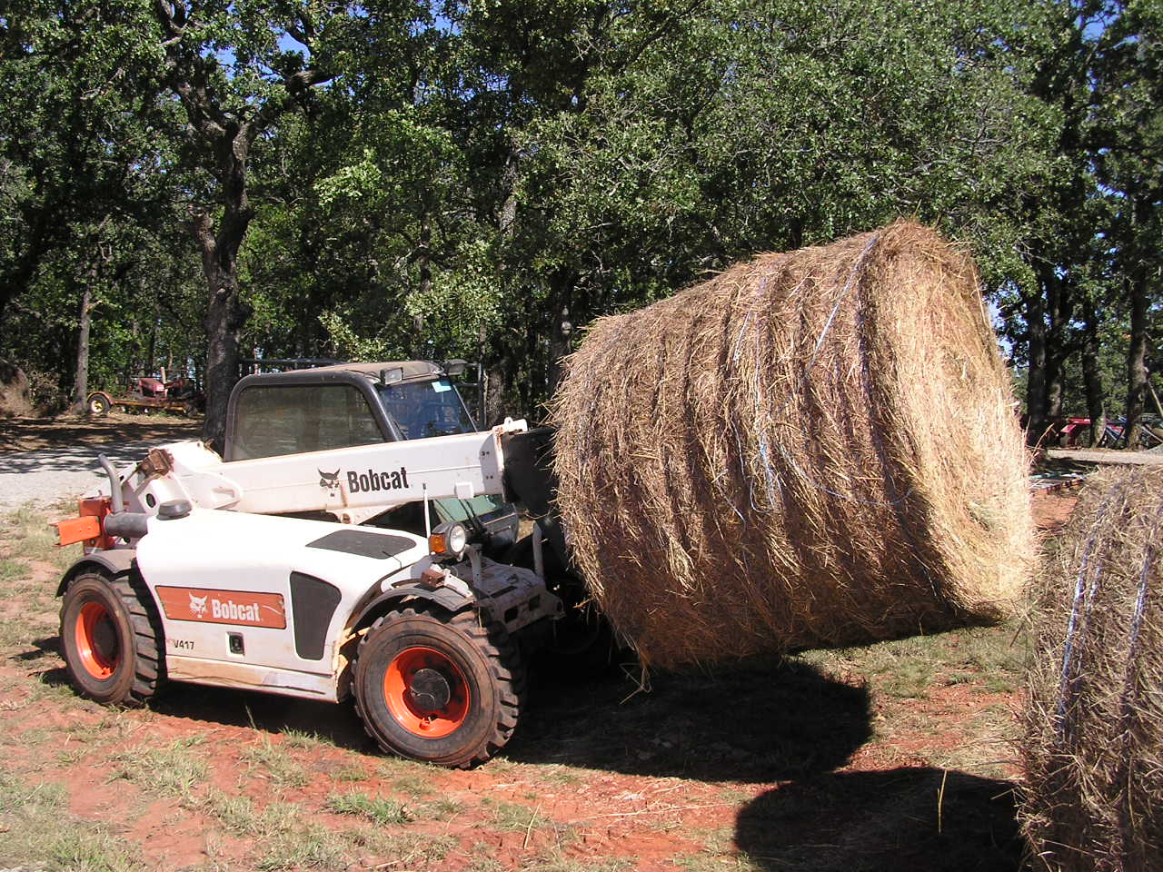

You didn't say what size bale.
Around here a "large bale" is 5x6 and weighs 1300 to 1500 pounds, depending on the moisture content.
This large bale weighs 1391 pounds.
Where is that lift capacity measured? The farther out from the loader arms, the less weight it will lift.
