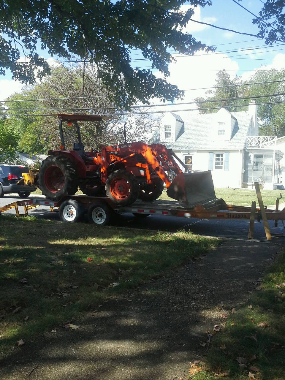

I've an M4700. Running unloaded R1 14.9-28's. I need to narrow the stance so it will fit on the trailer better.
How difficult is it to swap tires with one old guy (me) and one 30 yr old guy (my son)? That's assuming I can loosen the bolts.

If you have a backhoe it is easy but if the tires are loaded they can be way heavier than they look. If you soak the bolts with penetrating oil and use a good fitting impact they come apart pretty easily. I would however recommend having new nuts and bolts on hand if you have to ruin the originals getting them off.
