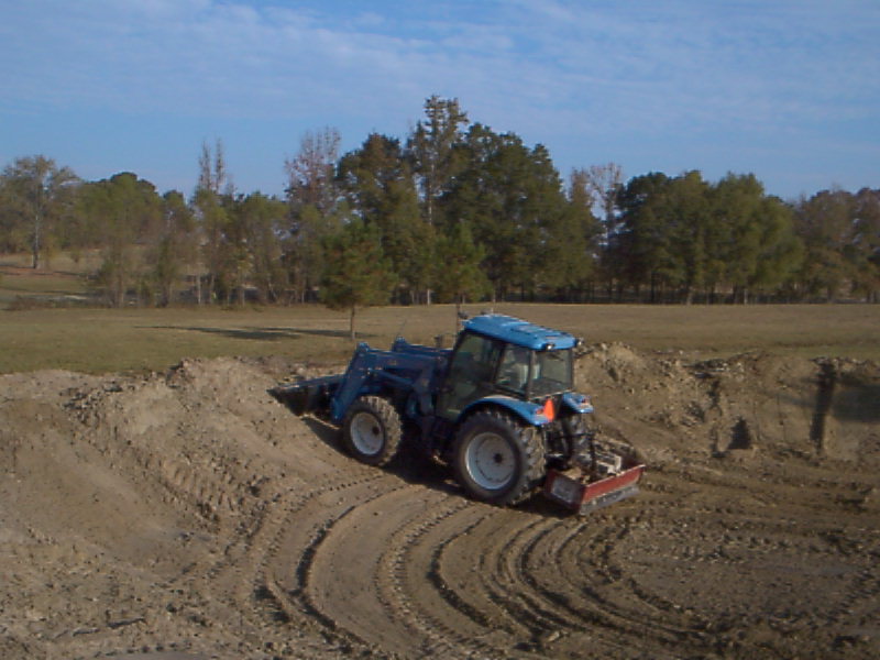

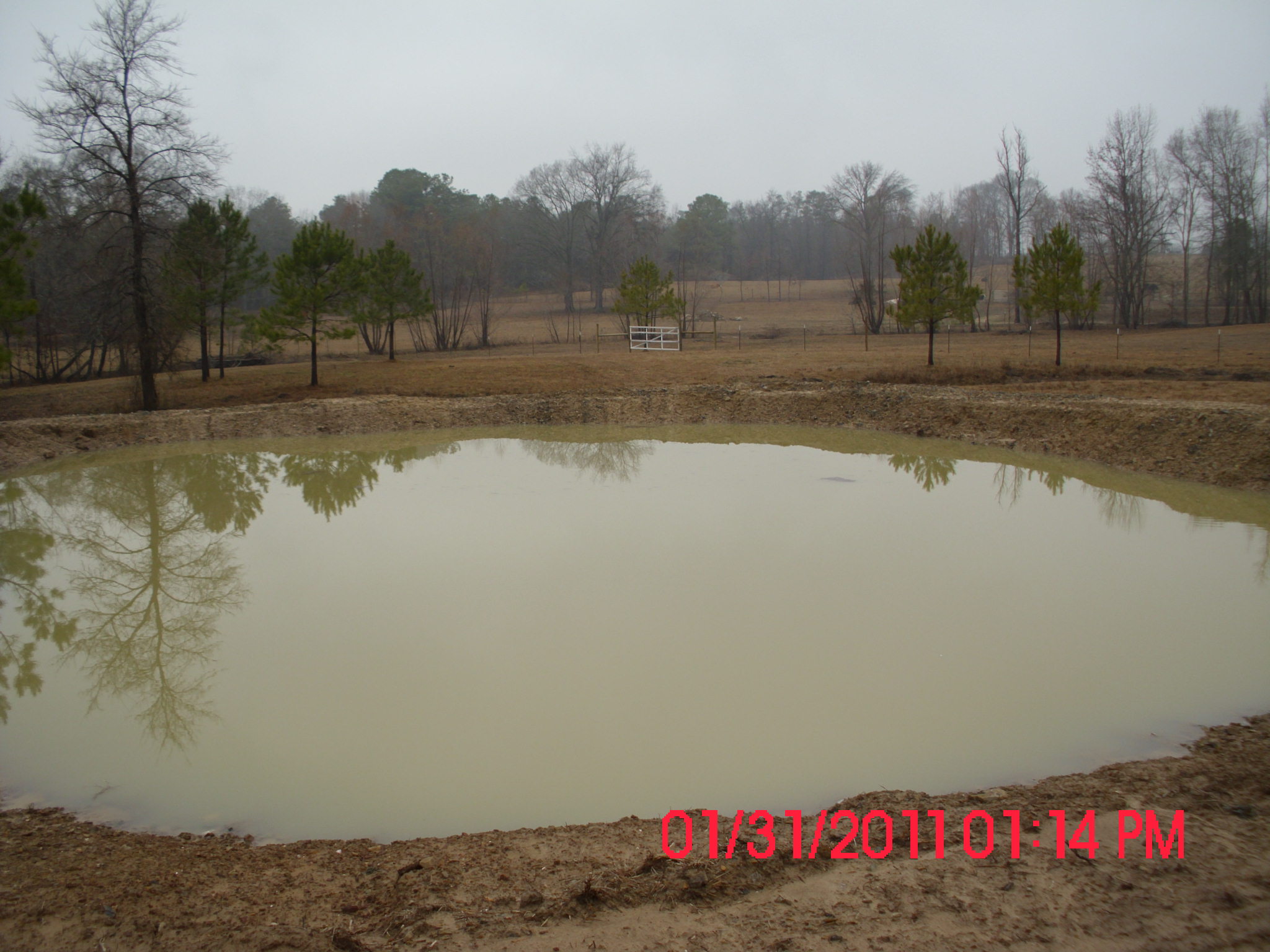

The day after I got my tractor, I started digging this. 20 engine hours later and a few months of rain it looked like the second photo

Nice pond. I'm wanting to dig one too but I think my swampy terrain is gonna be too much for me to do with my tractor. My land has never been groomed. Is right next to a creek and seems the water table is high. When I get out to try it seems I can't go 10' in any direction without hitting a small pool of water. Spots in between, when it try digging I'm soon in a mud hole at least a foot deep. Seems I'm gonna need to rent a big excavator to dig my pond. Hopefully the dirt I get from that will help me raise and level some of my land.

Gary that pond looks good. How many hours did you figure that you have digging? Did you cut it all your self?
   / why we have tractors #7
It took me 2 days to dig it out and work the inside levees packing them with the front wheels, then a half day or so to trim down the levees from the outside and walk them down including getting on top of the levee and spreading and smoothing and packing the dirt some more. The digging was pretty easy going after I got down past the really hard dried out stuff on the top foot or so. I hit a layer of shale rock at about 5 feet underground and I left that covered that with a few inches of soil so it stays water tight. Shale is sometimes quiet porous. I dont know how thick the shale layer is in that section, but my brother in law had a pond dug several hundred yards from my location and he went over 6 feet down with his. I dont know if the digger hit shale or not, but his will hold about 12 feet of water. Mine only holds about 5 now but I plan to add a little more to the lower end levee to bring it up level with the two side levees. That should make it about 7 feet deep then. I didnt have a transit level so I just eyeballed it and the lower end turned out to be much lower than the sides when it filled with water.
As you can see in the photos, when empty it looked pretty good for levee height, but when the water filled up, it was much lower on the lower end.

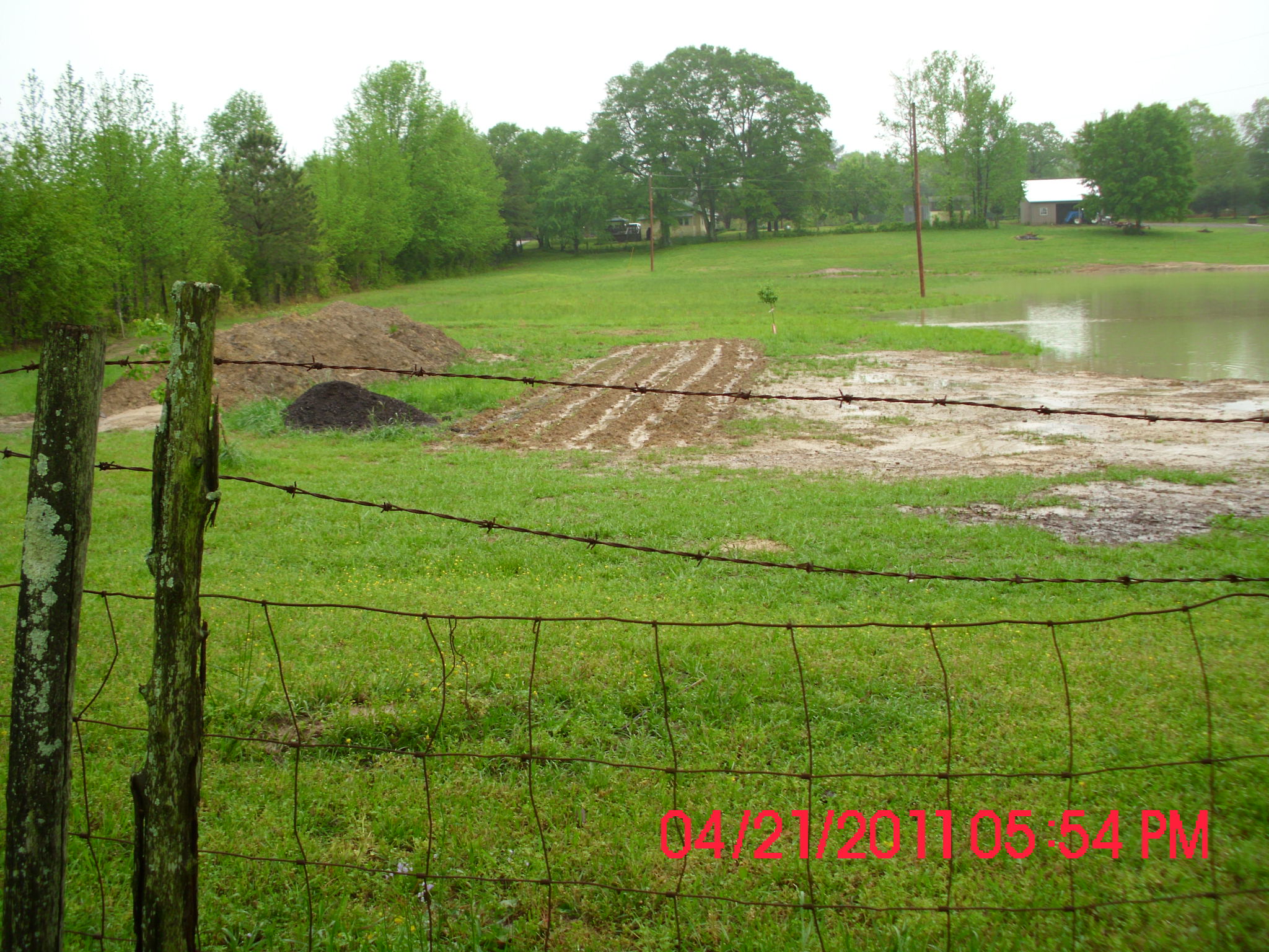

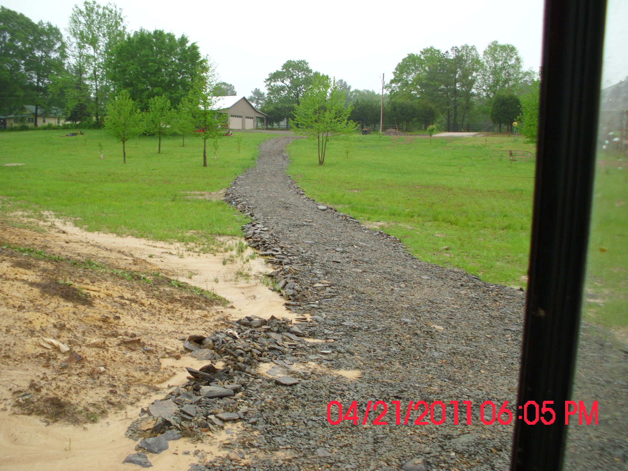

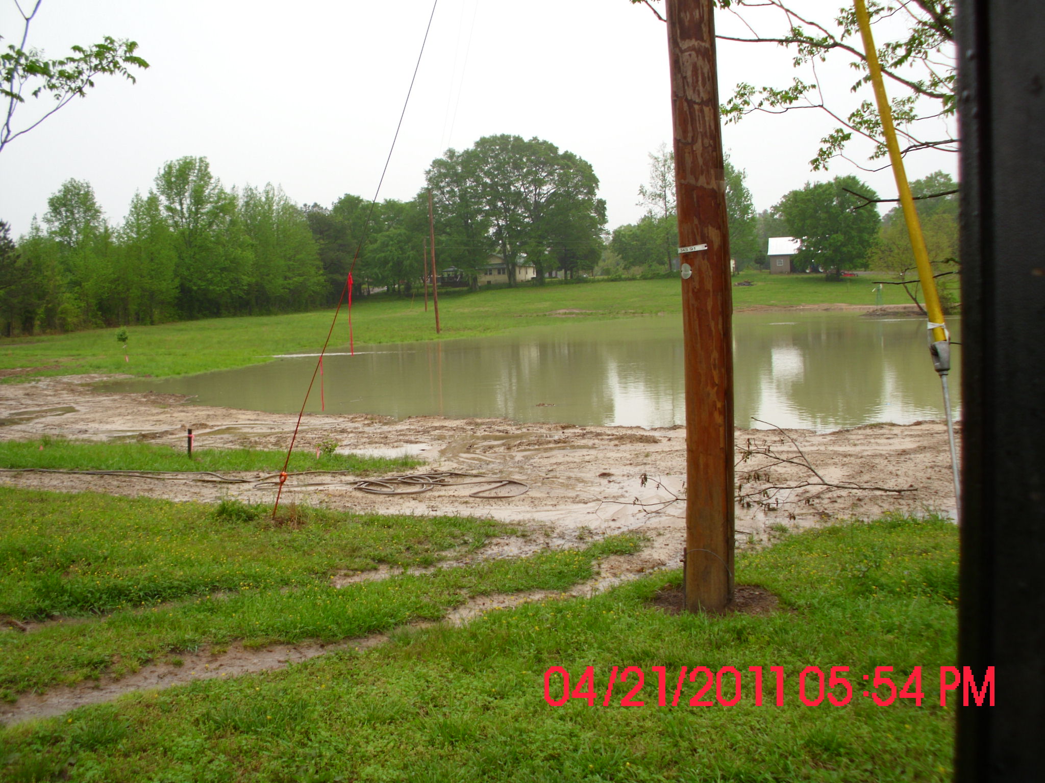

Well , here is another reason to have a tractor. I built a road to travel between my house and brother in laws. My wife uses a golf cart and there is a low spot where the pond overflow runs thru. We put in a culvert and rocked the road so it is now all weather without the mud.
Also use tractor to disc up and row up a spot for additional garden for corn, okra and squash. Brother in Law and I are slowly doing away with the dirt piles. There was a much larger one where the garden strip is located now that was used to fill in low spots. around the pond. I wil use some of this remaining pile to raise my pond levee a bit this summer when it dries up a bit. It has been raining just about every day for the past week.
