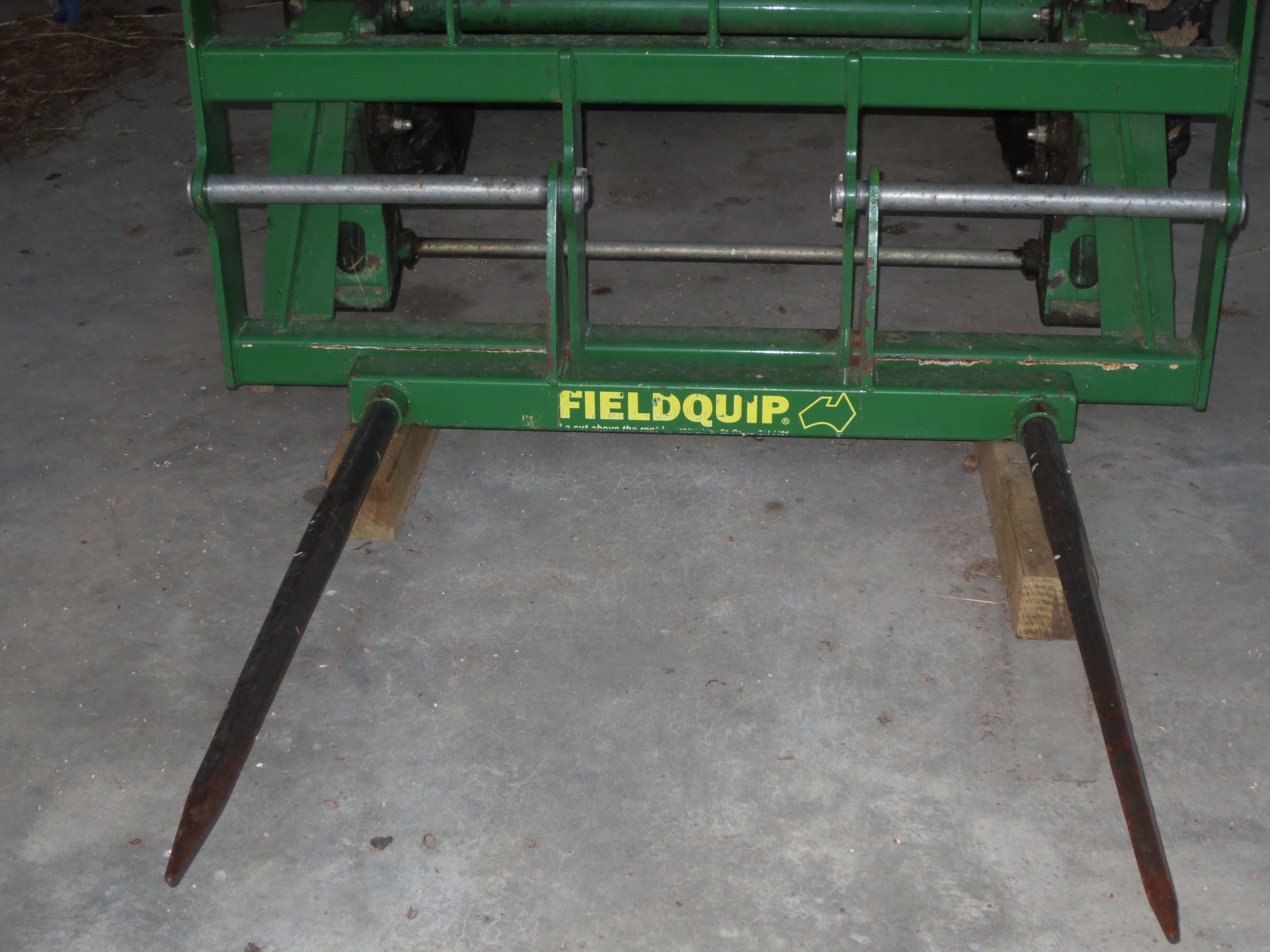

BTW, I could use a set of forks on rare occasion. Do y'all find it easier to use a true FEL fork attachment, or just bucket clamp-on forks? My loads are 300-500 pounds max, just moving stuff on & off my pallet racks.
/ Why SSQA? #103
I have had both, and can tell you the dedicated forks are better for a couple of reasons, one you can see better without a bucket in the way, and you can lift more without a bucket on and with the forks stuck way out there in front of the bucket.. BUT, not to say that bucket forks can't be useful. But if you have much "forking" to do, and can justify them for how ever much use you can put them to, then the dedicated forks are better.
/ Why SSQA? #104
Dedicated forks are better, both because as K0ua stated and balance/lifting-capacity.
I've said that I have a combination pallet-fork/bale-spike attachment. Personally, the spikes are what I use the most and they rarely come off but all I have to do is un-pin and slide the steel bars back, lift off the spike assembly, and then slide the forks (individually) onto the steel bars. Then slide the bars into the holes and pin.
