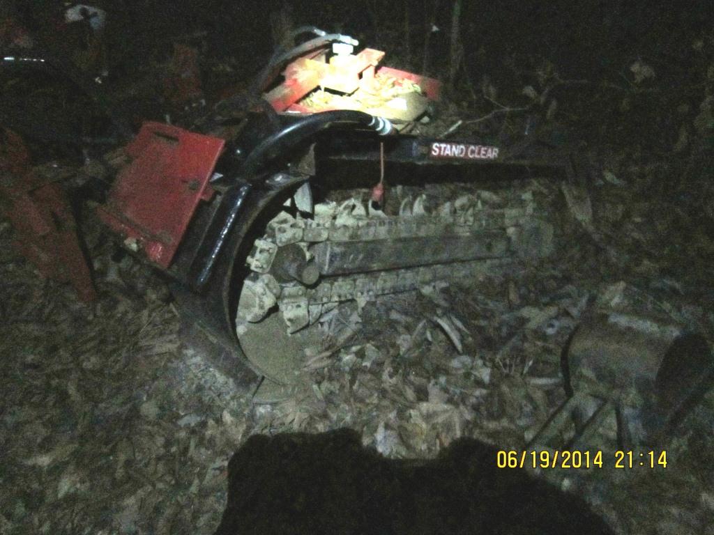

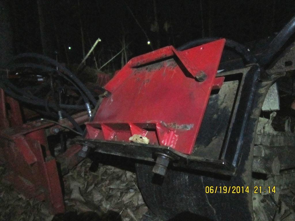

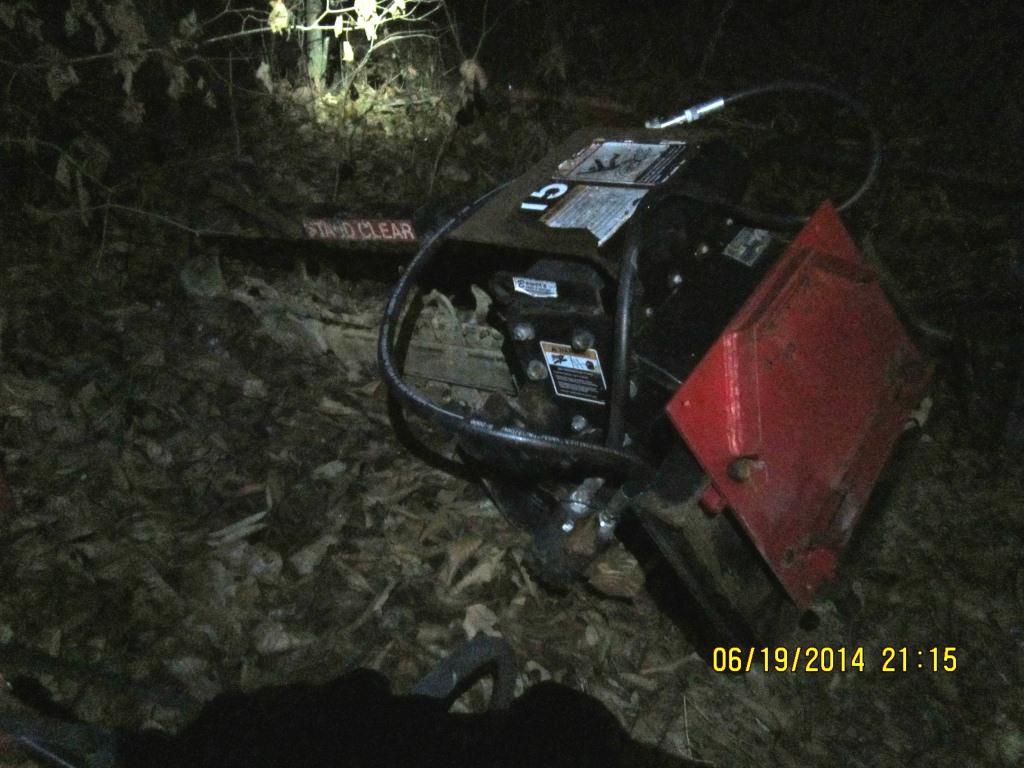

May Be This Could give some one a thought. In these pics the Nuts at the bottom are not necessary. The top piece under the plate is a long piece of angle running all the way between the two upper bolts holding the plate to the skid steer plate. One side of the angle is shaved off.
