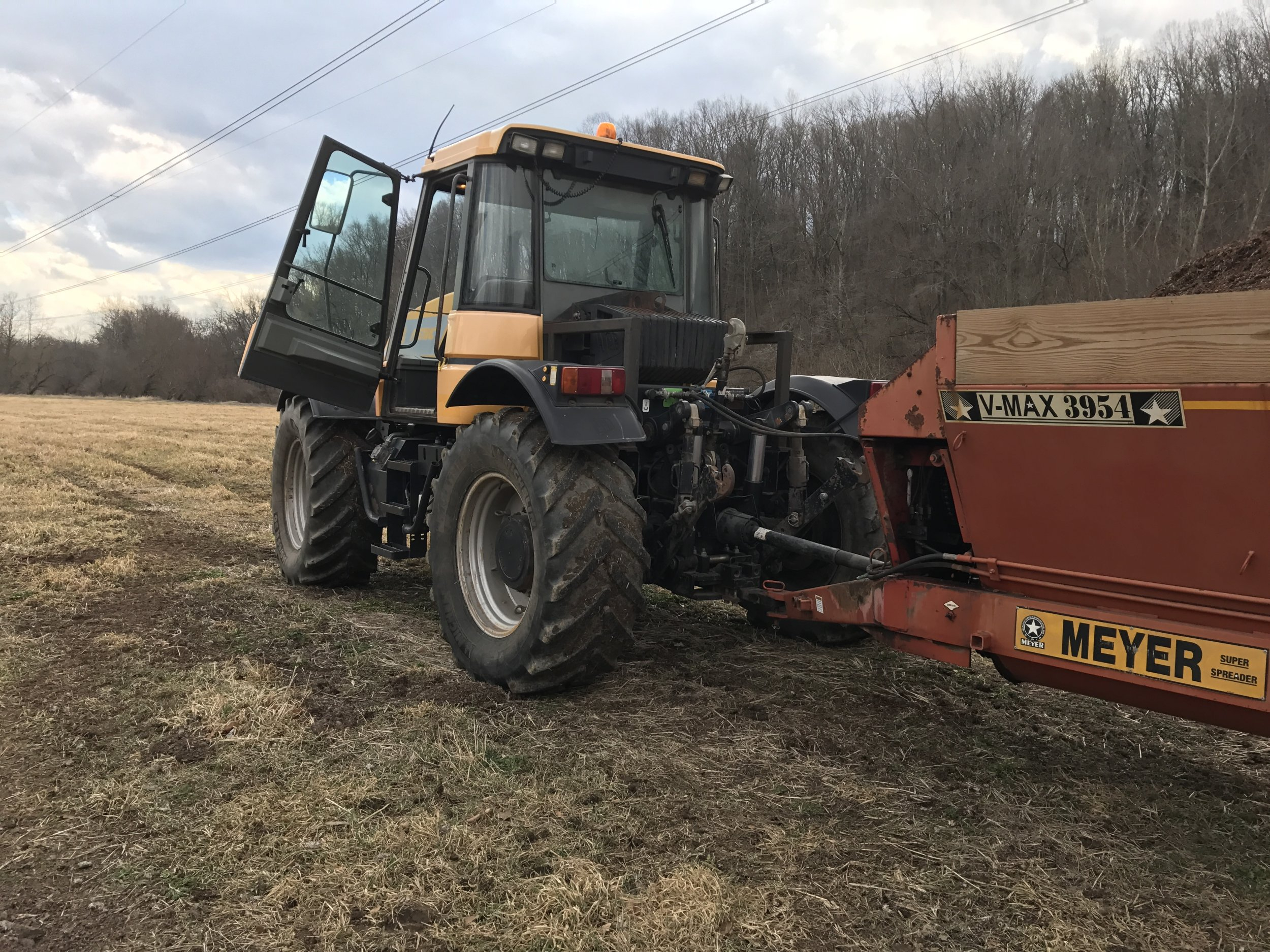

Yokes, I don’t like single axle tractors. They get stuck on wet grass.
My 5500 has 4WD, so I can get out of those situations (most of the time) and it fits in my garage at the end of a hard work day. It’s also very comfortable.
I’d look at a tandem-much better traction and stability. ;)
I like the turning radius and the tire bill of a single axel. They do get stuck pretty bad. My trucks pretty much stay on the road so I can work with that compromise.
