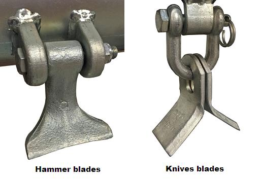

I stand corrected, but I have never seen a Y-blade (knife) that was not reversible.
I think all Y-blade knives are reversible, but there are other knives that aren’t they typically have a cutting surface that is parallel to the ground.
My Ford 917, Bushhog flail and John Deere flails all use this type of knives. However, they can use Y-blades too.
   / Why is my flail mower binding all the time? #24

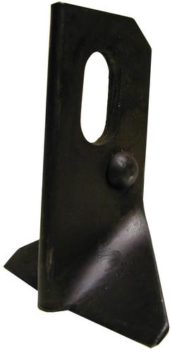

I think I see the confusion here. Hammer blades come in several different configurations but all are forged. Y-blades are stamped.
   / Why is my flail mower binding all the time? #25
   / Why is my flail mower binding all the time? #26
I'll speculate that those are patented proprietary blades. Pretty nice. Best of both worlds? A hammer type profile from a stamping. Are they expensive?
   / Why is my flail mower binding all the time? #27
Flail Master has them, but not sure on the current price, but less than ten bucks each last time I bought them.
