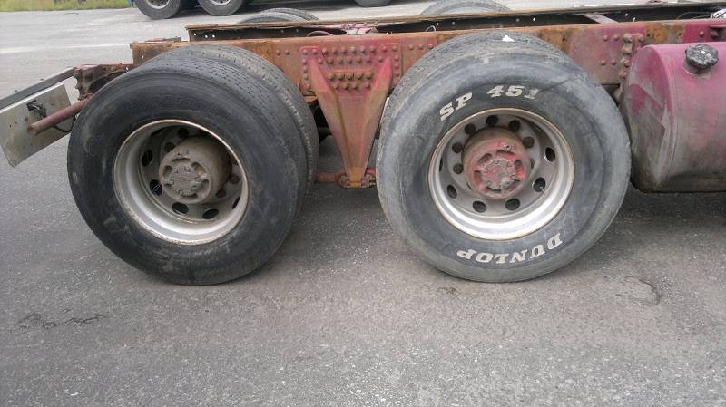

On trucks and larger equipment you usually have this solution, and then you can reduce the size of the differential.

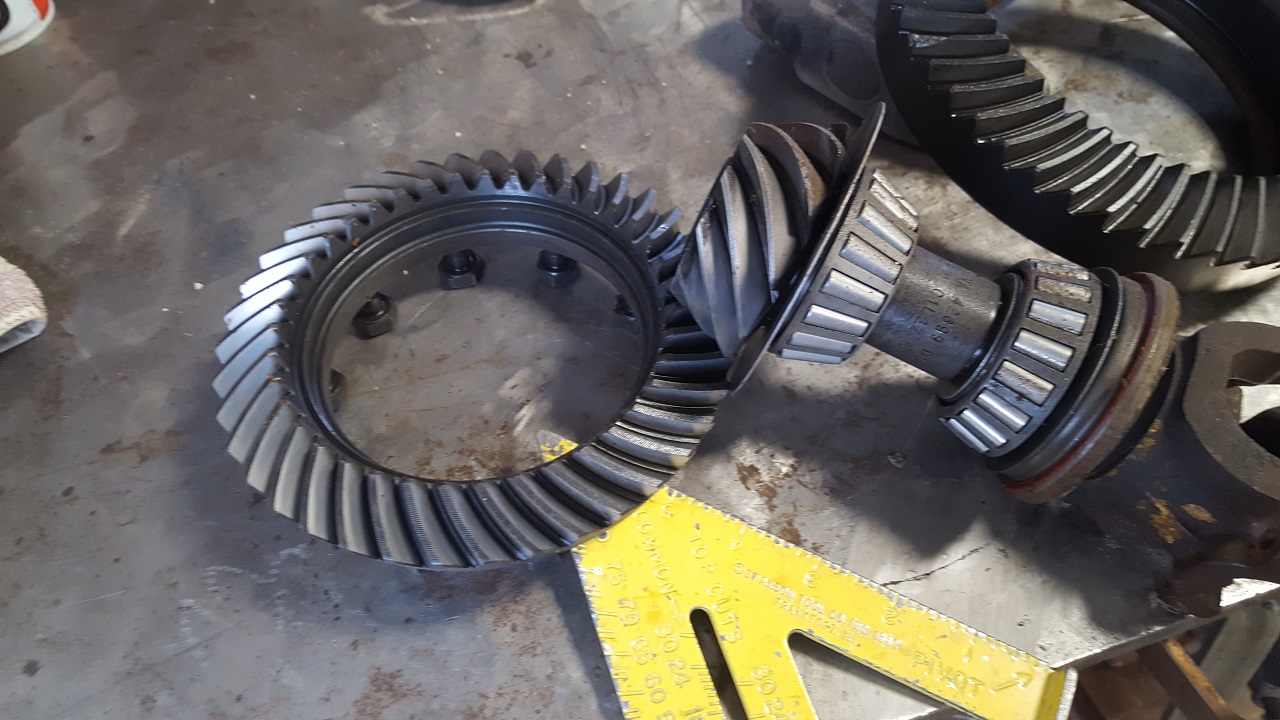

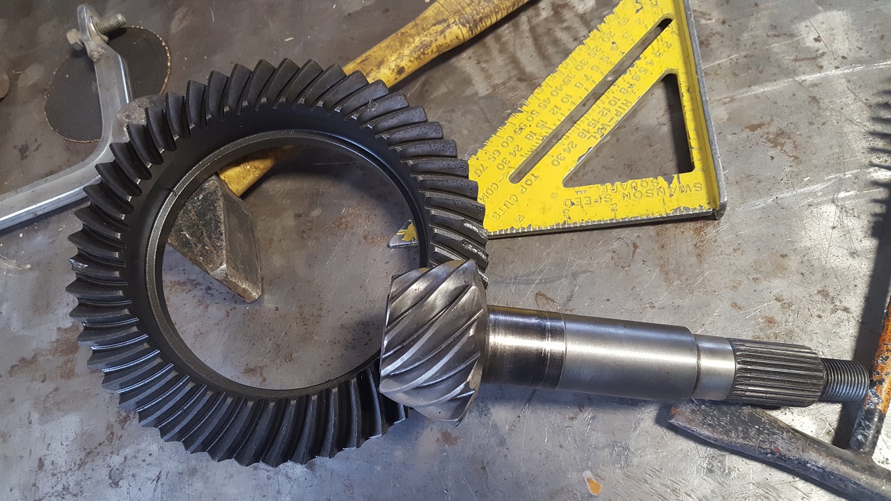

I dug around in my shop and could only come up with two ring/pinion sets. Sorry. This would have been a great thread to display 3 or 4 different sizes.
First is from a Dana 44 differential. It's a common size in 1/2T equipment and actually some autos. This set is 4.56 ratio. The larger the number, the slower the gear ratio. The larger the number, the smaller (less teeth) the pinion gear has and more teeth the ring gear has.
This set failed. They came out of one of my offroad buggies. I'll let you guys see if you can spot the failure.
I laid the T square in the pic to give an idea of size.
Second is a Dana 30 set. It's commonly found in the front axle of Jeeps and other compact trucks. This set is 3.55 ratio. Notice larger pinion count compared to ring count.
This set was replaced to get a lower ratio, slower vehicle speed, more pulling power.
Here's a comparable pic with both sets. Notice how much larger the 44 is over the 30.
My Son's run Dana 60 axles. Their ring/pinions sets are gigantic compared to these sets. Dana 60 size is what's common in 3/4T or 1T trucks.
Over the road trucks have ring/pinion sets that would make these look tiny.
Hope this helps explain the differences in strength that larger axles have. Wish I had gears from one of the vehicles you listed to show how tiny they are. :)

I see some "pieces parts" (teeth) chipped on the ring gear of that Dana 44 :)
