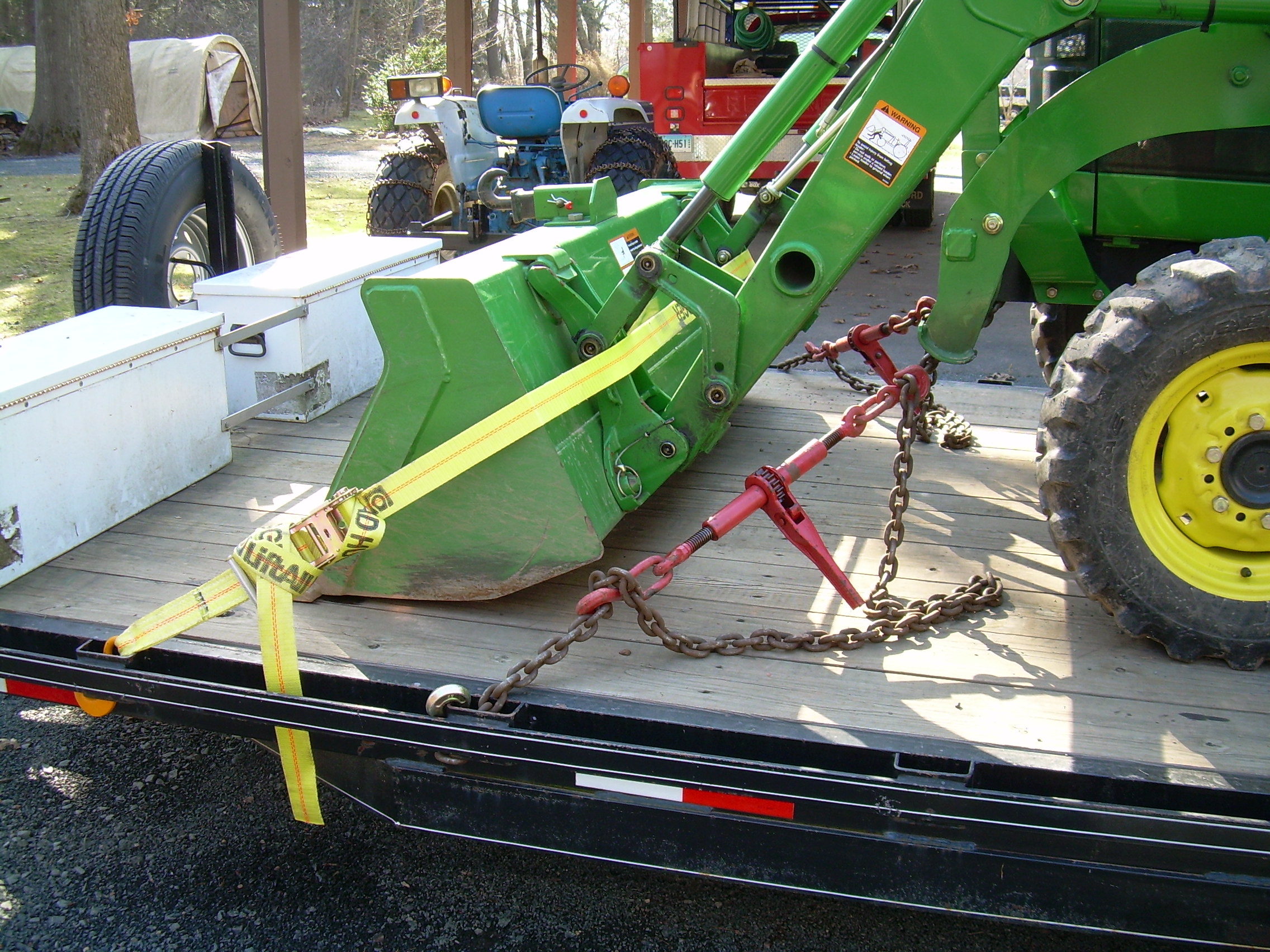

OK, with no regard to the law,
Because it's easier than doing it your way, A rated ratcheting binder is not any more a failure point than any single link in the chain.
Doing it easier puts less stress on the individual components, instead of demanding all the work out of, and pulling on just the one side, trying to square everything up. Your pulling all 4 corners down and opposing the opposite corners equally. Sucking all 4 corners down is better than just squashing down the rear and pulling on the front. You mentioned the rear tires flattening out, you probably don't see the fronts doing the same.
Not saying your way is not safe, guys have been doing it that way forever, it's just that with the 4 binders it's easier, faster and at minimum at least as safe, but probably a bit more secure.
I'm no pro here, just got my first equipment trailer a month ago but realized pretty quick that the 1 binder per corner is the way to go.
Less stress on the operator goes a long way also.
JB.

my boss said the 4 chains 4 binder law is simple, four points and all 4 tight. The four binders are overkill if the chain is tight, like you point out. overkill but the law.
seeing the pictures posted, i always try to tighten the chain as much a possible before binding, so if the binder fails the load is secure, loose but not free. does any one else do this?
/ Why four binders? #18
Are you required to tie down the attatchments also FEL and BH ??
That's the way I understand it from all I've been learning about this subject.
I'm curious about the answer to this question, the way it's done in my pics is fast and easy but I see what your getting at. I never really gave it much thought.
JB.
