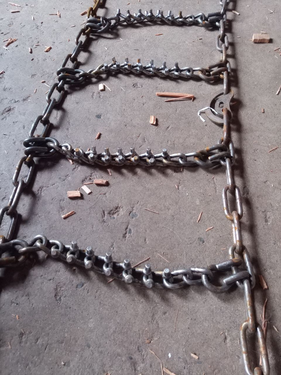

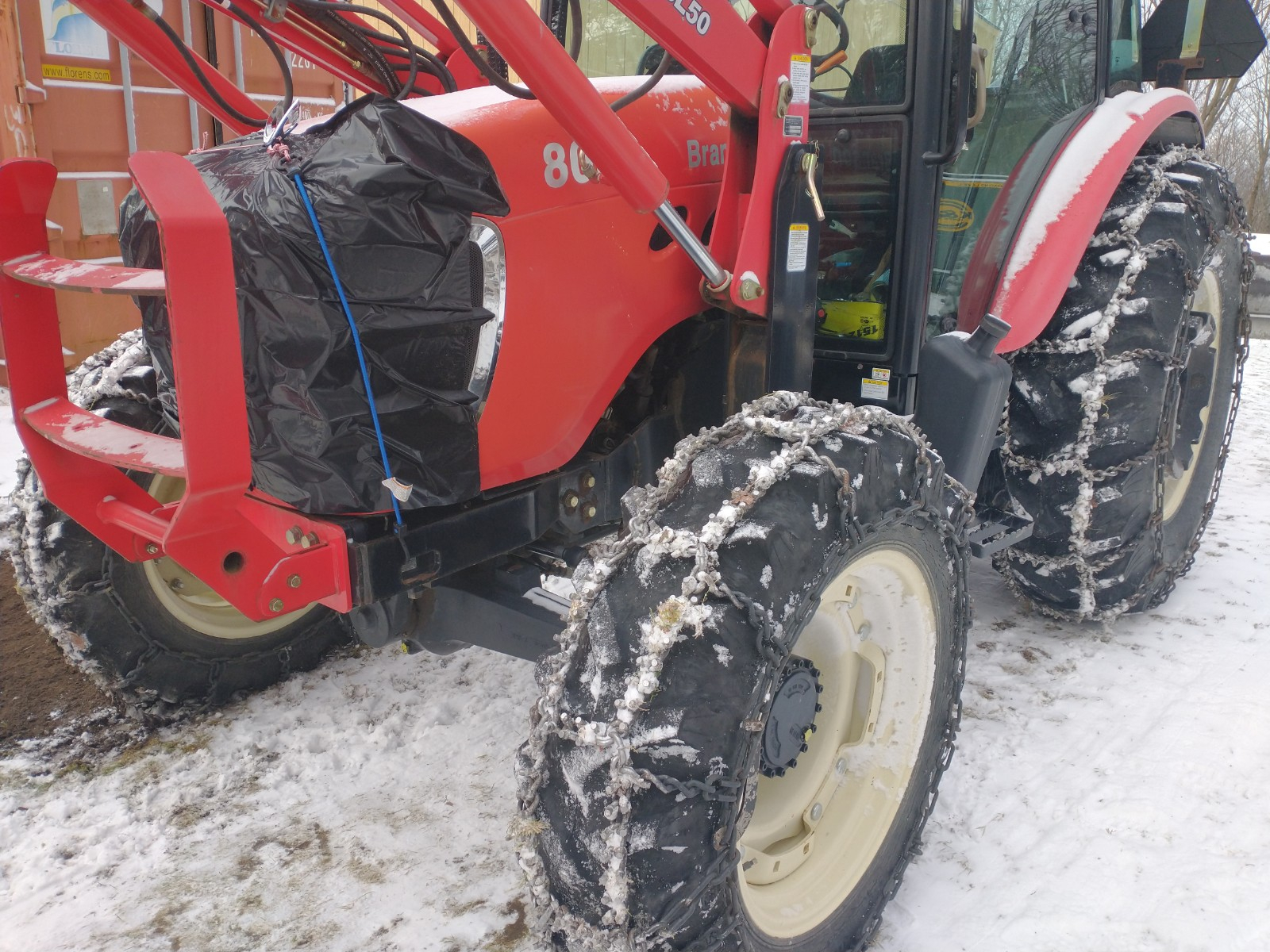

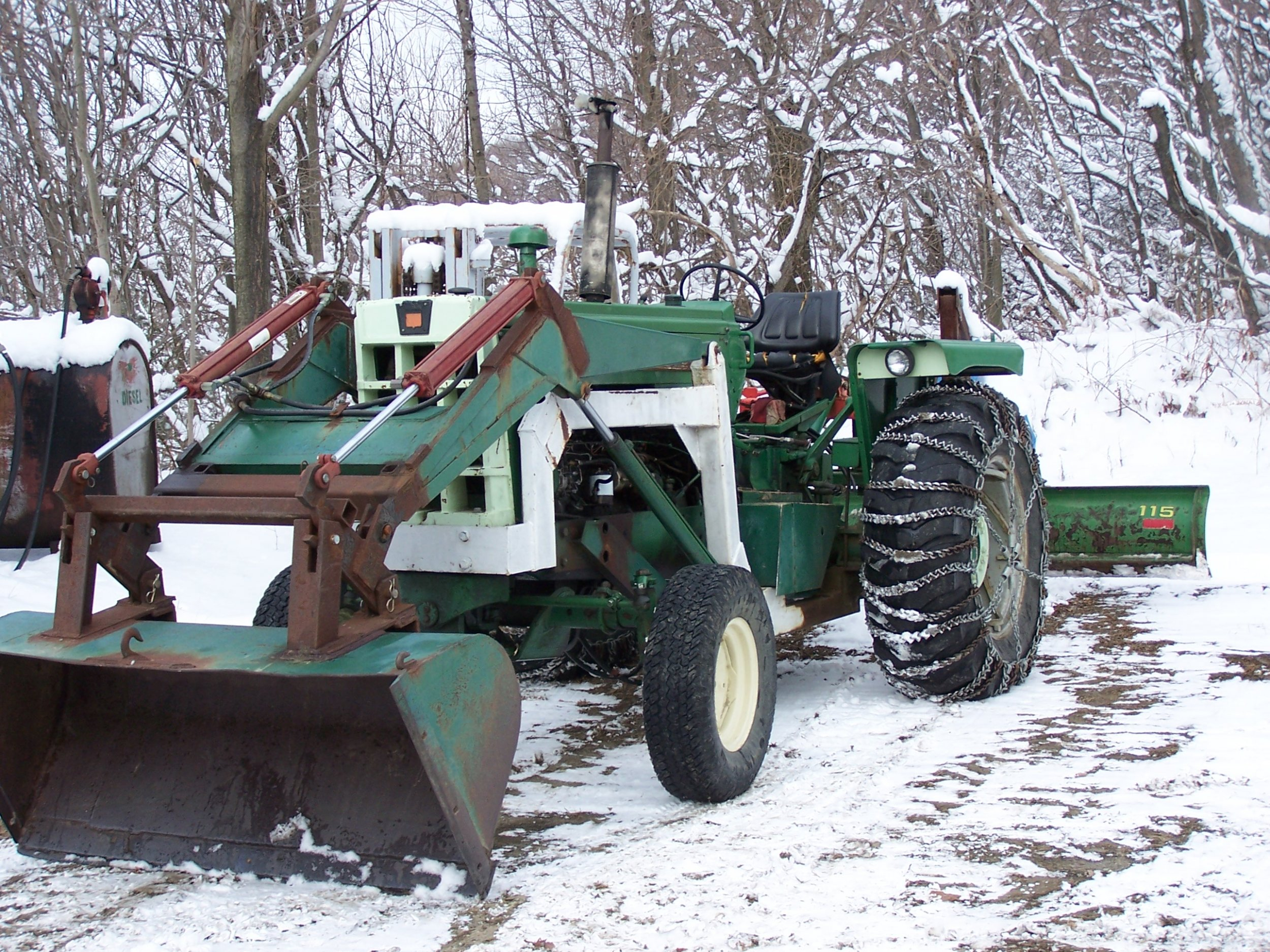

Studded chains all around on 4x4 tractor; I don't believe that they are available for pickups or trucks.
On 2 wheel drive only on the rears, these require very little clearance

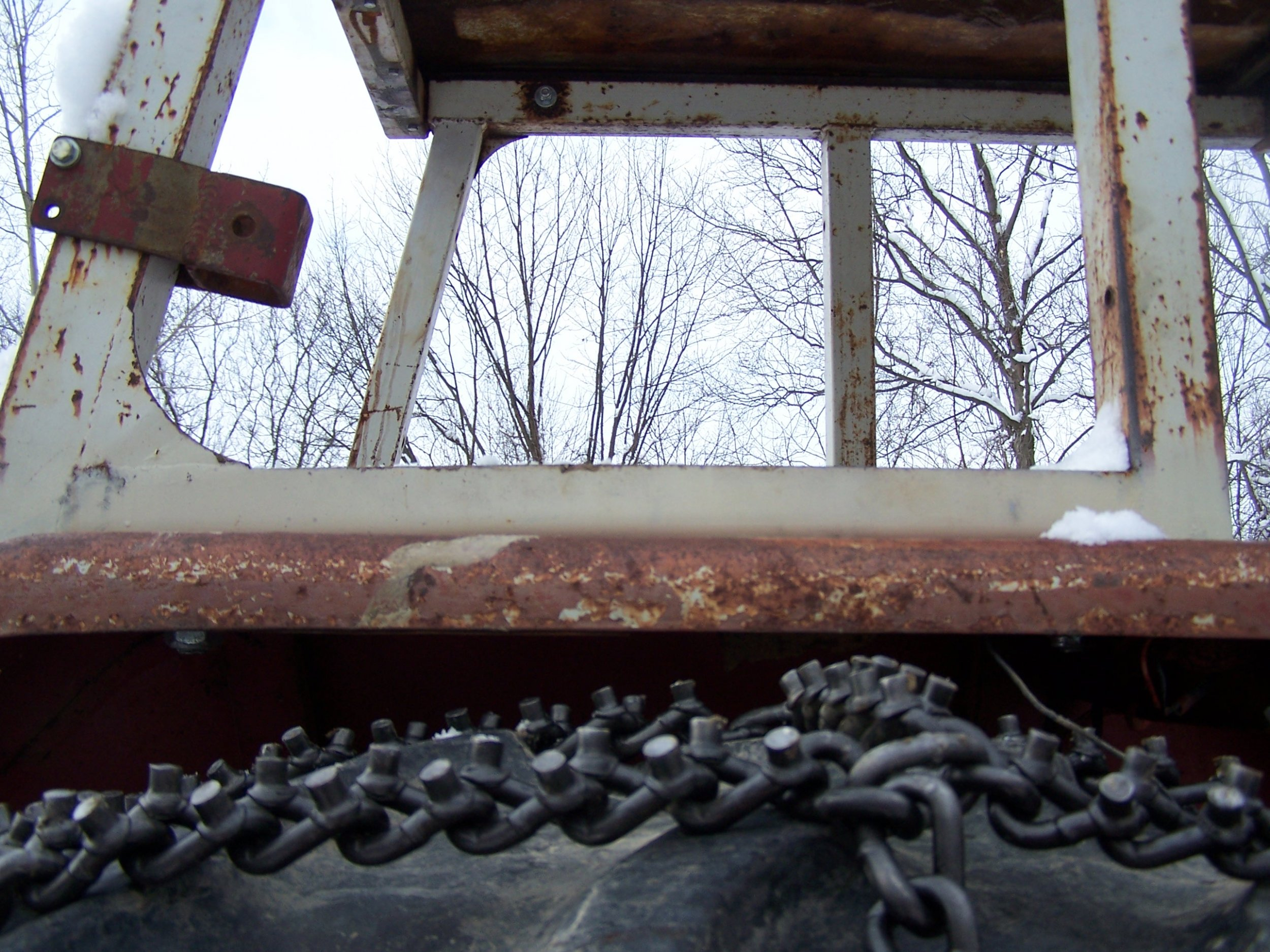

the chains pictured above have a multitude (at lest 2 - 3 times) more traction then the set below,
these chains in the lower picture are on 2 link spacing alternating twist link and v bar reinforced.

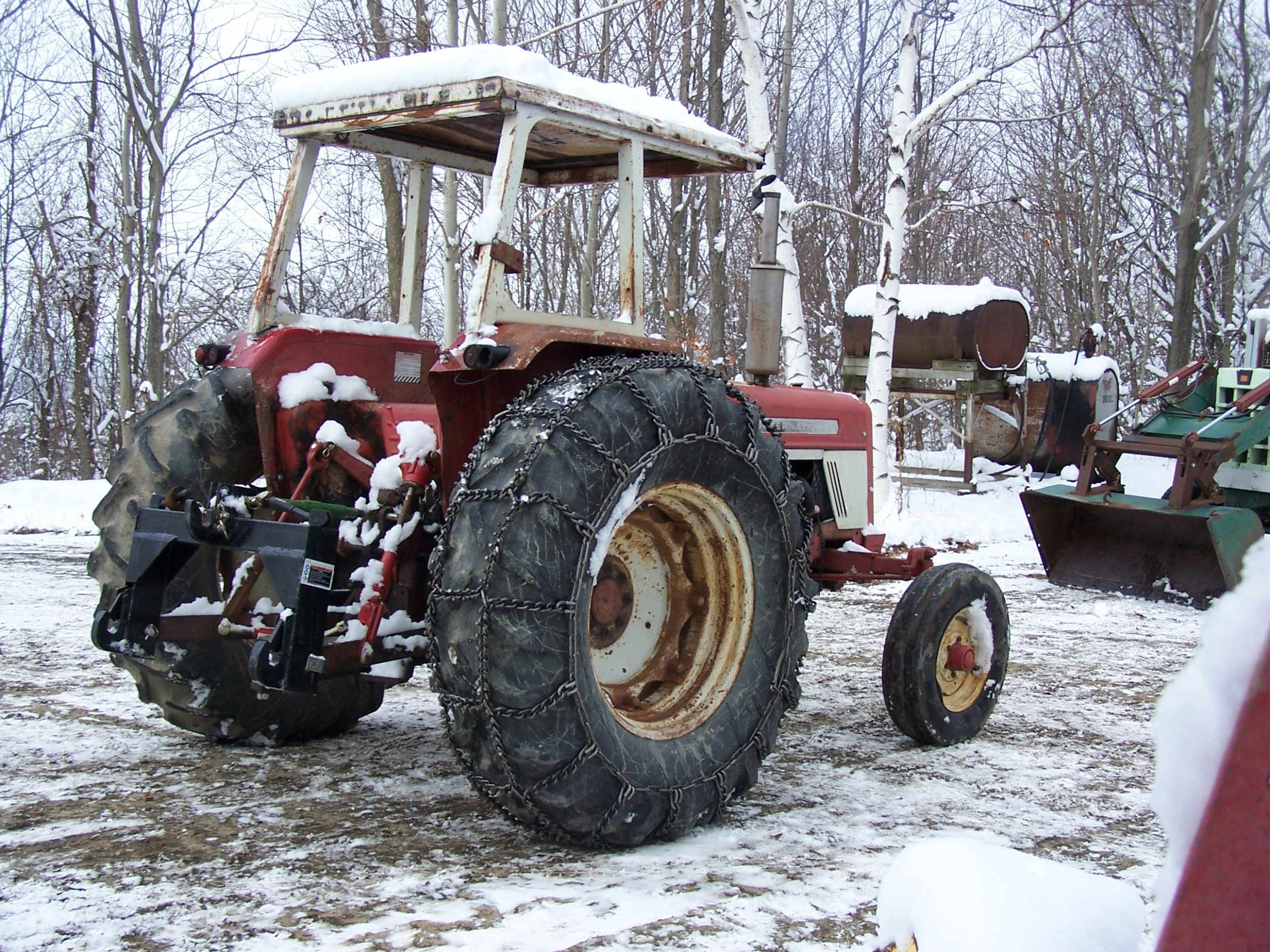

And just for the heck of it 2wd IH 656 about 6500 pounds with good chains vs. CIH 7120 a round 18,000 pounds on radials,
on ice

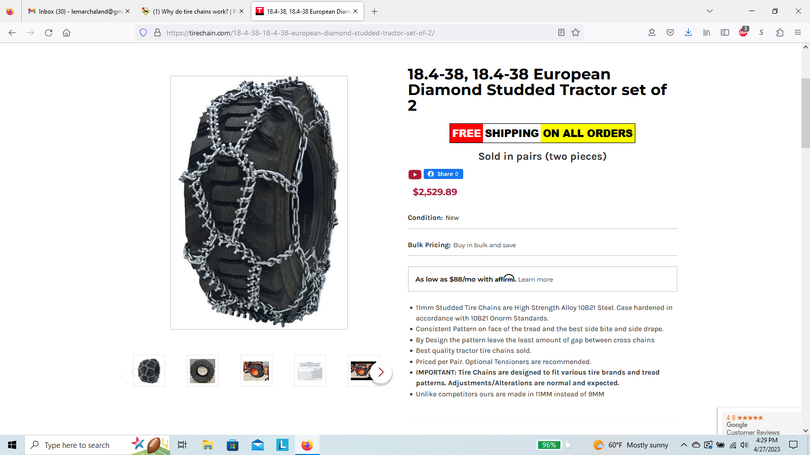

I have run the gamete of smooth twisted 4 link, to V bar reinforced 4 link, to combining those into one set, even a full set of double ring chains (they were awful) those were on 14.9-28 tires.
Then I had a set of square twisted links for the same size tires on two link spacing for 18.4-30 tires then I got my first set of the studded Euro patterned chains, that was an amazing wake up they are 10X's better then any other chains I have used on tractors.
Now I need to get another set for this coming winter for the 18.4-38's and 14.9-28's I had given my old 14.9-28 to the farm for there front tires. These are going to hurt the wallet.
then about $2000-$2200 for the 16.9-28's
But these chains have so much more grip then any conventioal type tire chain that on my driveway and our field roads with a load behind and pushing they are worth it. Been more then once I've had to upshift and speed up going down hill to maintain some control.
