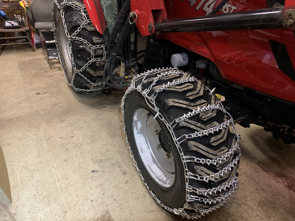

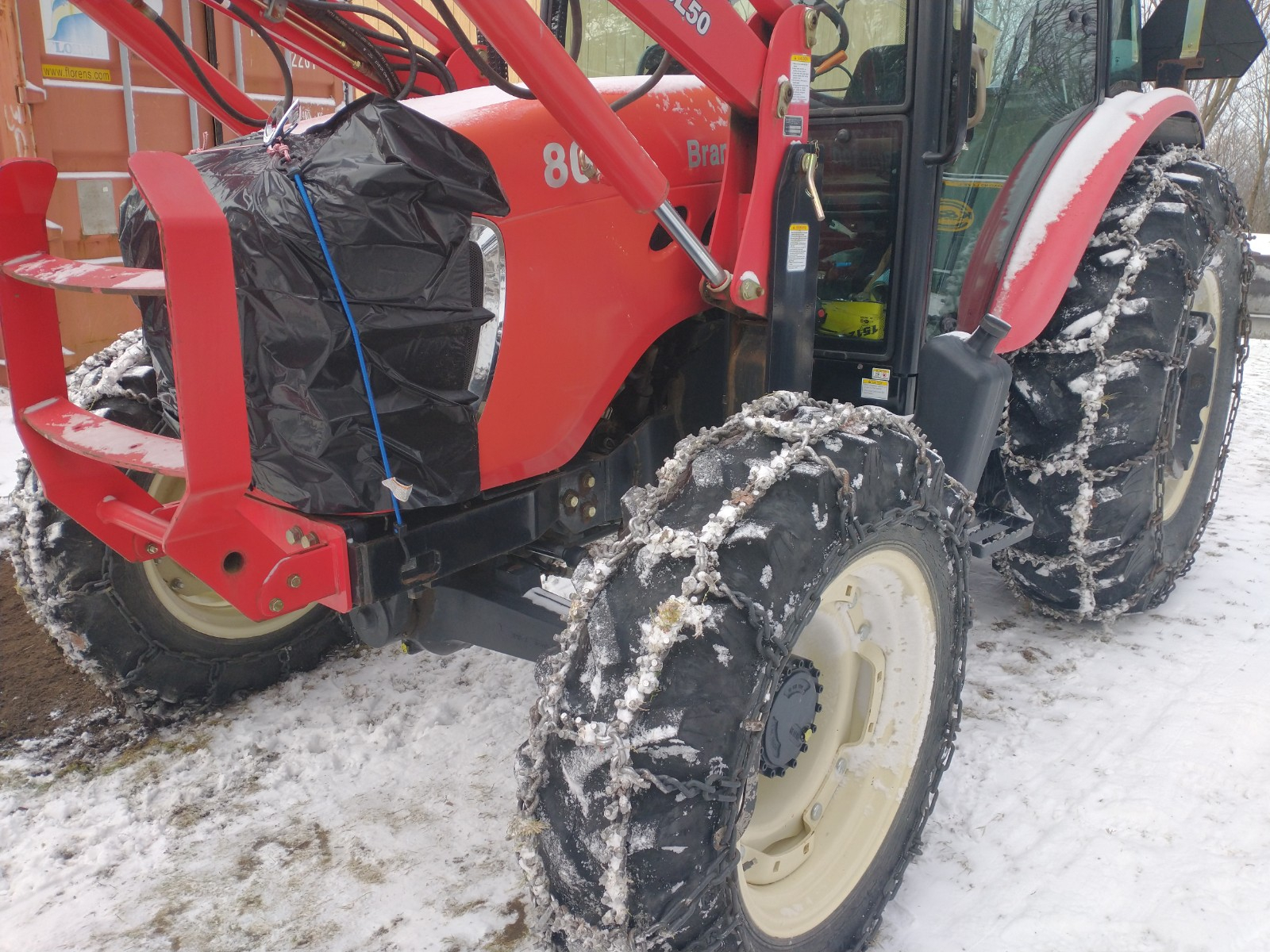

Studded chains all around on 4x4 tractor; I don't believe that they are available for pickups or trucks.
On 2 wheel drive only on the rears, these require very little clearance

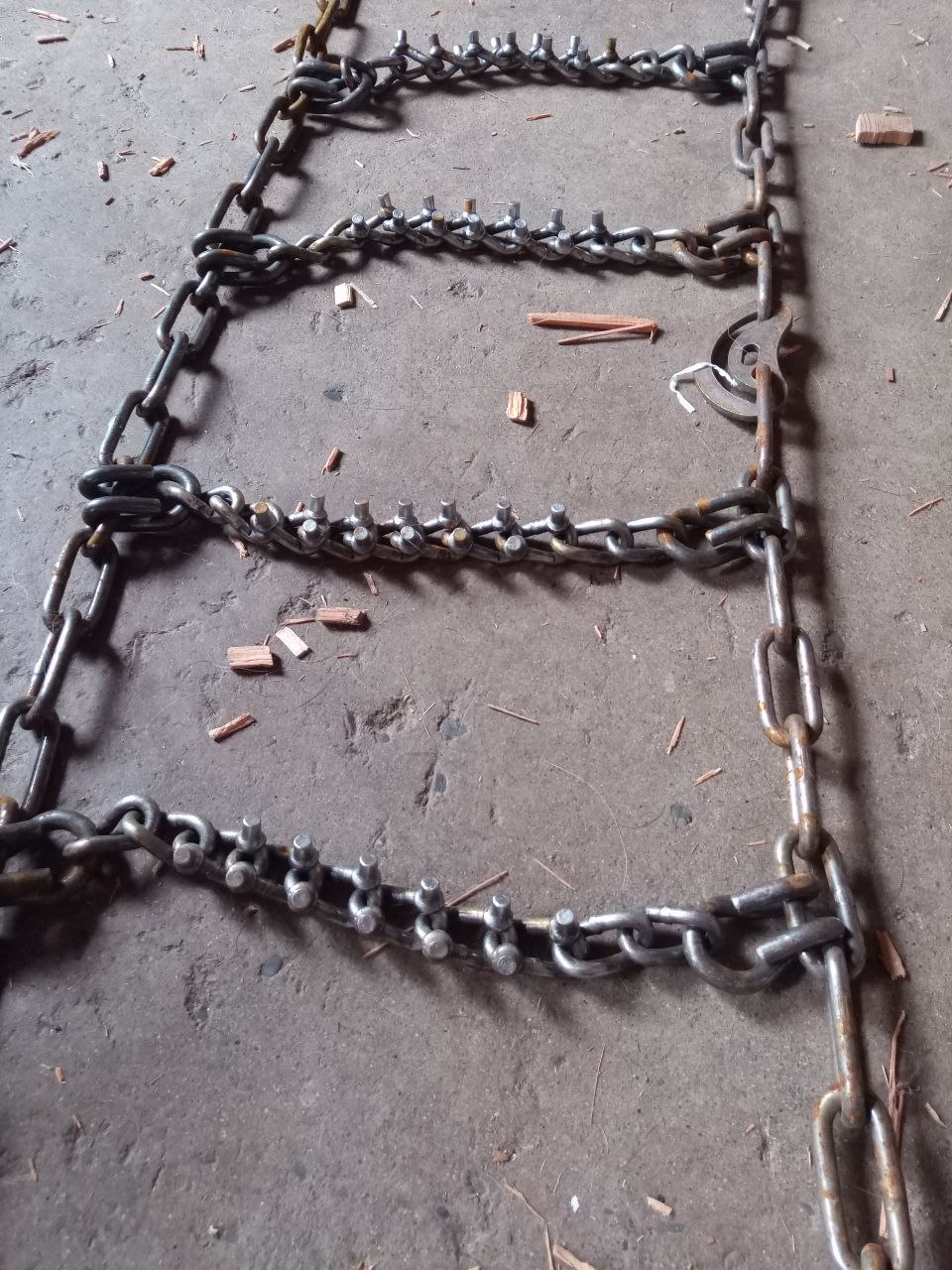

the chains pictured above have a multitude (at lest 2 - 3 times) more traction then the set below,
these chains in the lower picture are on 2 link spacing alternating twist link and v bar reinforced.

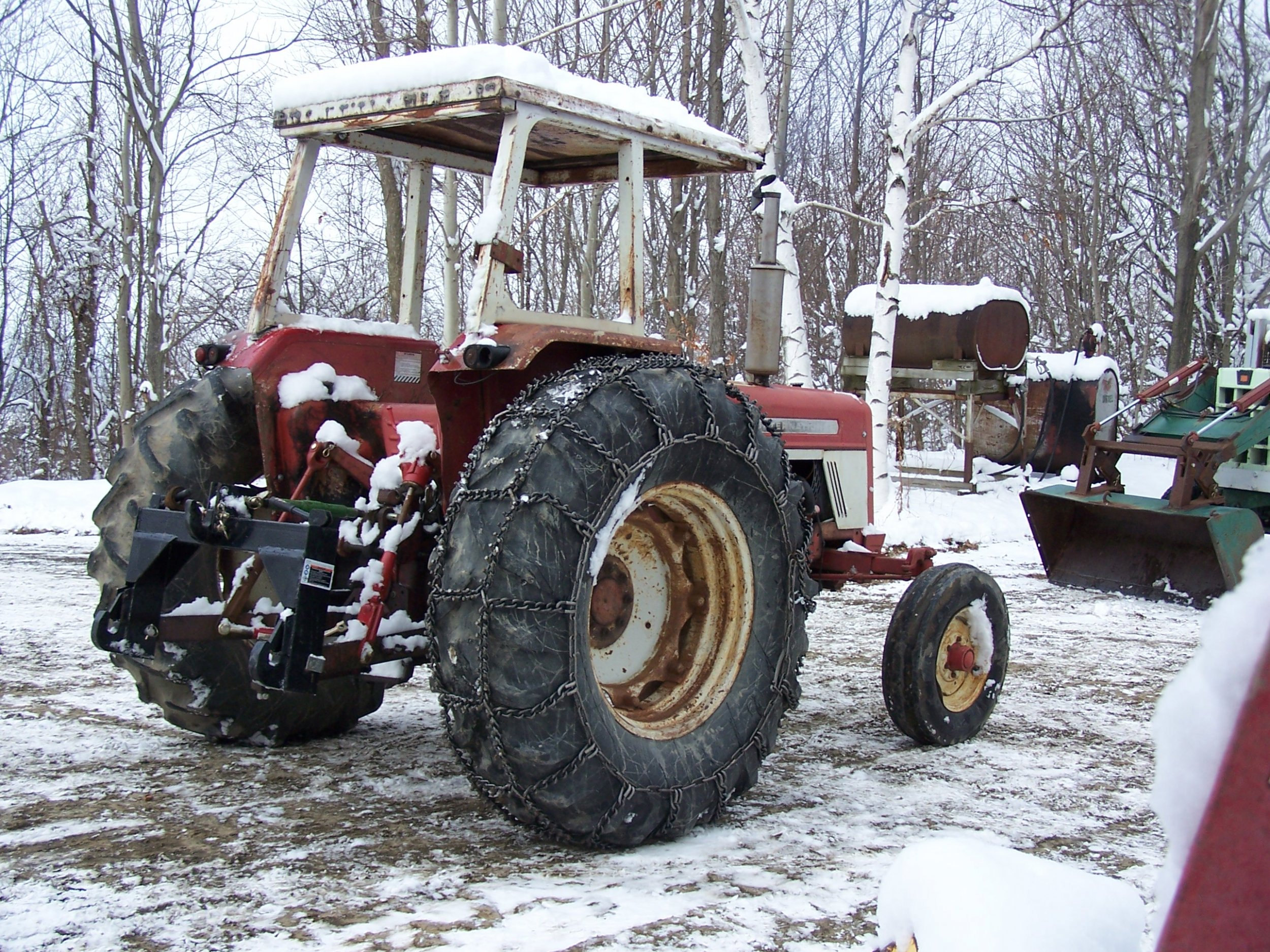

And just for the heck of it 2wd IH 656 about 6500 pounds with good chains vs. CIH 7120 a round 18,000 pounds on radials,
on ice

A smooth chain is better than no chain. V Bar chains really do good on ice. On vehicle tires they usually have cross chains every fourth link of side chains. You can get more cross links and put a cross every two side chain links. You may can buy them that way. I have several sets but have never bought new ones. Only at yard sales, pawn shops, thrift stores. I even have two special pliers that work on tire chains. They open and close the side chain hooks, handy dandy. Every once in a while I need them. So I collect rubber straps and keep my fixing kit all together so I'm ready to roll. I have two old extra chains that I use for parts to keep the other ones going. Two different chains from different places. One missing a side chain the other looks like someone was spinning and tore it off. But both of them cost less than one cross chain and two side hooks, and I have 22 cross chains and 44 side hooks out of them two old chains. I go around when ice and snow is here and pull people out. Nobody is prepared. We don't have any plows in the area. So a wintry blaster can shut this place down.

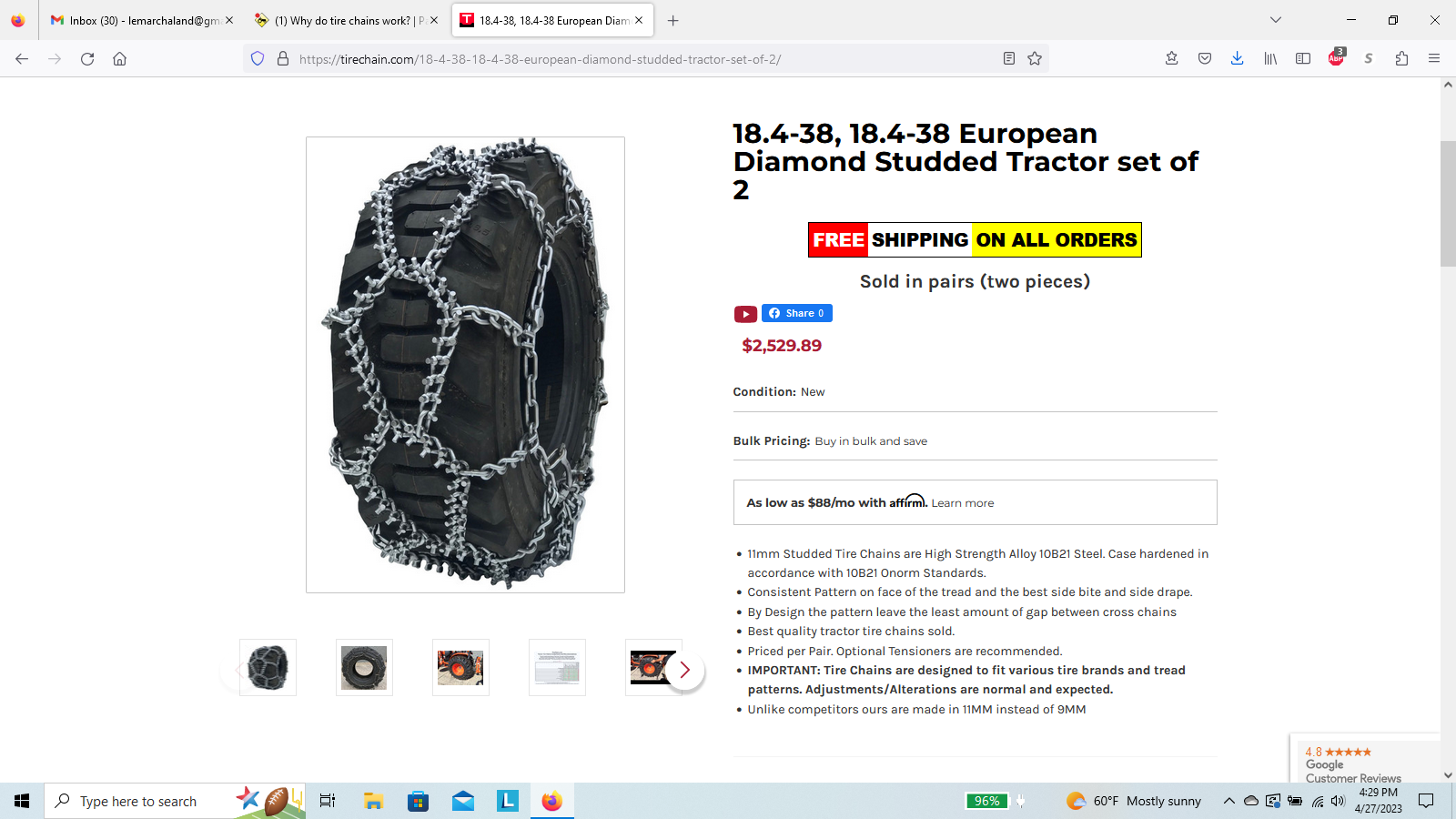

Now I need to get another set for this coming winter for the 18.4-38's and 14.9-28's I had given my old 14.9-28 to the farm for there front tires. These are going to hurt the wallet.
then about $2000-$2200 for the 16.9-28's
But these chains have so much more grip then any conventioal type tire chain that on my driveway and our field roads with a load behind and pushing they are worth it. Been more then once I've had to upshift and speed up going down hill to maintain some control.

Yeah, but you live up there in the harsh winter areas. I was going to mention those type chains, look like a chain net you put around your tires. I can see that those are better. I've only seen them on Russian and German videos. Didn't know the ouch price. But, on hills combined with ice, more than worth it. Do you repair them ?
