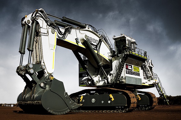

Large commercial equipment seems to usually have the cylinder base closest to the valves. Less exposed lines and hoses that way. Lines and hoses farther away from something to snag them.
But you can always find exceptions:

That's why I said usually, that is a beast of a machine.
