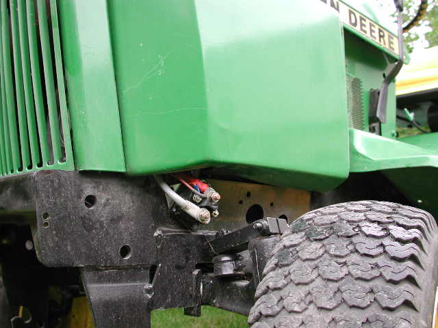

I didn't replace the starter. I beleive the posting said I serviced it.
What I did do was take it completley apart and cleaned it out. It was packed with debris. I meam PAAAACCCKKKEEED.
Resurfaced the commutator. Greased the starter gear shaft with lithium grease and soaked the armature bushings in syn oil while all this was going on.
Took apart the solenoid plunger and cleaned it. Checked its contacts and found high resistance sooo.
I installed a ford solenoid on the frame and also replaced the starter relay. (See attached picture)
It now starts better than when it was new because the ford solenod is bigger and passing more current.
After I put the starter back together I tested it with jumper cables and didnit realize the the starter gear engages without the solenoid. The gear did a pretty quick manicure on the end of my finger. Which by the way is healing well.
About 30 minutes of this 4 hours was first aid which then slowed me down for the remainder of the task. You know when the dog bites you you feed it a little more carefully.

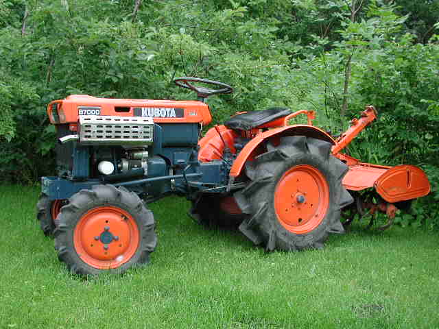

Better picture of first Bota
We bought this in 1998 the year after we purchased our property. We tilled both, side property lines and planted two rows of baby blue spruce (680 trees) down each side. The JD didn't have a tiller and you now can't buy one, which is why I bought the BX pretty welll loaded.

Re: Better picture of first Bota
Now those are some "lug tires",have you had that thing in a muddin contest somewhere?
