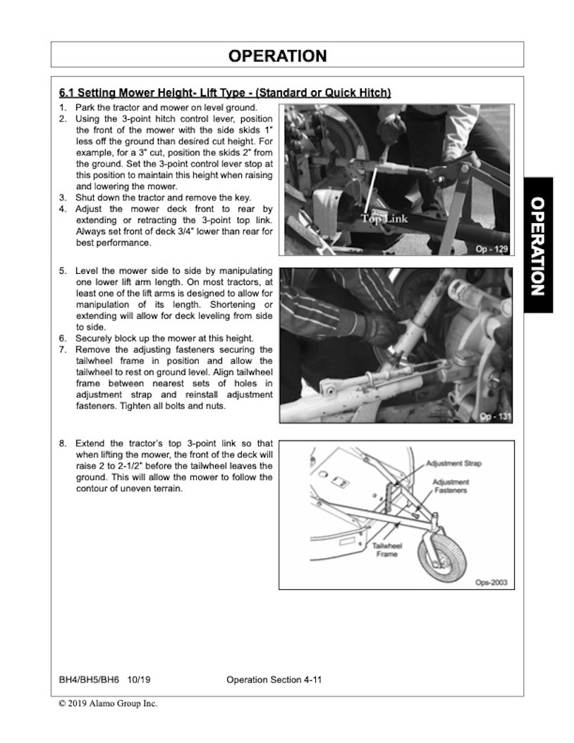

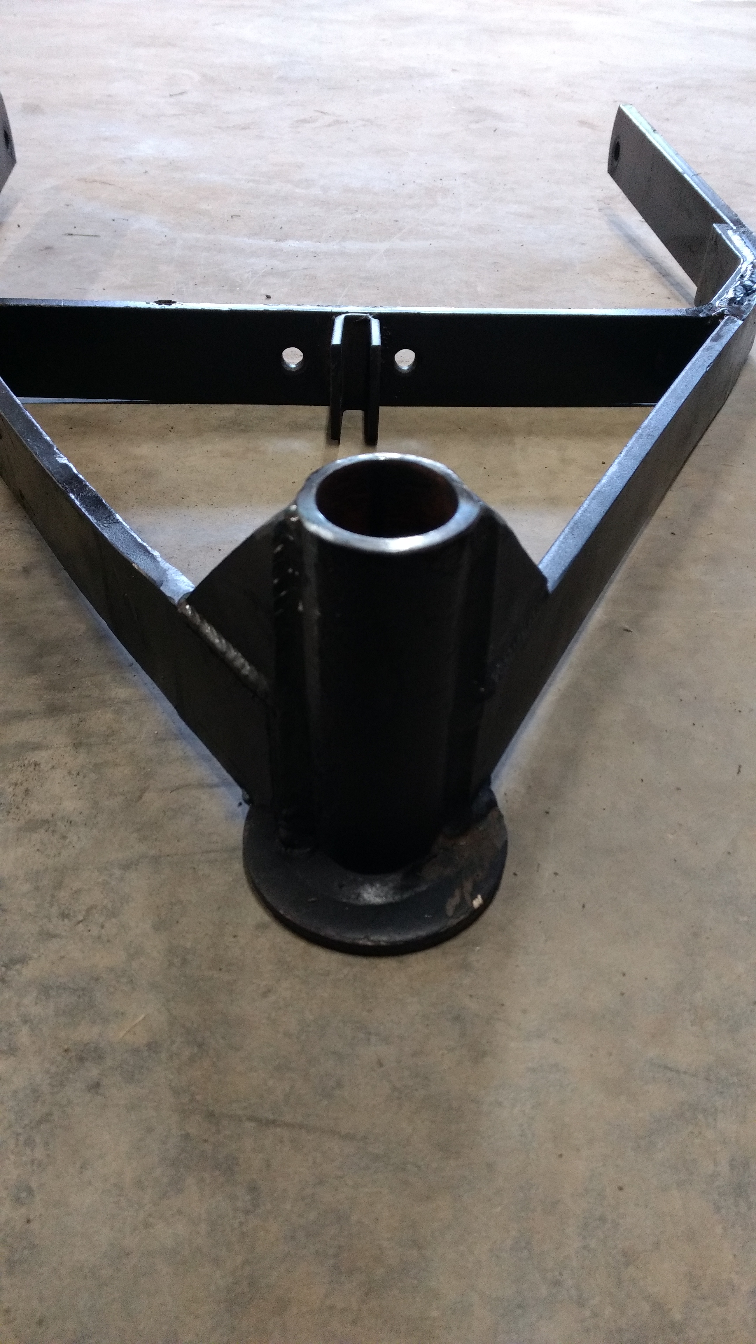

OK.....I'm doing something wrong.....way wrong.....and about to install my 3rd tail wheel fork on a 6' Bush Hog BH6 that's almost 3 yrs old. I figured the first one was due to the hydraulic top link failing, leaking down before I noticed, and i was just loading it up too much. But most of last season, I used the standard top link and this failure/damage happened after switching so that's not issue.
As far as I know, I'm not turning and smacking it into a tree, fencepost, some hard object. I have some hills, dips, ruts, and will occasionally dig a front corner into the dirt, but nothing so bad it should be loading up the tail wheel, but all I can think is a small ditch-like area I go over must do it.
I set to cut pretty short - about as high as a typical homeowner riding mower would cut at it's highest setting - 4.5" maybe?. At least i think that's short for a bush hog. On flat level ground the front of the frame (closest to PTO) is about 3" high. I adjust toplink so the back end (tailwheel end) is about 5-6" high. I think I'm doing that right - the rear slightly higher than the front. So maybe I'm overall just too low (I want about a finish mower height, but need something that can stand up to the occasional baseball-sized rock my land likes to just magically sprout). Maybe I need more of an angle and should have the back end more than just a couple inches higher? Not sure....I thought it was just supposed to be a couple inches higher to make it want to discharge rearward vs any random direction.
Anyway for standard cutting on fairly even ground the tailwheel doesn't touch the ground. Only inclines, ruts, hills, etc. I never really notice it loading up on the tailwheel, just that sometimes it does what it should and keeps the back end from dragging on uneven ground.
Your tail wheel should support that back of the mower, and the lift arms the front. On my brush mower the toplink connects to a pivoting U bracket and I keep that so it is vertical when mowing. Basically the mower should float on the front with the lift arms supporting it and allowing it to rise and fall if there is a large obstruction being run over. If I need the back lifted higher to get under it to work on the blades or if something gets tangled in it I adjust the top link to be rigid pulling the pivoting U bracket toward the tractor making a somewhat rigid connection. Put it back in the center position before mowing again. I've ruined at least a couple forks by backing up the far side of a ditch without lifting the whole mower. The far side of the ditch is too steep to allow the wheel and forks to pivot enough when backing.

... It's like the fork was smashed straight down from the top. Wheel spins freely, shaft pivots freely.

You are expecting Finishing Mower height from a Bush Hog. It should be 5-6" off level ground .
Carry most of the weight with the 3PH. Tail Wheel off the ground most times.
