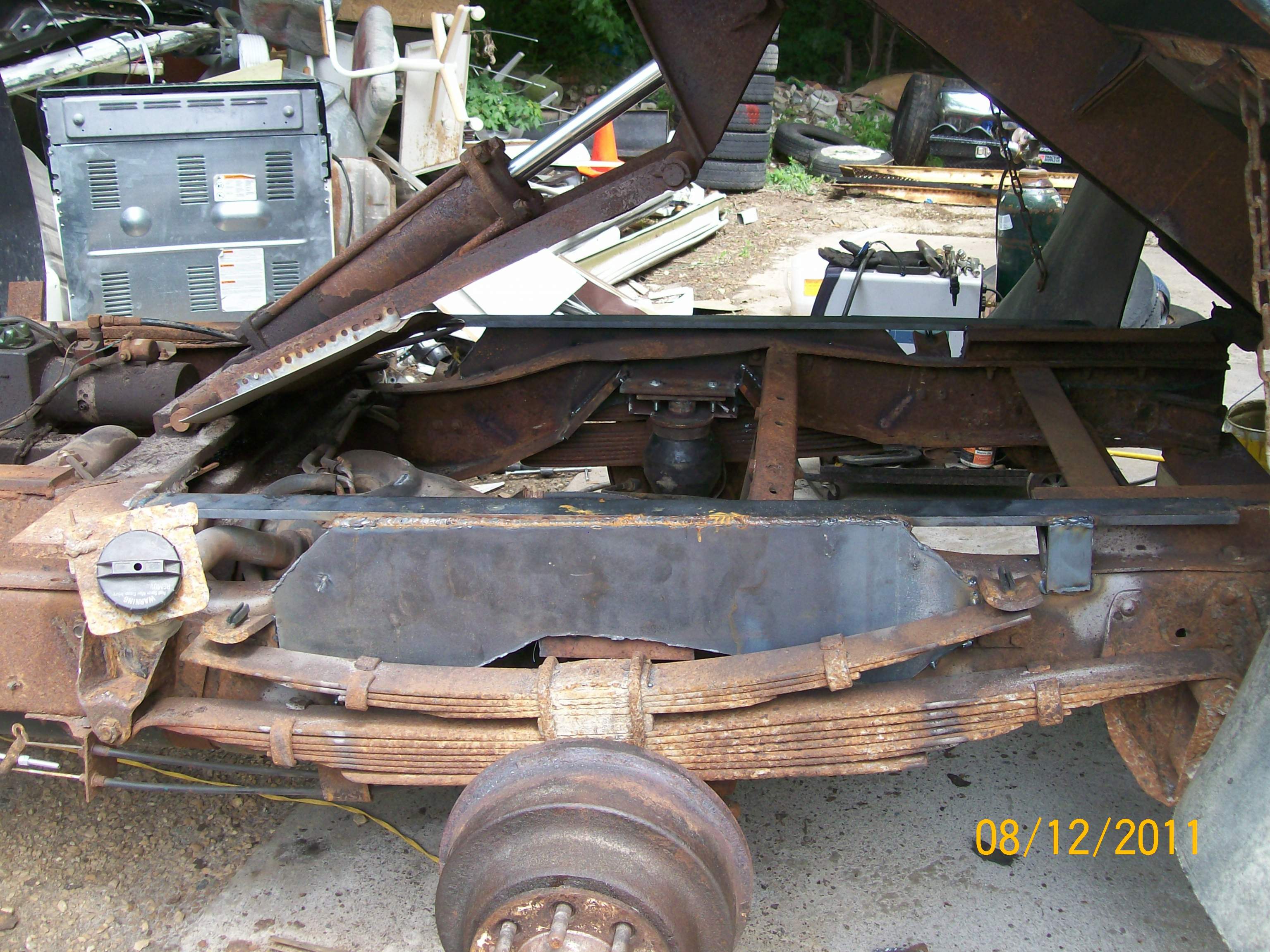

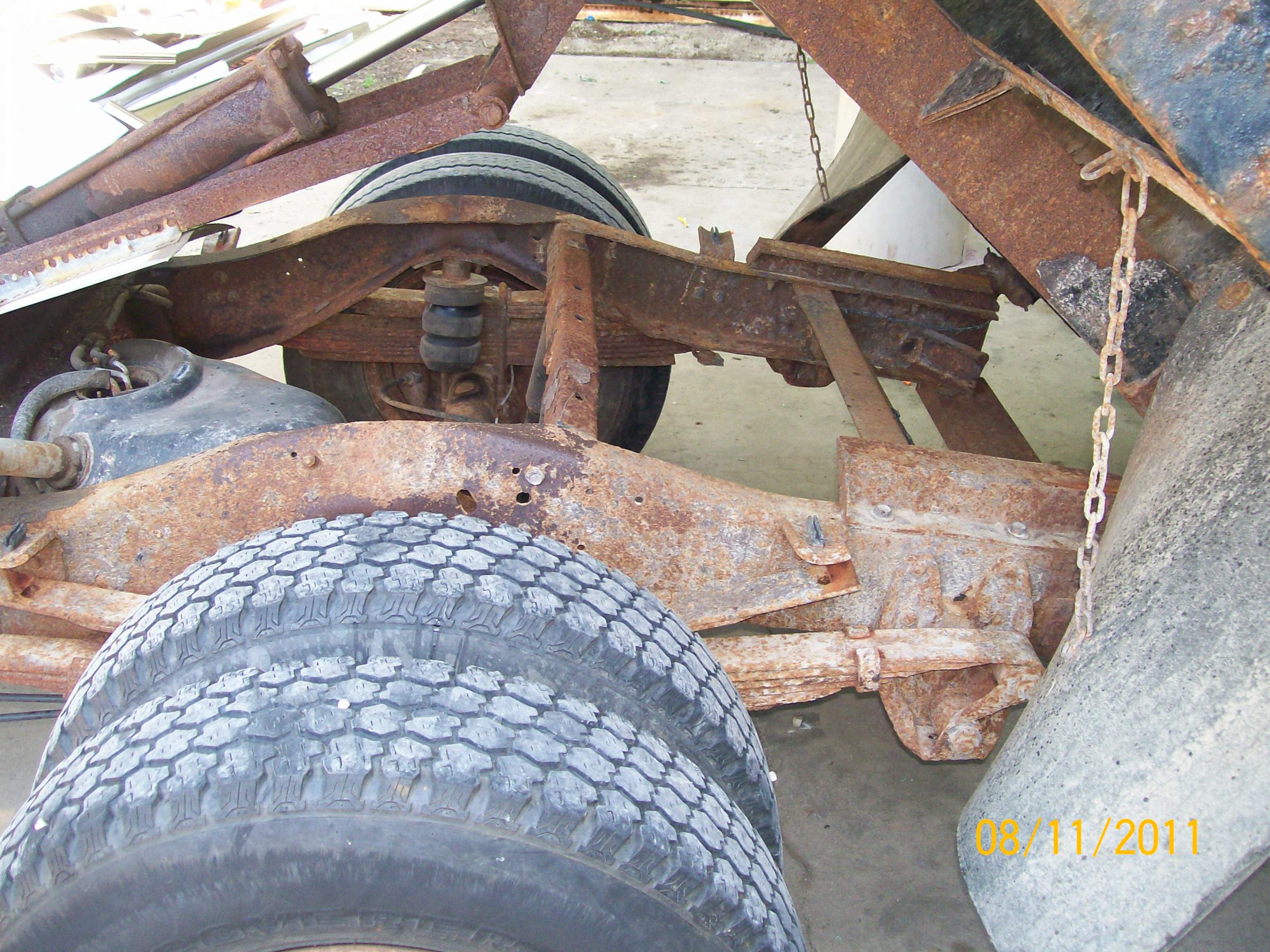

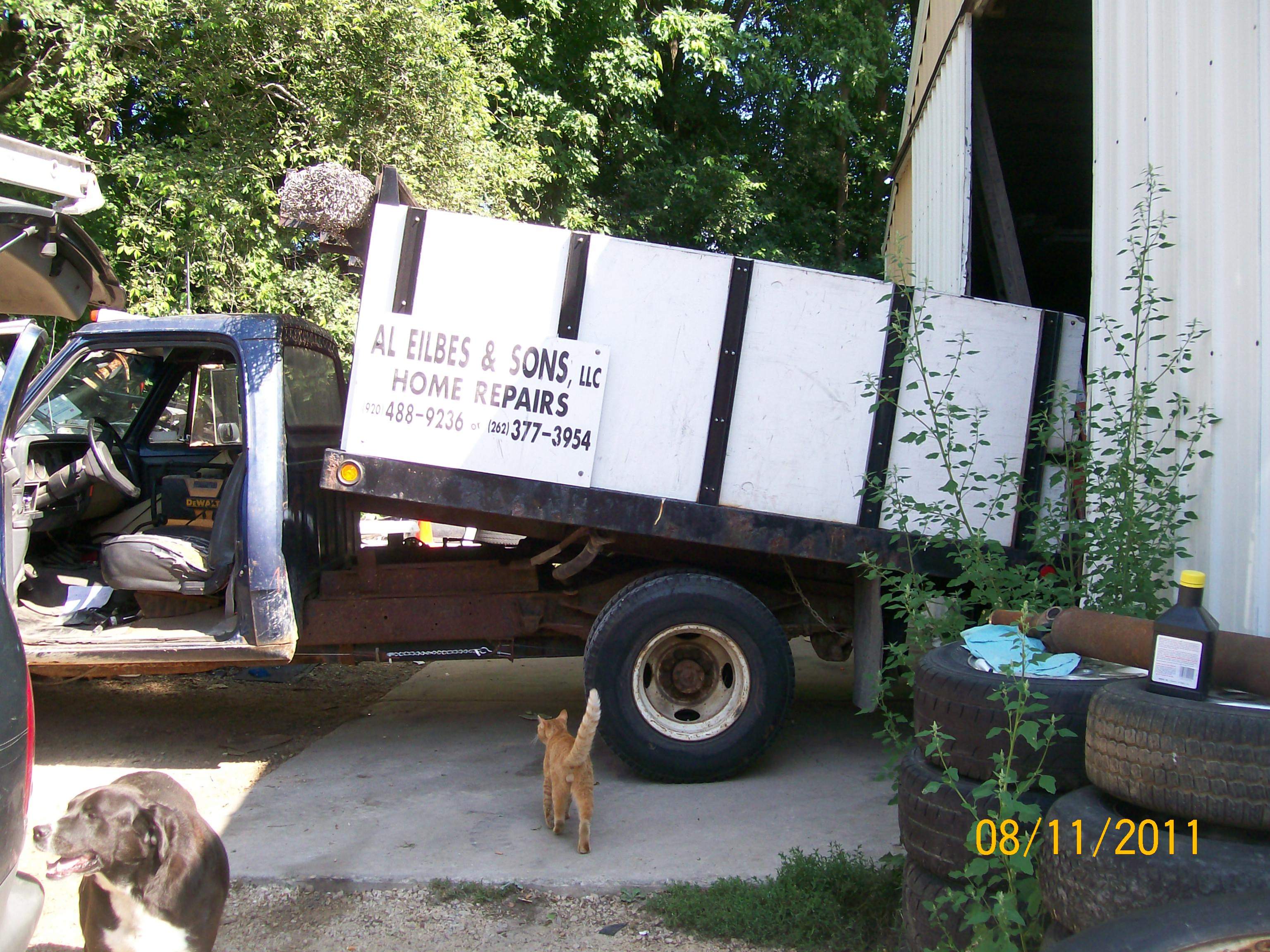

Another good reason to spend a day and a half in the shop away from everyone else.
Had a full load (4 ton) on my 84 Dodge 350 cab and chassis, load stuck in the up position. Put her in low, and popped the clutch a little, and the back of the box hit the ground. Got a few dumb looks driving home from the transfer station. 1/2inch frame plates, some 1/2 inch flat stock, and a 10 lb spool of wire later, were back in buisness.

/ Whoops! #2
Did you have to square the frame back up? I had an old chevy dump with similar issues that was out of square by 3/4 of an inch, used the excavator, some binder chain and an oak tree to square it up, good thing no one was watching!
/ Whoops!
I just used the bed of the truck, after I cut the frame, the bed went down into the frame guides when I lifted the back end up with the forklift. I then used the hoist to bounce the frame back into position, and welded the plates to the frame.

/ Whoops! #6
I take it you live in a state where they salt the roads or you drive it through the surf a lot?:laughing: Time for some rustoleum on that old gal.. Otherwise the next time the whole box will be laying out in the road.
/ Whoops! #7
That style lift is very hard on frames. When the box is down it and you go to raise it you are trying to stretch the frame apart. I've had to rebuilt the lift on my international 2 1/2 dump because over the years it put too much force trying to dump 5 yard loads of gravel. That with a 2 1/2 ton dump truck holding maybe 7 tons or so. Putting 4 tons onto a 1 ton with a dump made for a 1 ton, I'm surprised you made it this long. Put the weld to it and paint it up and keep running it. Looks good.
/ Whoops!
Truck weighs 6100 empty, and spec on doorjamb tag (when new, before rust) is 13,900. Yes, maybe a little over, but not too terribly. Have had 6 ton+ gravel on her, and she never complained before. Shes 27, in dog years, that's 189. What is it in truck years?
