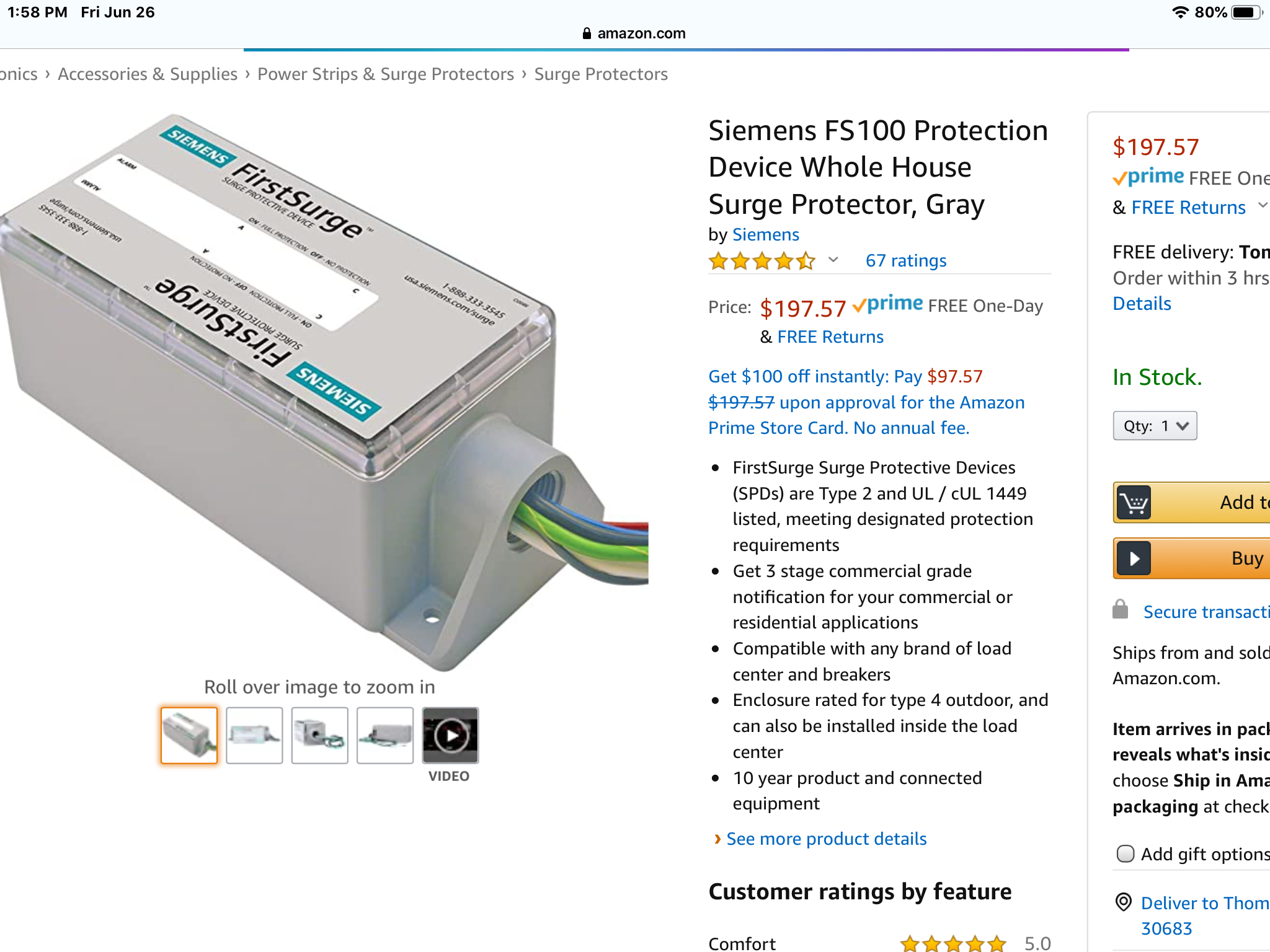

Hello fellow members,
I recently lost a second PC and some other electronics in about four years from surges or nearby lightning strikes during thunderstorms. Do any of you have knowledge or experience with the surge protectors that are supposed to protect the entire house? My power company offers a device for about $10 per month. See example below from Amazon for about $200.
I am also looking into protection for my coax cable/internet service as I believe the recent Zap came through the cable line as only the equipment hardwired to it got toasted. (cable modem, router and PC) A UPS is used on the power side but it doesn’t have coax protection.
Thanks

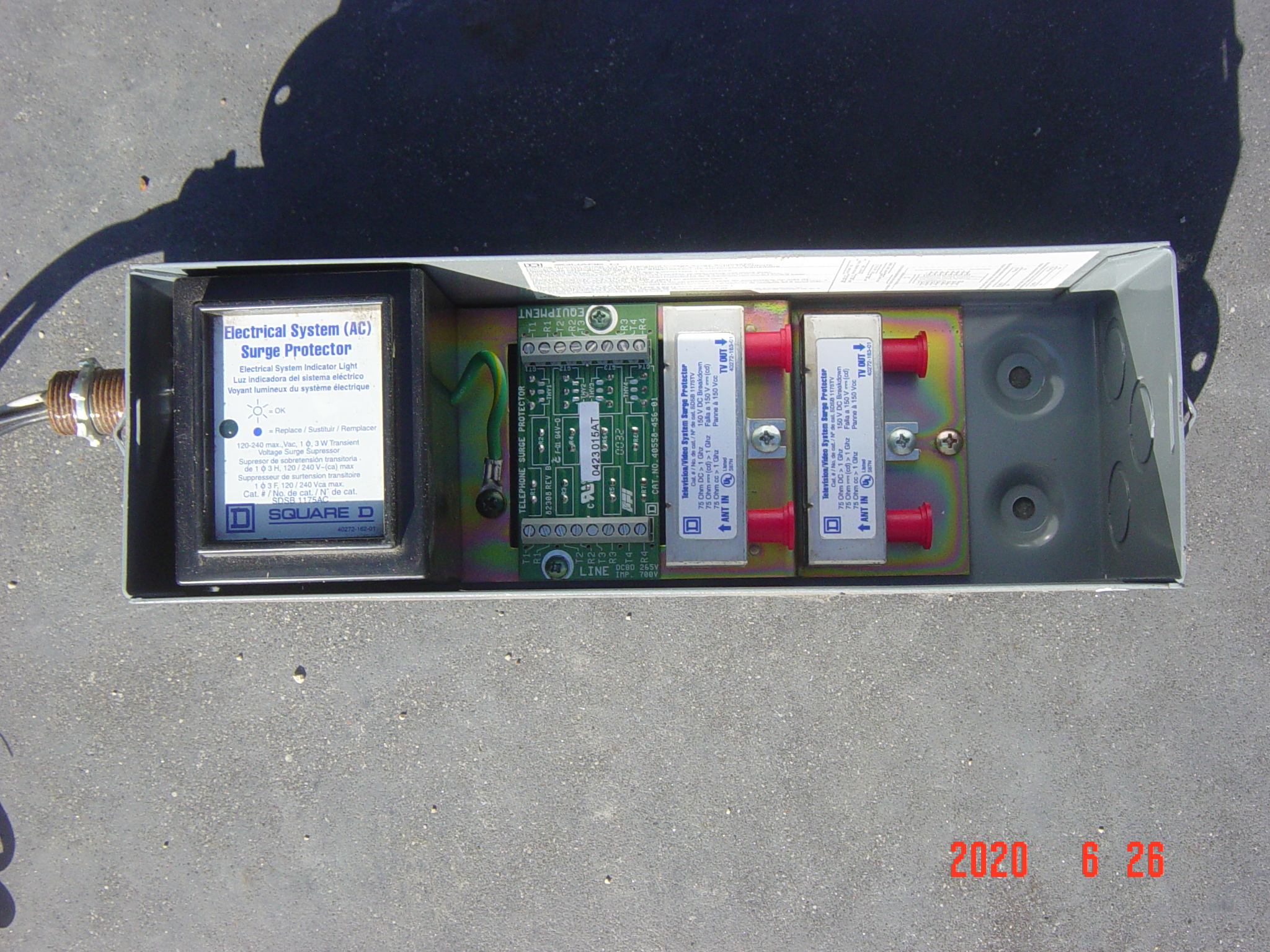

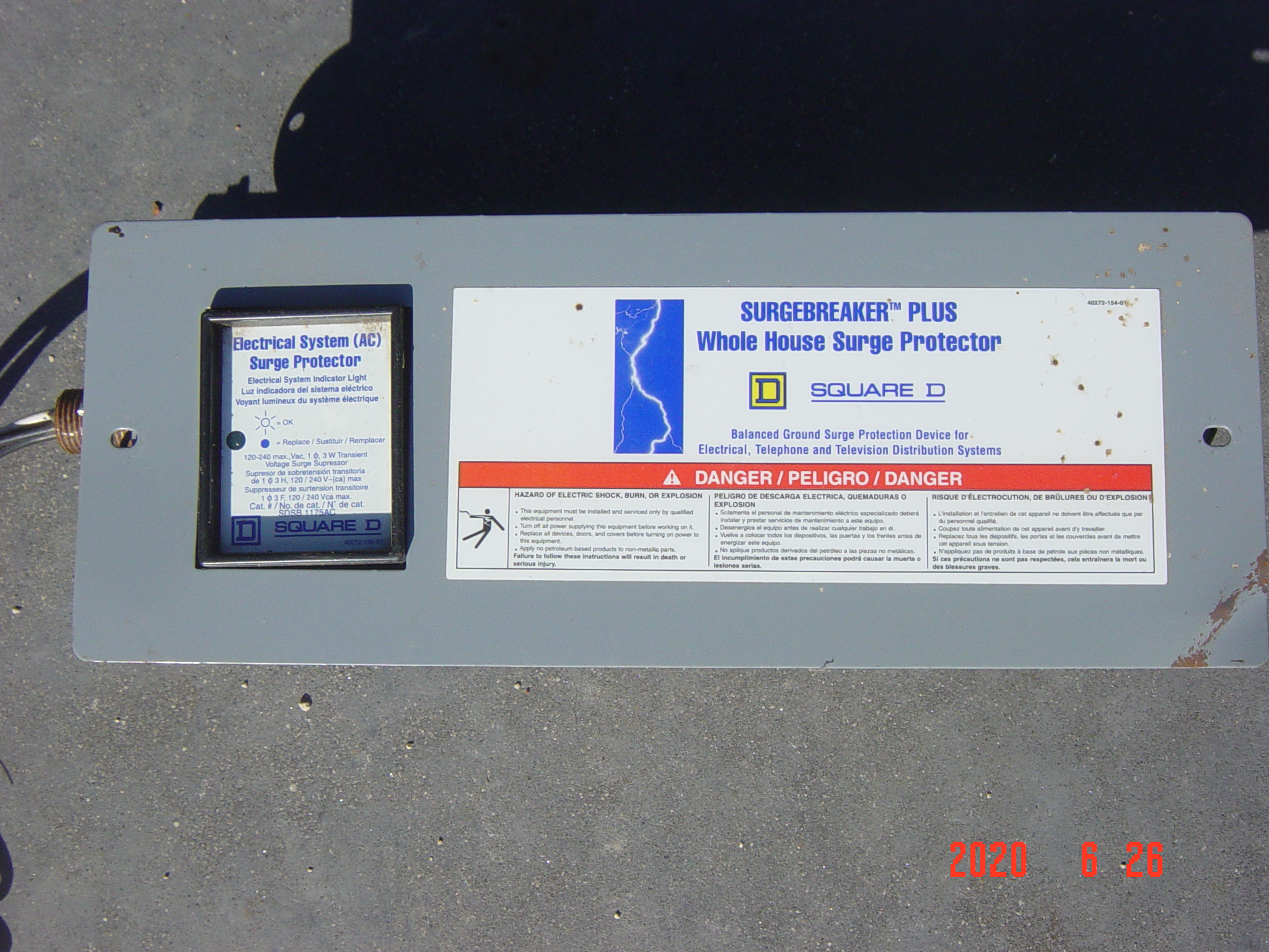

One of the ones I have is a SQUARE D or something and comes in a HUGE metal box that also has Phone and COAX protection if I recall. For a single point ground. Now I struggle for a place to mount it. Which is probably why I have not installed it. Small is good! As long as it's a quality item.

I have a Siemens FS140 on my shop and one on the house. Each is a 200 amp feed off of a 400 amp service. Ive sold and installed many of the Siemens FS140痴 over-the years. There is also a flush mount kit available if your panel is in a drywall壇 environment.
funny thing is Amazons crazy pricing has the fs140 cheaper than the fs100 and its a far better unit.
