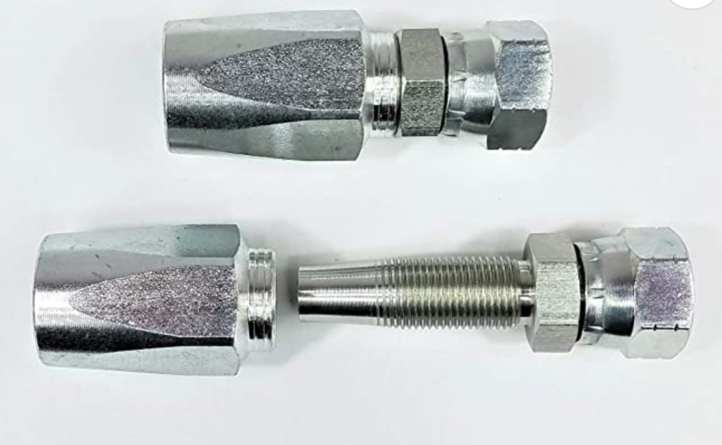

You don’t need a machine if you buy reusable hose ends and you also don’t have to buy more fittings when the hose is done, just replace the hose, using the same fittings.
It’s not completely unheard of for a hose to fail right before the fitting too. If that’s the case and you left yourself a little extra, you can just cut the bad part out and reinstall the end without removing the hose from the equipment, much less have to drive it into town.
You’ll save the $5k but will need two adjustable wrenches…

So i agree with everyone else that the basic answer is 'there is no such thing as a cheap crimper that does 'real' hydraulic ferrule crimping to withstand thousands of psi'.
However, in the vein of the diy hose end shown above, i would say it depends on what pressures you need to run. Power steering hoses on cars can go up to about 1500 psi and they have a crimp fitting almost exactly like what is on an AC line. On another forum some garden tractor people have experimented with running 'pinch clamps' up to ~800psi so far.
So is it possible to diy SOME form of hydraulic hose end, pretty cheaply? Yes. But, is it possible to diy a 3000psi working pressure connection that can absorb the roughly up to 6000psi spikes from banging that hydraulic implement into stuff? Not really. Not that i've found!

I have heard about using those reusable compression fittings as a quick field repair option. If you blow a hose, and you're hose is long enough (almost never is) you can cut out the blown part and use these to connect the two ends back together. Its enough to finish the day, get your tractor out of the mud, that type of thing. Maybe I'll invest in a handful for such emergencies.
Let me guess, you heard that from a guy that sells you crimped hoses…
If a hose end is good for 4000 PSI today, what makes it not good for that next year?
If you are making your own hydraulic hoses, why would you make them so short, you have no room for error? Even if you have very long hoses, a bad spot can be cut out and once coupled back together are even longer than before.
I would certainly use them before I tried to buy some budget crimped for the cheap fittings. However, that is only because I have been using them for decades and know they work.
Crimped ends are a cheaper alternative, can be assembled very quickly and are not user serviceable. Those are good things if you are making or selling things but not if your the one that has to keep them going.

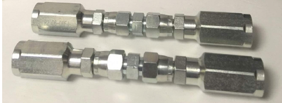

Oh, don't get me wrong. I'd certainly leave them on the tractor/implement. Why remove them?! I was just thinking about using them as a 'quick fix' to get back up and running.
Most stock hoses are made to exacting length. So if one of the stock hoses were to blow, cutting out the bad portion and reconnecting them might make it too short. Thats was all.
I'll probably order a small coffee can of these!

Saw a number of hydraulic repairs on "Deadliest Catch" using the field repair ends. Definitely looks like a good strategy vs crimper option, especially since 1. Ends are reusable, 2. More expensive fittings, but indefinite life (cry once), 3. Can acquire over time as needed, then have for life. Only downside I see is that you are locked into matching brand hose, since they apparently aren't interchangeable. Can't buy any cheap hose & expect top results. But, stock up on compatible hoses and the right fittings and you are probably set up for life.
/ Who Makes Their Own Hoses? #15
Most of the "field attachable" fittings I have seen (which are the two piece thread together fittings) are for R2 hose ONLY. Most places use R16 hose because its alot more flexible.
So blowing a factory hose and thinking you can use a field attachable fitting out in the field will only work if its R2 Hose. R2 and R16 are both two wire braid and have the SAME pressure ratings, but the R16 is a little smaller on the outside diameter. The field attachable fittings thread both on the outside and inside of the hose and "bite" into it. With the R16 being a "thinner" wall thickness so to speak....they dont work.
