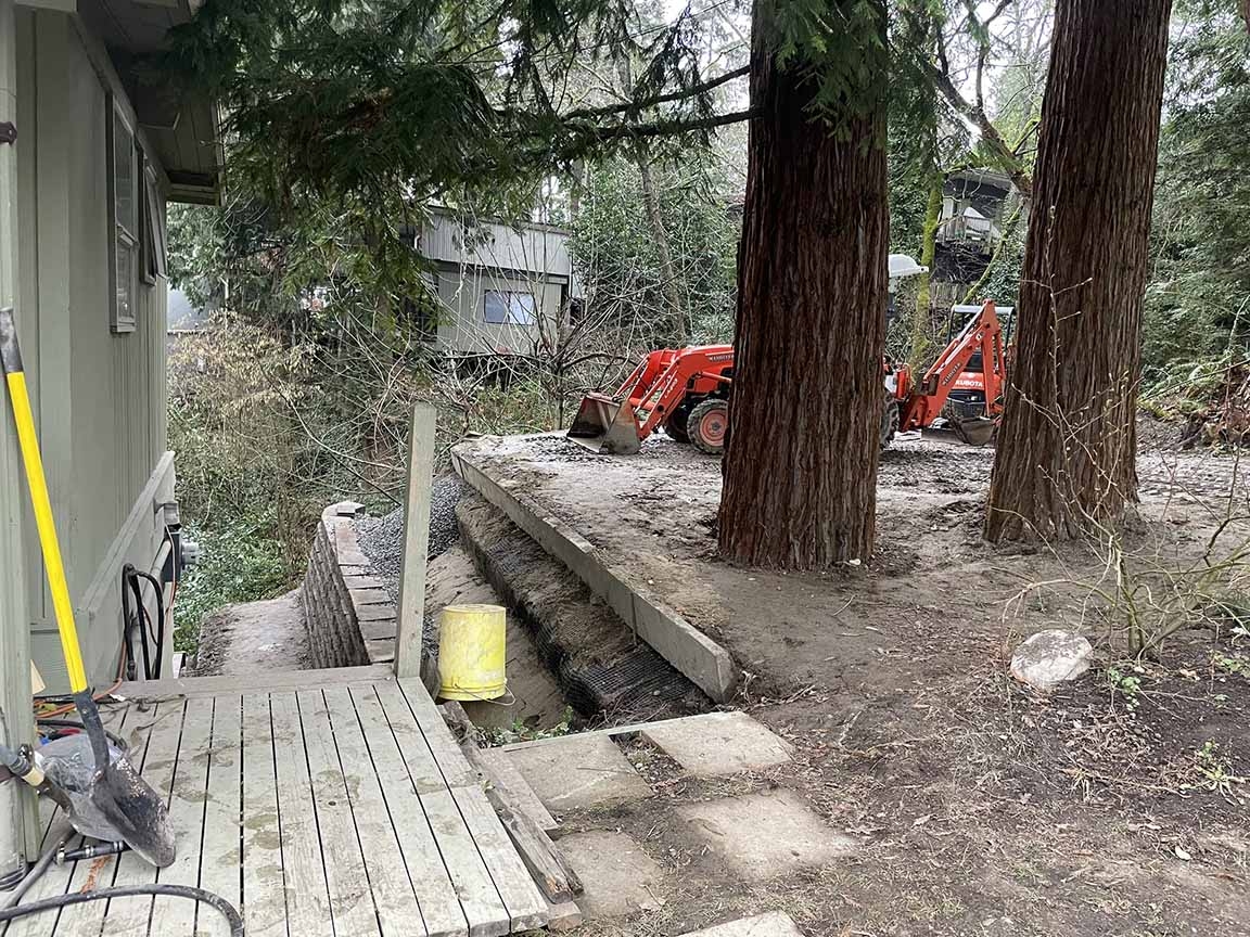

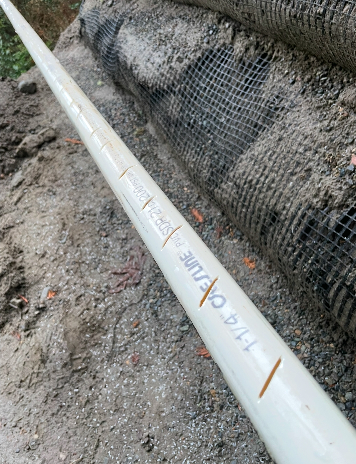

Here's what my guy said.
On your hillside it's not going to be flooded behind the wall.
You will have water coming down from above at one or two places.
If you put holes down it will distribute water over the whole base.
If you put holes up it will carry that water out.
your going to have an extra 1 1/4 of water before your drain pipe starts evacuating.
If the holes are on top, the water level has to be at the top of the pipe to drain. I've always used drain pipe with holes all around.
Putting the holes at the top creates a pond at the bottom of your wall. Basically, you have created a dam that will allow the water to remain there and soak into the base of the retaining wall.
I set it holes-down and he turned it holes up.
I was tempted to tell him what I had read "on the internet....." but decided not to because thats all I had.
I've found fantastic info on the internet opposing what the experienced practitioner does,
.....and I bet we all have.
I understand the that the internet is wrong often.
Anyway I'm curious what you guys think of his POV.
He said the water is all coming from above the holes,
in the areas where it's coming to the pipe.
Well anyway the pipe daylights.
If water is above the slots anywhere along the pipe, its a closed-bottom trough that will run any water out the visible end.
I suspect the gravel bed will be "open" for many years and by the time even one drip runs out of the pipe.... I will have long forgotten all about it.

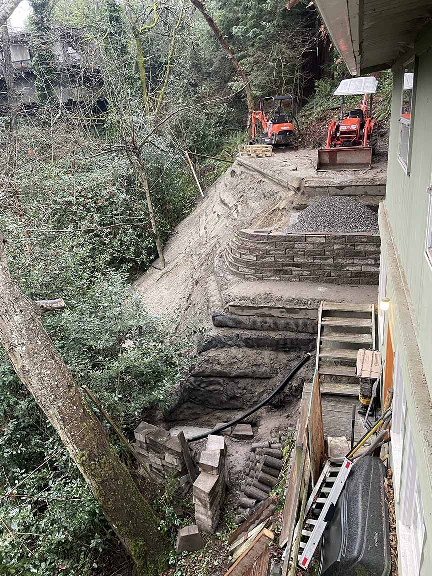

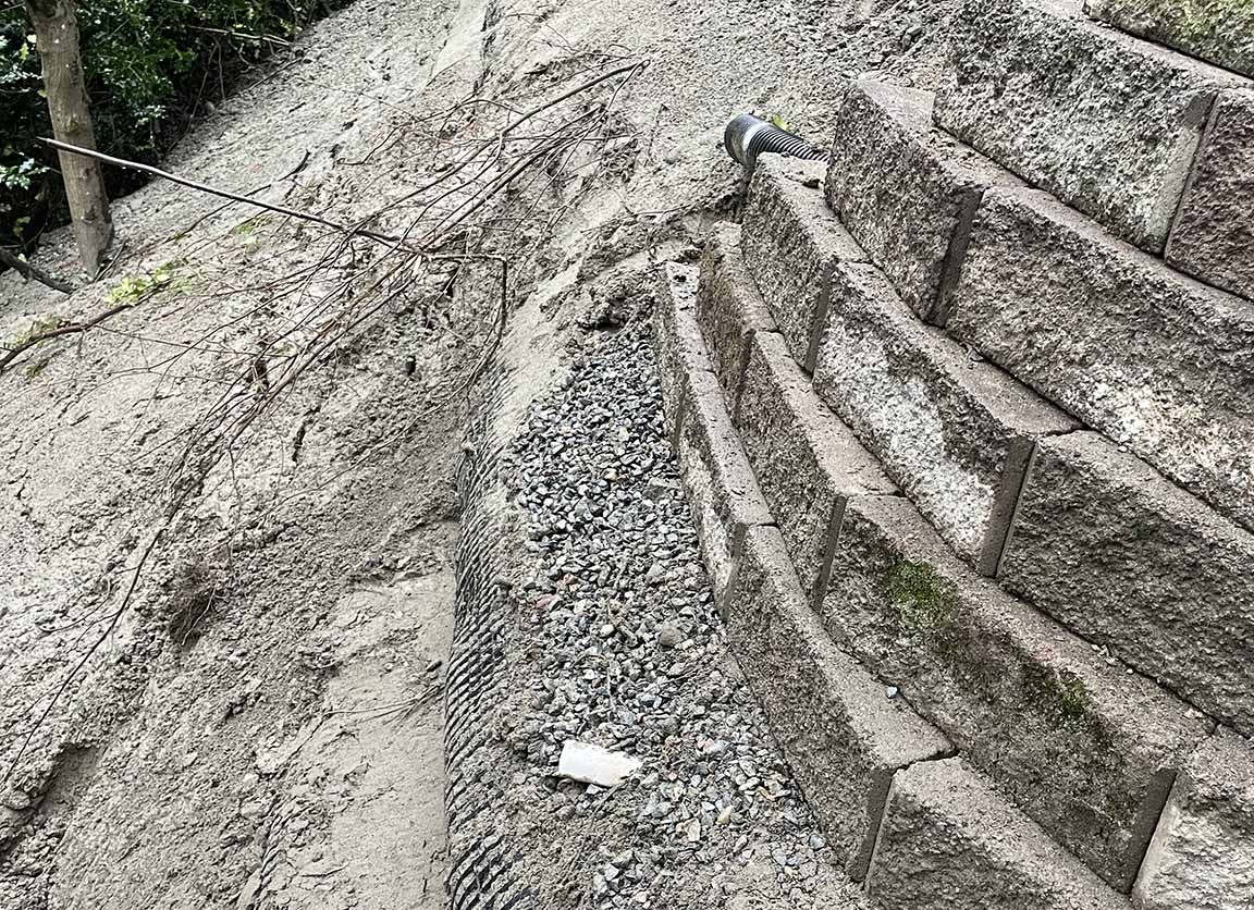

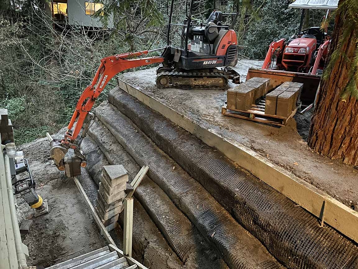

Upper wall is done, ready to remove that last form-board and add the topsoil embankment.
That form board is 4 x 12 x 22 ft long.
Note the gravel waterfall, you can see it in the next pic.

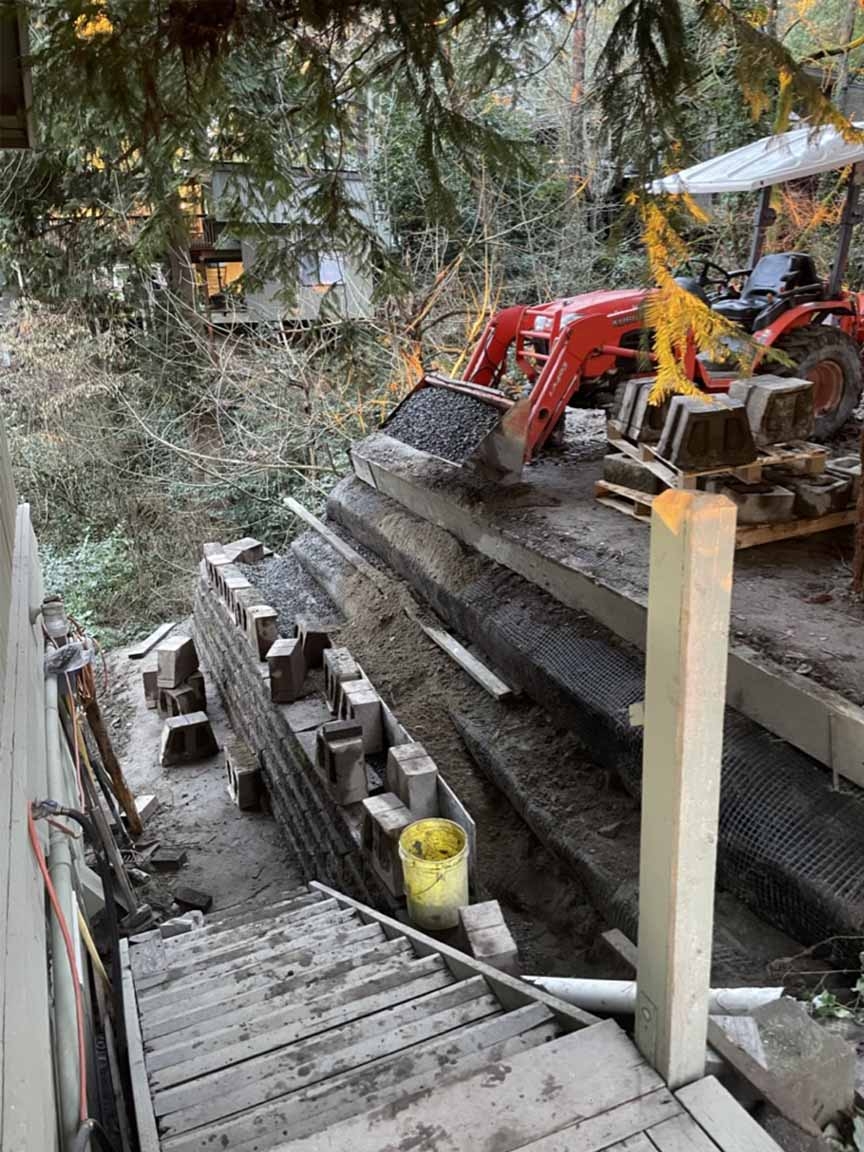

In the coming weeks I'll cover that slope with dark topsoil which will grow stuff fast.
Lower wall is started.
They poured a concrete footing about 18" deep to support the left end.
This wall will be 11 blocks high, coming up to the level of the deck
at the bottom of the stairs.
They said it should probably have 3 drainpipes and should have tiebacks but didn't have any ideas.
that black pipe is temporarily accepting the driveway and downspout water outlet.
A tight PVC pipe will be attached there.
Its up to me to figure out a way to anchor tiebacks into the geotex lifts....
I have several days before the wall builders return.

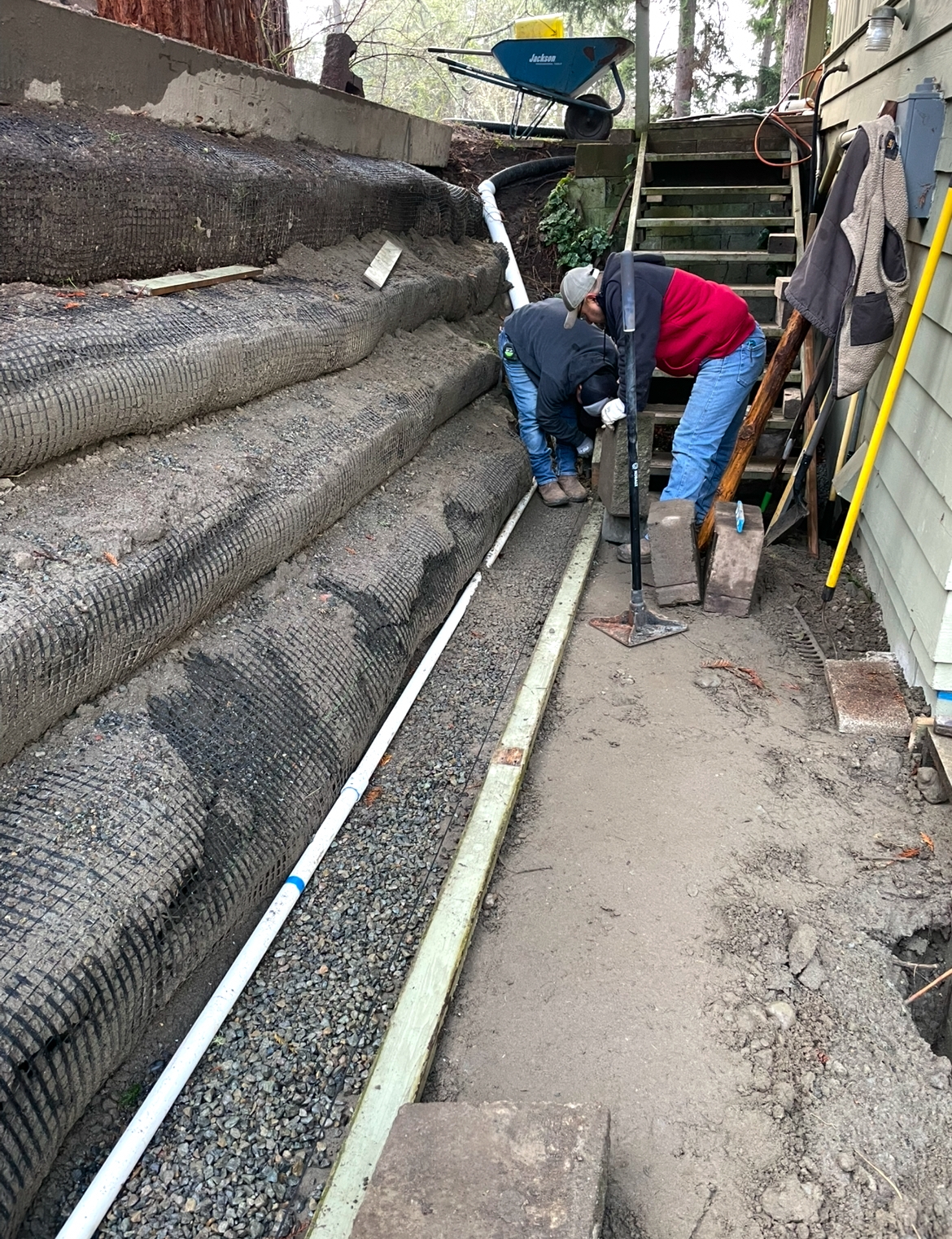

Perforated a 1 1/4 for the bottom course.
Ok it’s started.
My guy said he needs to work with his experienced partner. He said there’s too much to learn and much too slow if I was his helper. So it’s gonna cost more per day but I’m sure, less overall.
Watching them set the first course I can see it would have been a crappy wall if I was doing it. Lots of setting, tamping, resetting the first course. Each block gets moves several times. Re-packed, re-set, re-leveled. Looks strenuous.
Best money I have ever spent paying someone to build my ~100 feet of walls, like you said, starter course has to be dead nuts on, or you will have a f’ed up wall in no time.
You may have saved yourself with that 1 1/4 drainage as long as it doesn’t plug up

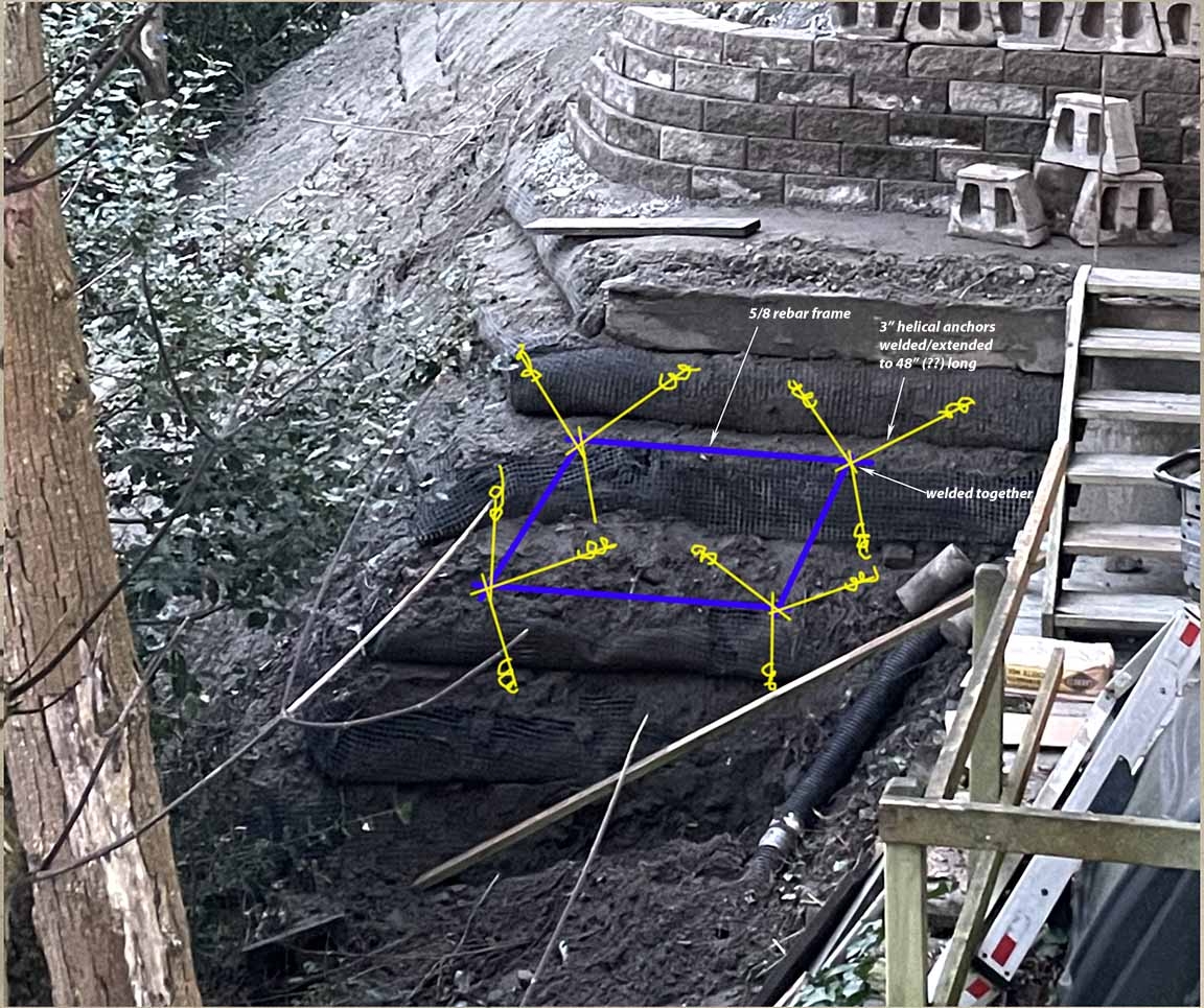

they are installing helical anchors into the slope. That might be something for you to consider.
I ordered some small helical anchors.
I'll weld them to rebar to lengthen them,
and see how far they'll screw into the sand.
I'm guessing they screw right in.
I wonder how to 'qualify' them.
The blocks mfrs say beyond 7 rows (7x6=42"), anchors are needed.
This wall will be 4 rows past the limit, 11 rows.
But it's only about 8 feet long.
I'll pound a fence t-post in with my gas-powered post driver (see how it feels.
They're epoxy-coated and seem to hold fences up for awhile in the ground.
6ft post costs about the same as a helical anchor, but the helical anchor has a 3 inch 'deadman' on the end.
Here's a proposal for the helical anchors.
Put the anchors in and weld them together.
Then attach to the blocks somehow.
I need some tiebacks in place, ready to attach to some blocks by Wed feb12.
I'm thinking to attach to row 6 and row 10 (of 11 rows).
