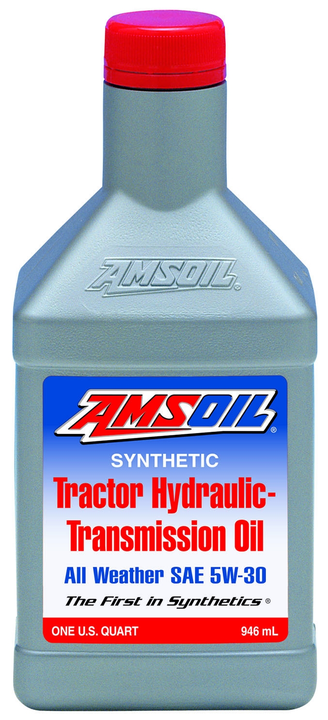

This is what I use in my 2014 CK30HST. Currently close to 600 hours on the Amsoil Synthetic Tractor Hydraulic/Transmission oil. Runs quiet and even in the cold Canadian winter months the hydraulics act like it’s summer. Not cheap but the long drain interval helps…
