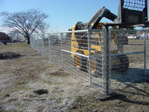

Here's the way it works when the wire is on the same side of the fence as the tractor.

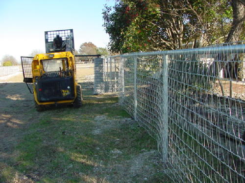

Re: Woven/Horse fence unroller.
But of course occasionally the wire is on the other side. Driving a tractor down the neighbor's side of the fence sometimes goes over like a, well, uh, not well. /forums/images/graemlins/grin.gif

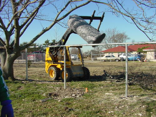

   / While Neal was ___ I was ___

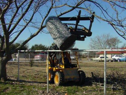

#33
Here it was only a small tree that was the fly in the ointment. But the principle is the same.

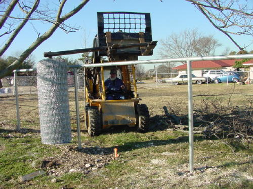

#34
Ready to rock and unroll!

#36

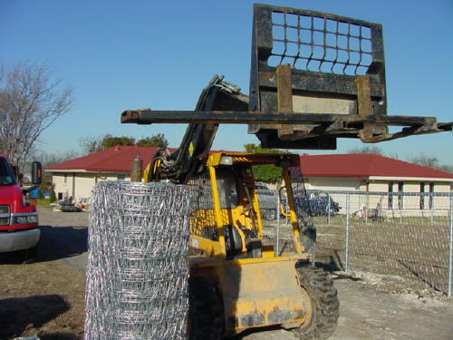

To load the handler one slides the pipe with the base into the core of the roll of wire. One then stands the wire up. The boom is then slid over the pipe, rod placed, va va voom!

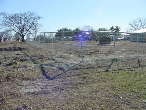

   / While Neal was ___ I was ___ #38
<font color="blue"> I guess I just got lucky. </font>
Yep, it's all luck... no skill whatsoever! /forums/images/graemlins/tongue.gif
You really do nice work, you know that? /forums/images/graemlins/wink.gif
