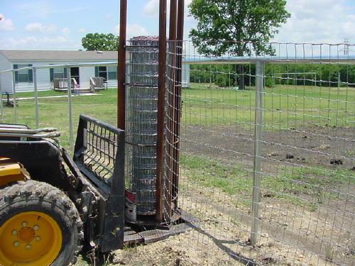

Actually because of the rain I went to the shop and made something I've needed for awhile.
Can you guess what it is?

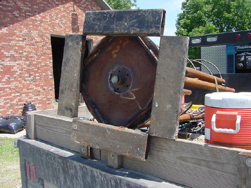

Here's another view, it's handier than a pocket on a shirt.

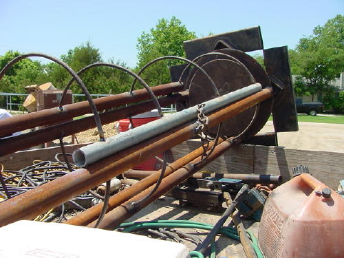

It's something exactly like Neal would do.

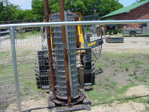

He's almost as lazy as me. /forums/images/graemlins/smirk.gif
One of the harder things to do all by yourself is unroll five foot high horse wire. This thing works like a hose at a fireman's convention.
I can bring the JCB in from all four directions depending upon the situation. The axle spindle allows the wire to unroll easily and the cage holds it up, like I said, it's something an awful like what Neal does when faced with a dilemma or another.

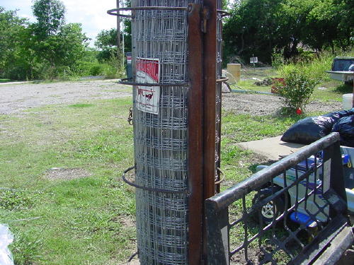

Just open the door and place the roll on the spindle plate.

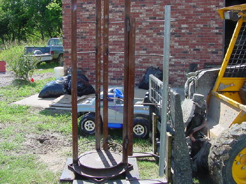

Close the door, undo the clips holding the loose end of the fabric, feed the loose end through the slot, rock and roll.
