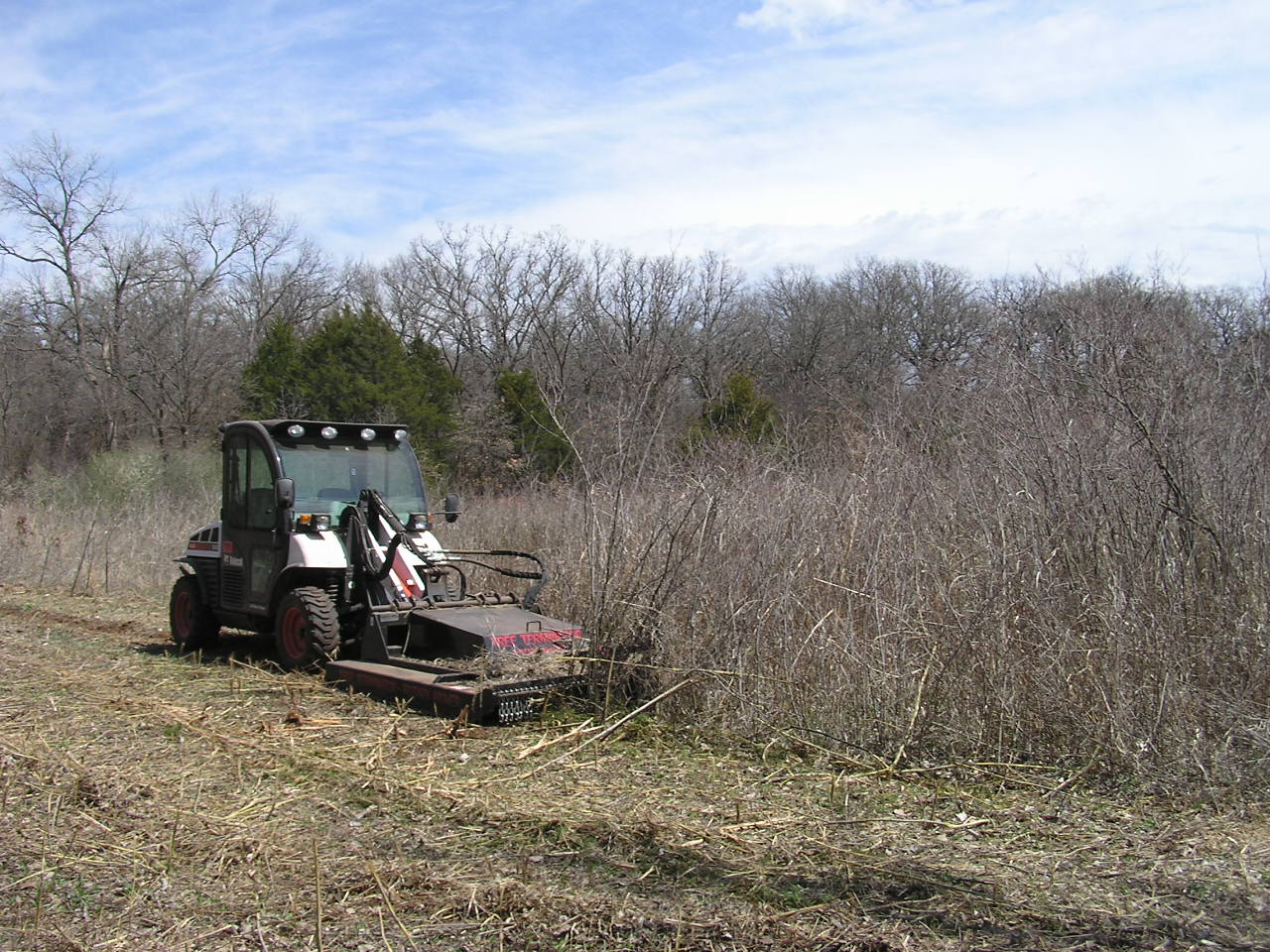

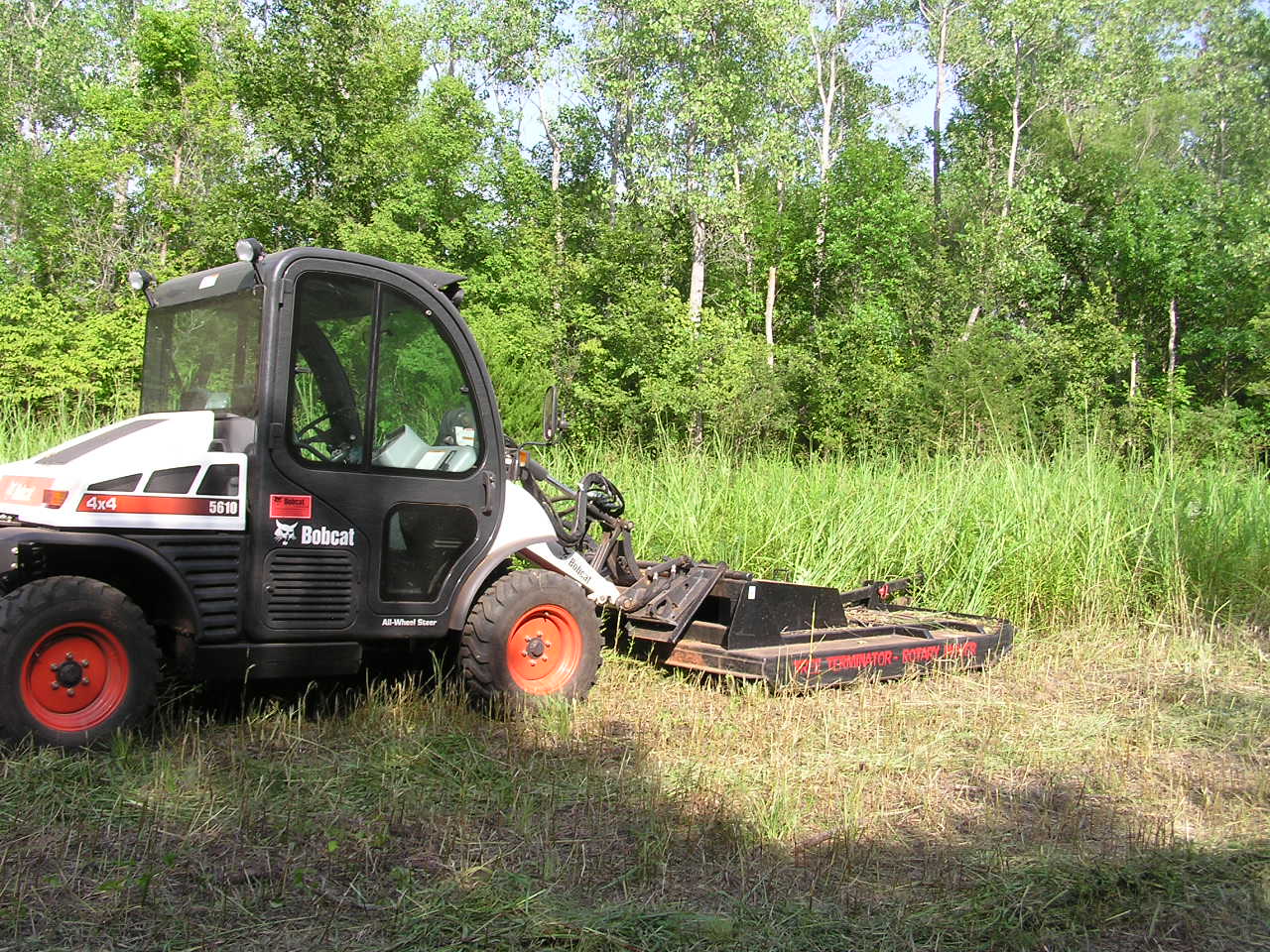

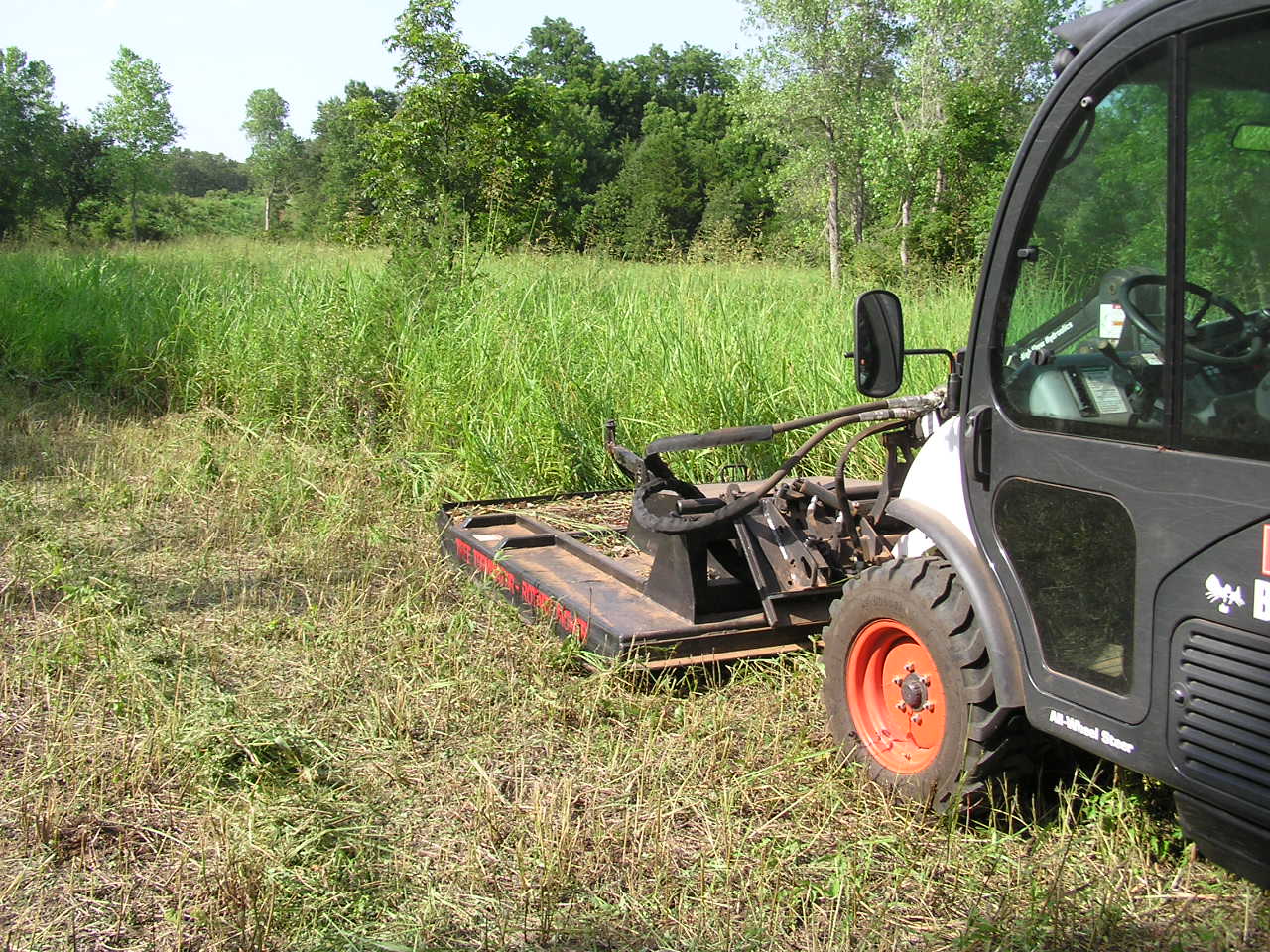

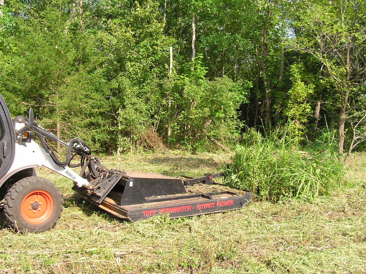

I don't see how a single 4 or 5 foot blade out front is going to solve your problem, but there are numerous front mounted mowers out there from Toro, Deere and others which are sold by golf courses, etc....Even those will have multiple blades with each one no longer than 24".......
Imagine trying to mow with a deck out in front of you large enough to handle a single 4 or 5 ft blade. Seems like a potentially troublesome task.......The mower would be 5.5 ft deep (front to back)at a minimum.......
I don't have to imagine an out front deck, I have one, a 7 ft brush hog.

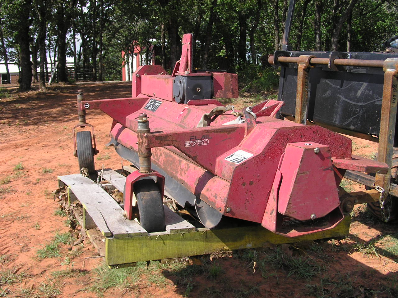

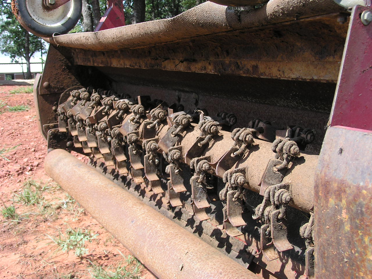

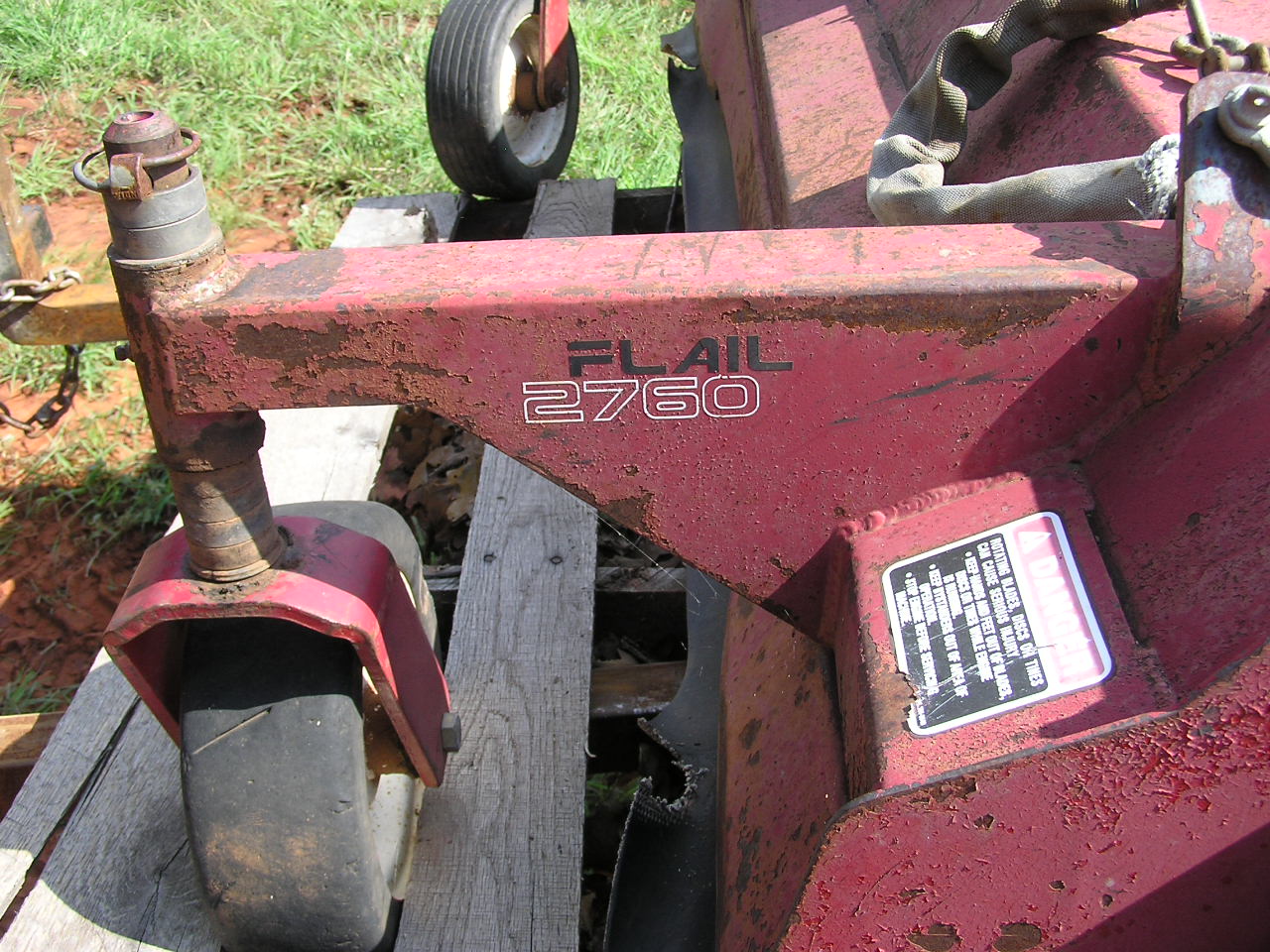

A flail mower will do the job for you. I have an old Kubota F2100 front deck mower that had the option of a flail mower. Don't know how many tractors/mowers have that option but the flail mower will go through the tall grass and not make a mess of it.. They have front, rear and side mounted options for larger tractors. A rotary finish mower will never do the job for you as noted in the above posts.
TORO has one for their 3xx models. It has a 5 foot cut.

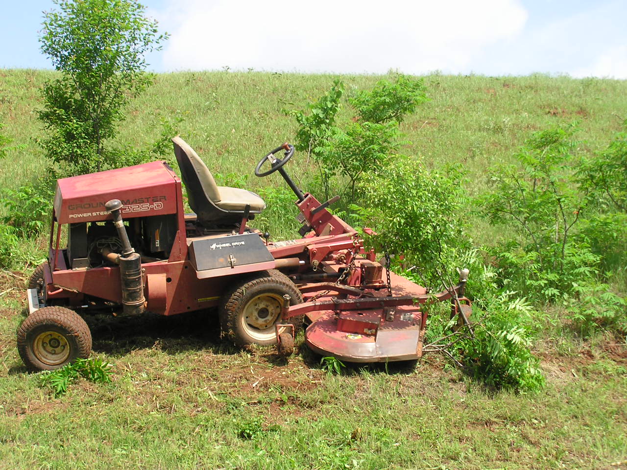

I used to use it on this 325D, before we moved here three years ago.

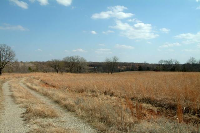

I guess I should try it here on the tall grass.

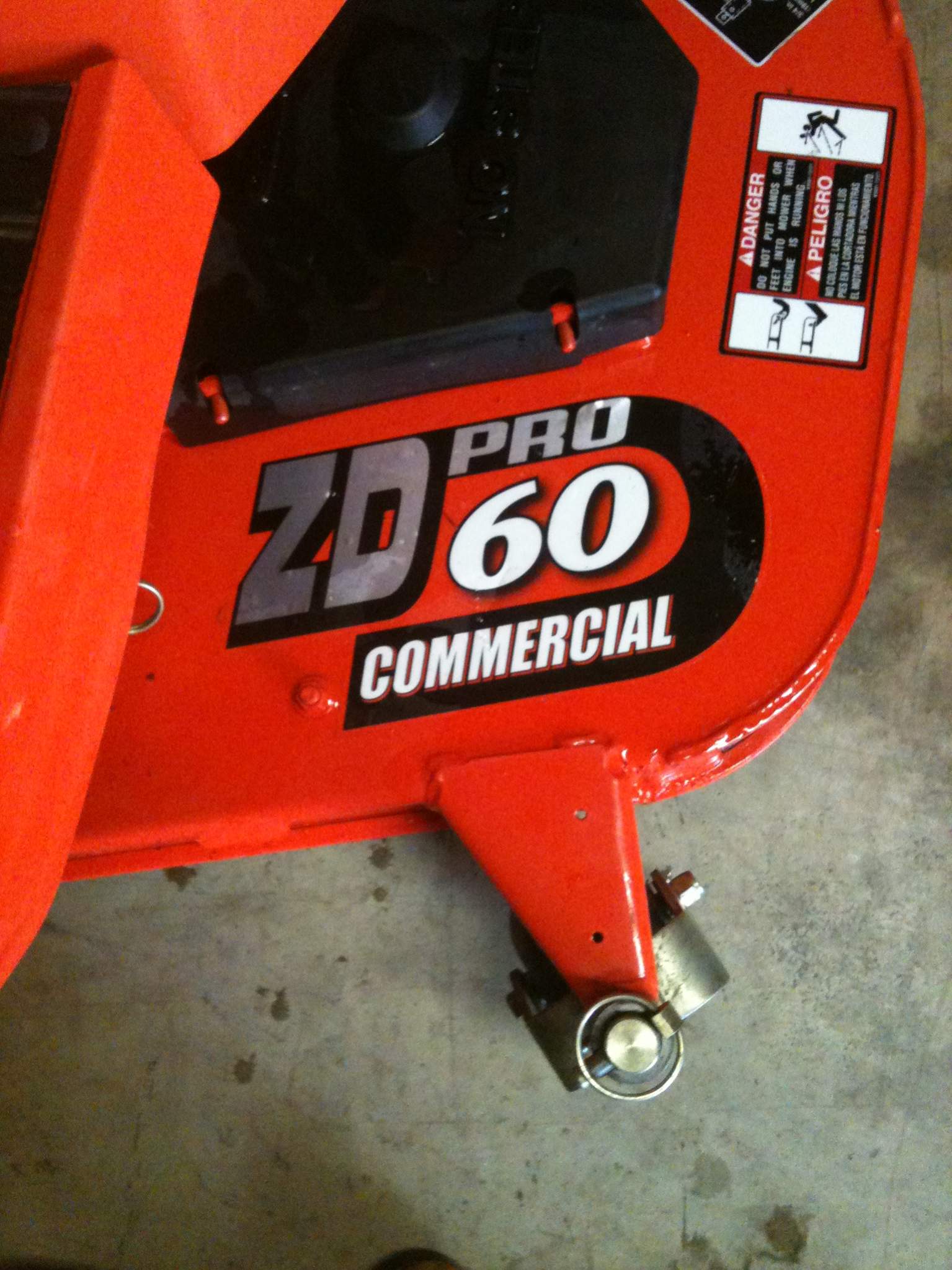

This would be my choice Kubota ZD 326 pro but as others have stated that's pretty tall grass to be mowing with a ZTR.I would say you would have to go over it twice.
