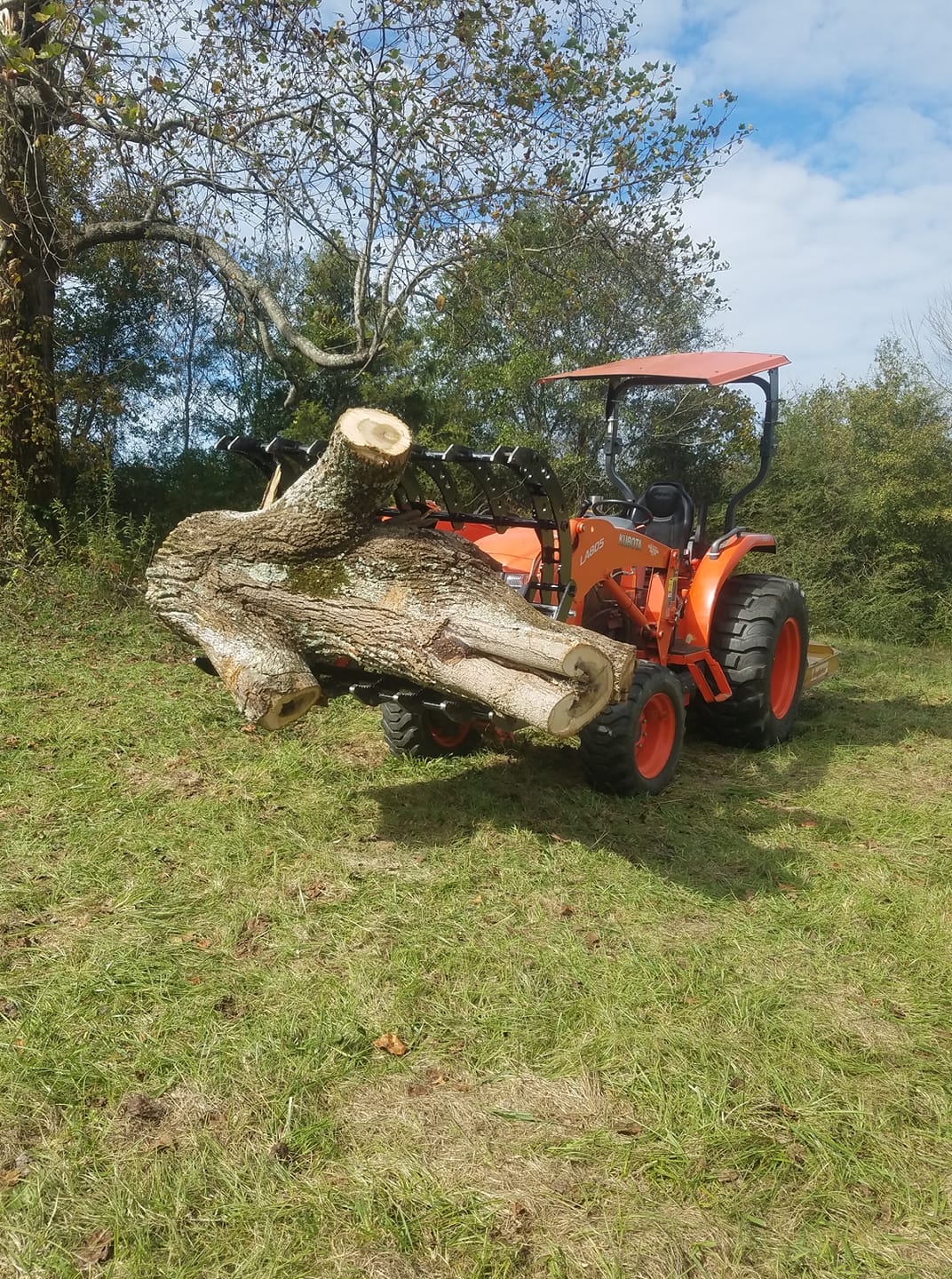

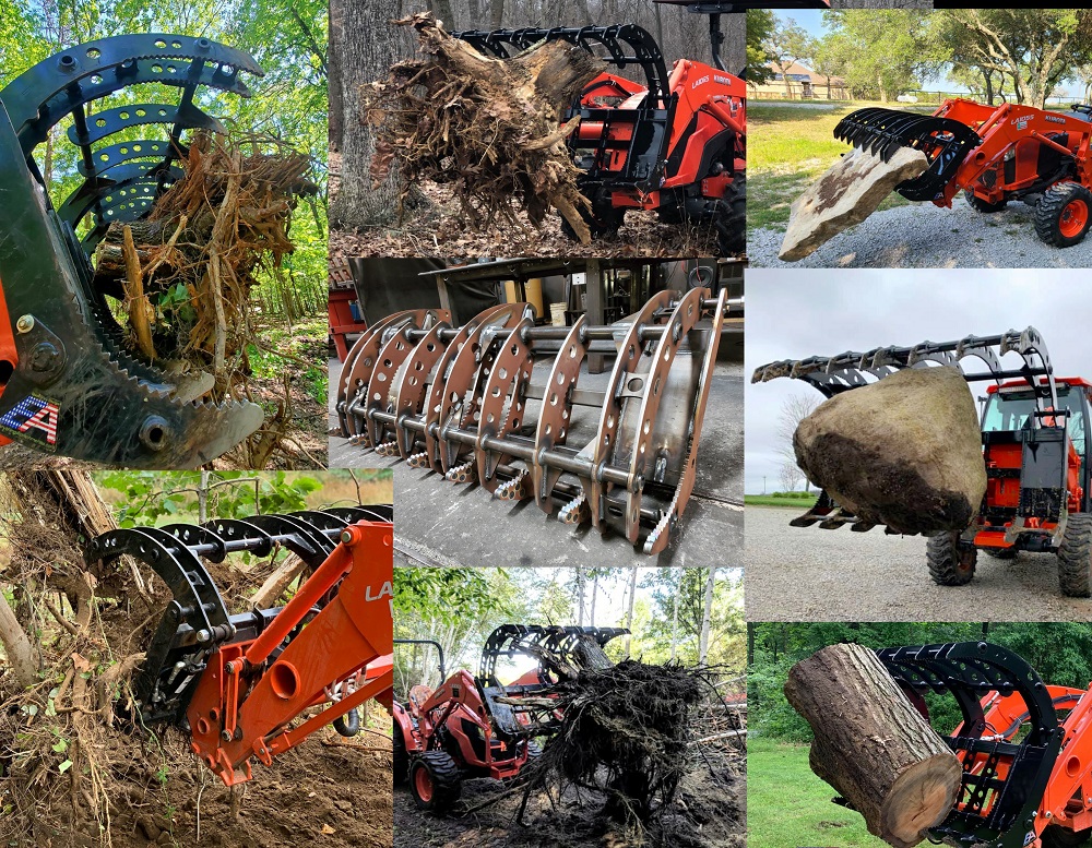

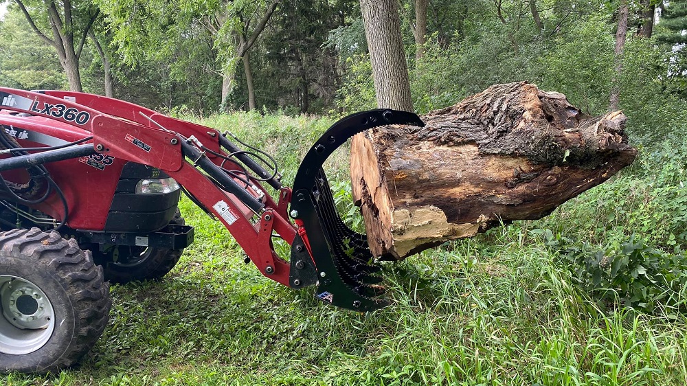

In Kubota terms(again), this L3560 or an L4060 is usually at the top of my recommendation for the 55. This dude is probably hangin around TBN somewhere!
This guy, with his L4060 wanted the extra beef for rougher use, so he chose the 60..

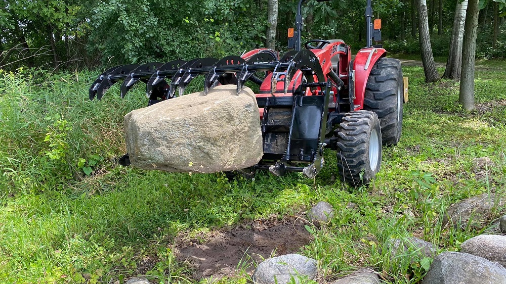

An MX, L6060 and Farmall 50 :) can go full blown beast mode with a 60. All Wicked root rake grapples keep the load incredibly close to the pivot pins, which really helps to maximize ability!

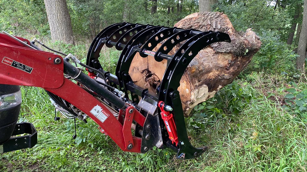

Here's a DX55 flexing its Wicked 60 muscles..
And some more orange guys with the 60..

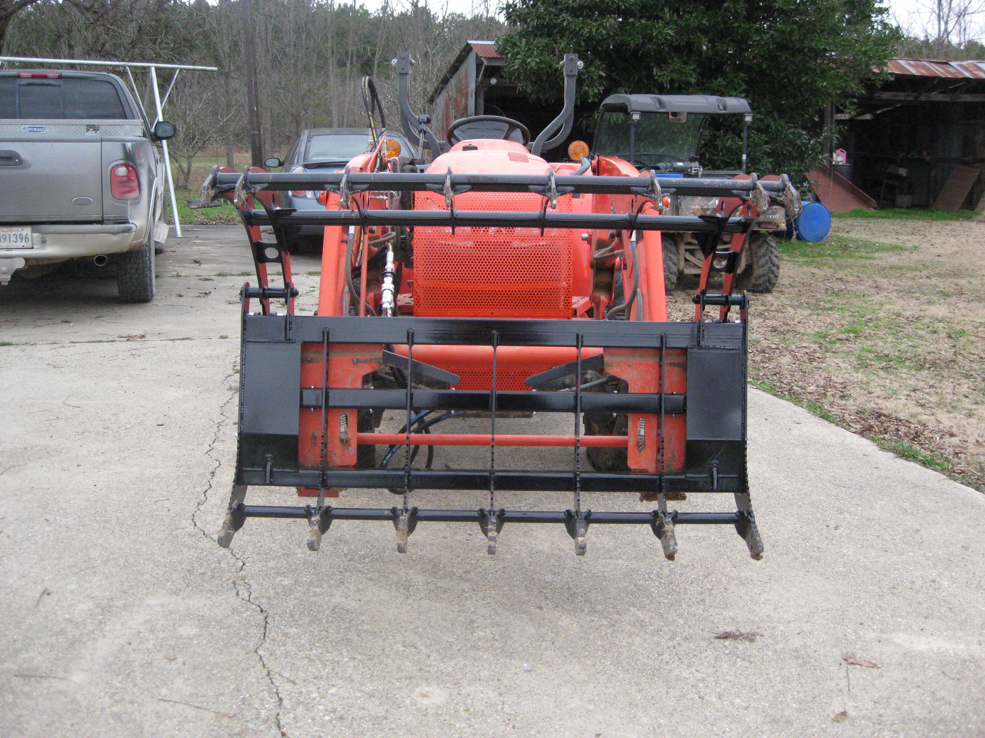

I picked up my wicked 55 at the freight terminal late yesterday. When I got back from hunting this morning, I put it on the tractor. Too wet to go to the woods with it, but just piddling around the shop with it, I can see where this was money well spent. With my v-type tree cutter and this grapple, I'll have shooting lanes looking like a wagon wheel at my deer stand.

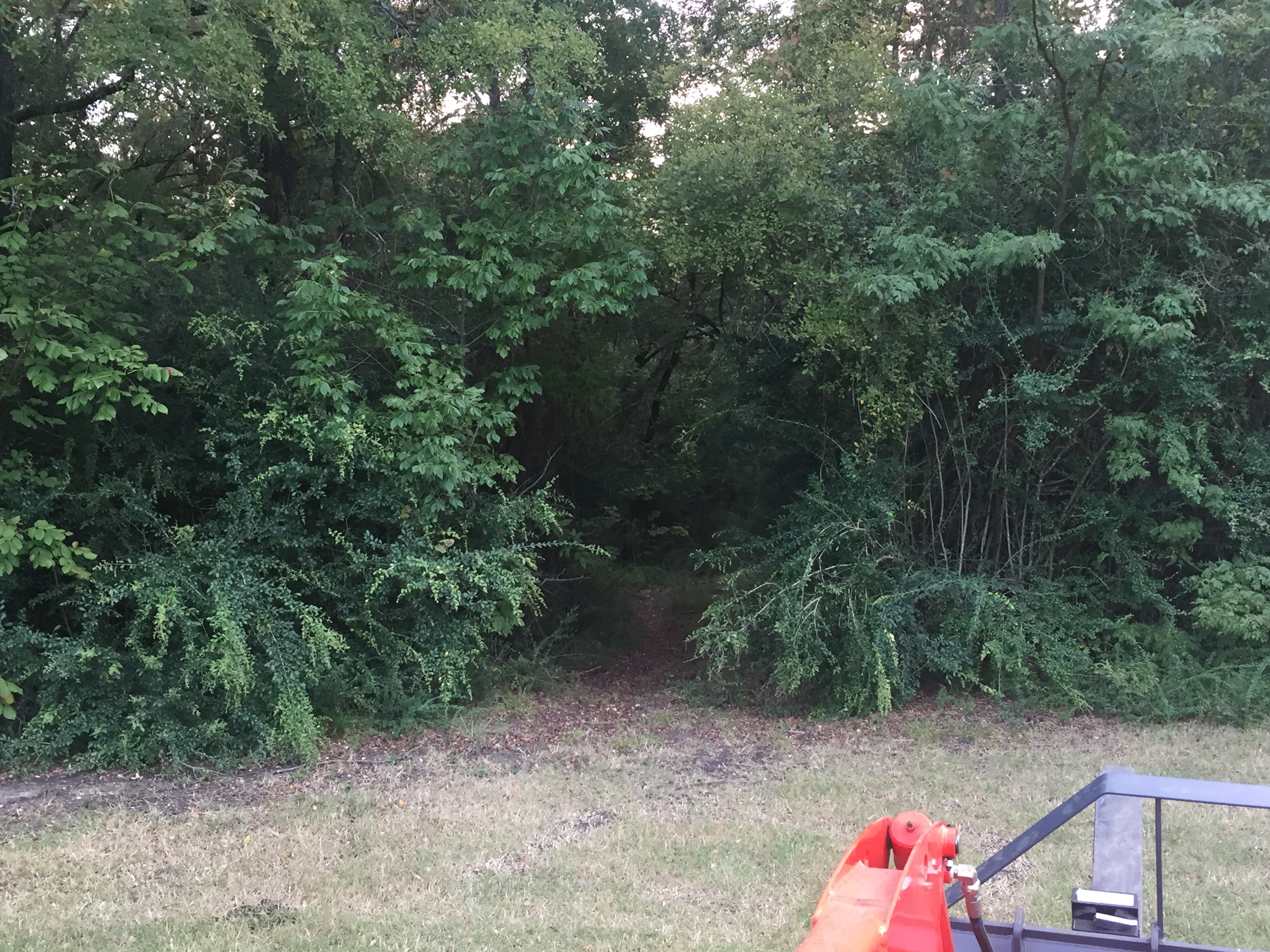

My property is COVERED UP with privet - this stuff is rather invasive and just takes over. It grows in clumps and reaches 25+ feet in height. My L3901 struggled mightily with the larger clumps using the FEL and a tooth bar but I think the MX5400 with a grapple will be up to the task.
I'm thinking the 60" Wicked Root Rake Grapple but wanted to bounce the idea here before ordering. In addition to uprooting and hauling out a few acres of privet, the grapple will be used for generic duties around the property.
