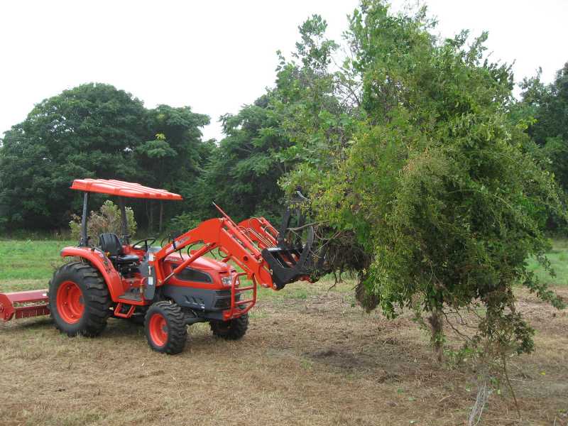

MessickFarmEqu said:

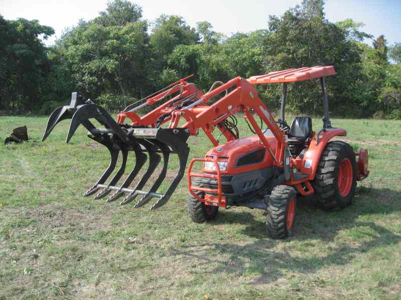

Just note, that Mark.R is lifting directly below the pivot point and very close to the machine. If you put that bale on a spear, it would be a huge load for the tractor. Just like lifting anything yourself, the further away it is from the machine the less lift capacity is will have.. it drops fast, a good 30% for every 18". In round numbers, a CK20 has a published lift capacity over just over 1000lbs at the pins, about 650 in the bucket, and probably around 200lbs 3-4 feet in front of the loader where a bale would be centered. Don't think that it will lift the 1000+lbs that it says in the brochure.
By the same reasoning Neil a BX would not be able to lift much more than a feather 3 feet from the bucket. Your principles are correct but the numbers are a bit out of whack. The KL120 is rated 1070lbs at pivot pins so a conservative estimate of mid bucket would be about 750+. Here is a photo of a CK20 lifting brush that must weigh over 300lbs about six feet in front of the bucket. That is with a 100+lb QA adapter and a 280lb grapple. The rear end was light despite loaded tires and a suspended 450lb bush hog. Why don't you post a photo of a B series lifting something similar?

Rhetoric? I showed a photo of the loader in actual use. Do you think I have a 4x4 beam hidden in there supporting the grapple?
I acknowledged that the principles you were expousing were correct but that your estimate that a CK20 would only lift 200 lbs 3-4 feet in front of the loader was a joke. I provided photographic evidence to bolster my point. How is that "reckless"?

I don't think we are disagreeing on principle, just specifics. Most people using a loader try to get the load close to the "pins". Obviously most loads are not single points of weight and are therefore spread out as in the example photo I posted where the load is pretty evenly distributed from very close to the pins all the way to a point approximately six to eight feet away (look at the size of the shadow). The average load would therefore be about 4 feet from the pivot pins given the space taken by QA adapter and grapple back. The load was heavy enough to cause the rear of the tractor to be light despite loaded tires and a bush hog. I don't know the exact weight of the load but on reflection it must have been pretty close to the weight of bush hog (450lbs) given the effect on tractor balance point. By your calculus, at 4.5 feet from pivot pins the loader should only lift 10% of rated pivot pin capacity which would be 107lbs. Even at three feet your estimate would be 40% of rated load or about 420lbs. That just doesn't fit with the evidence here.
Yes, the longer the distance from the pins the less weight you can lift. I'm not a mechanical engineer or physicist and don't know the exact calculations. But your suggestion that a CK20 cannot lift more than 107lbs four feet from the pivot pins just doen't fit the evidence. Your experience with Kubota loaders may be biasing your world view.:D
