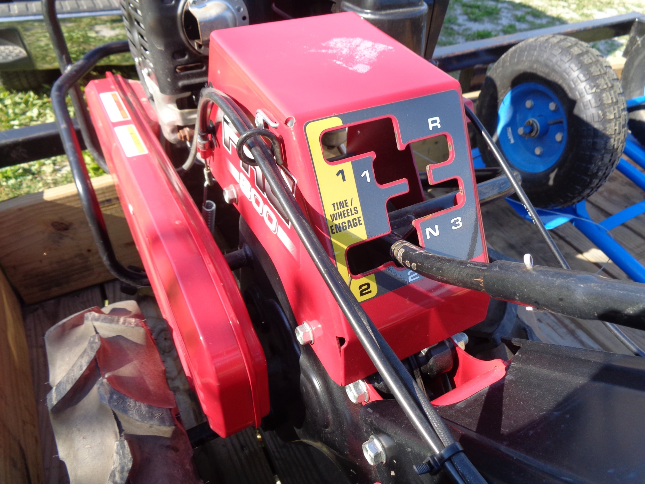

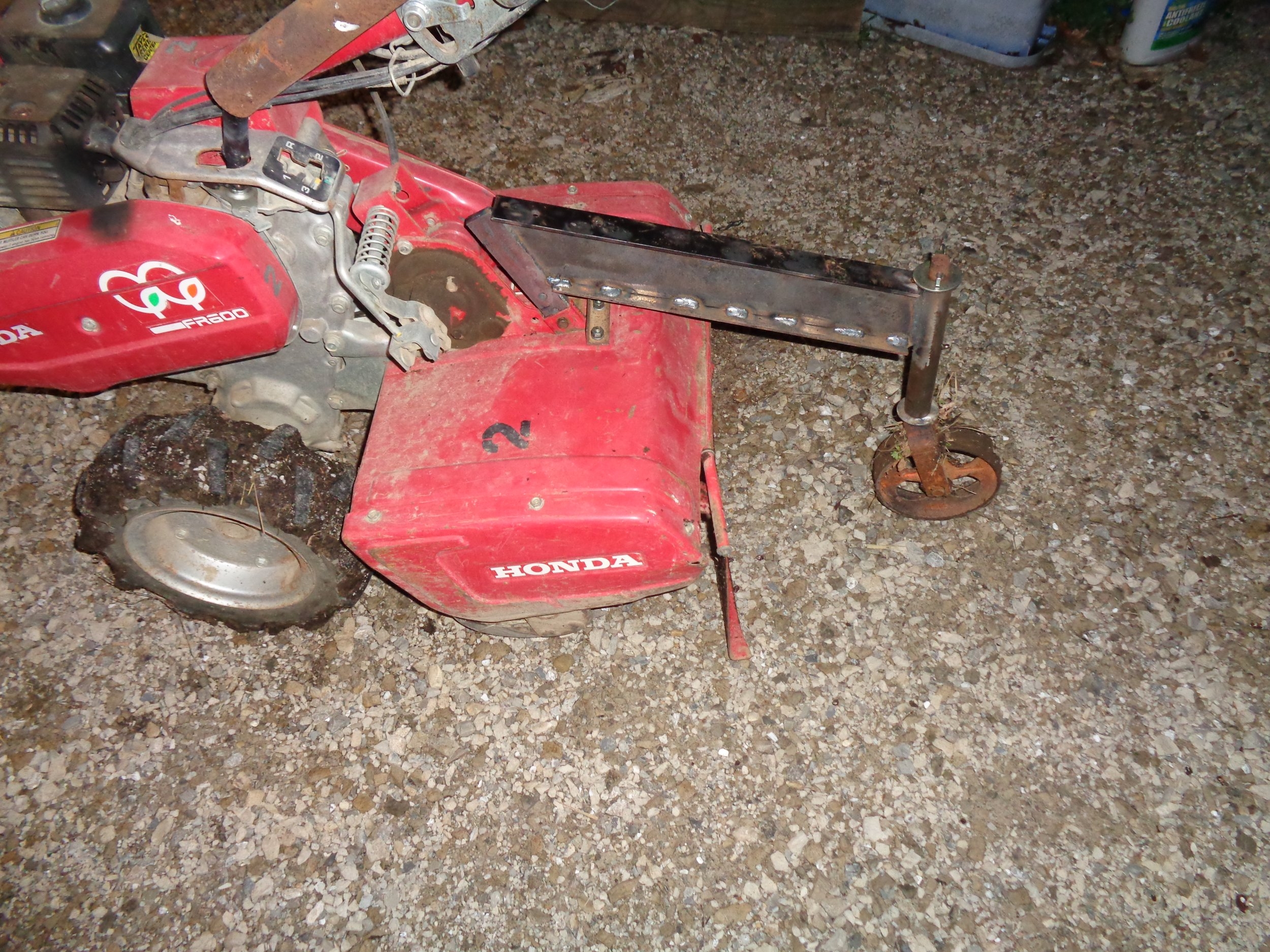

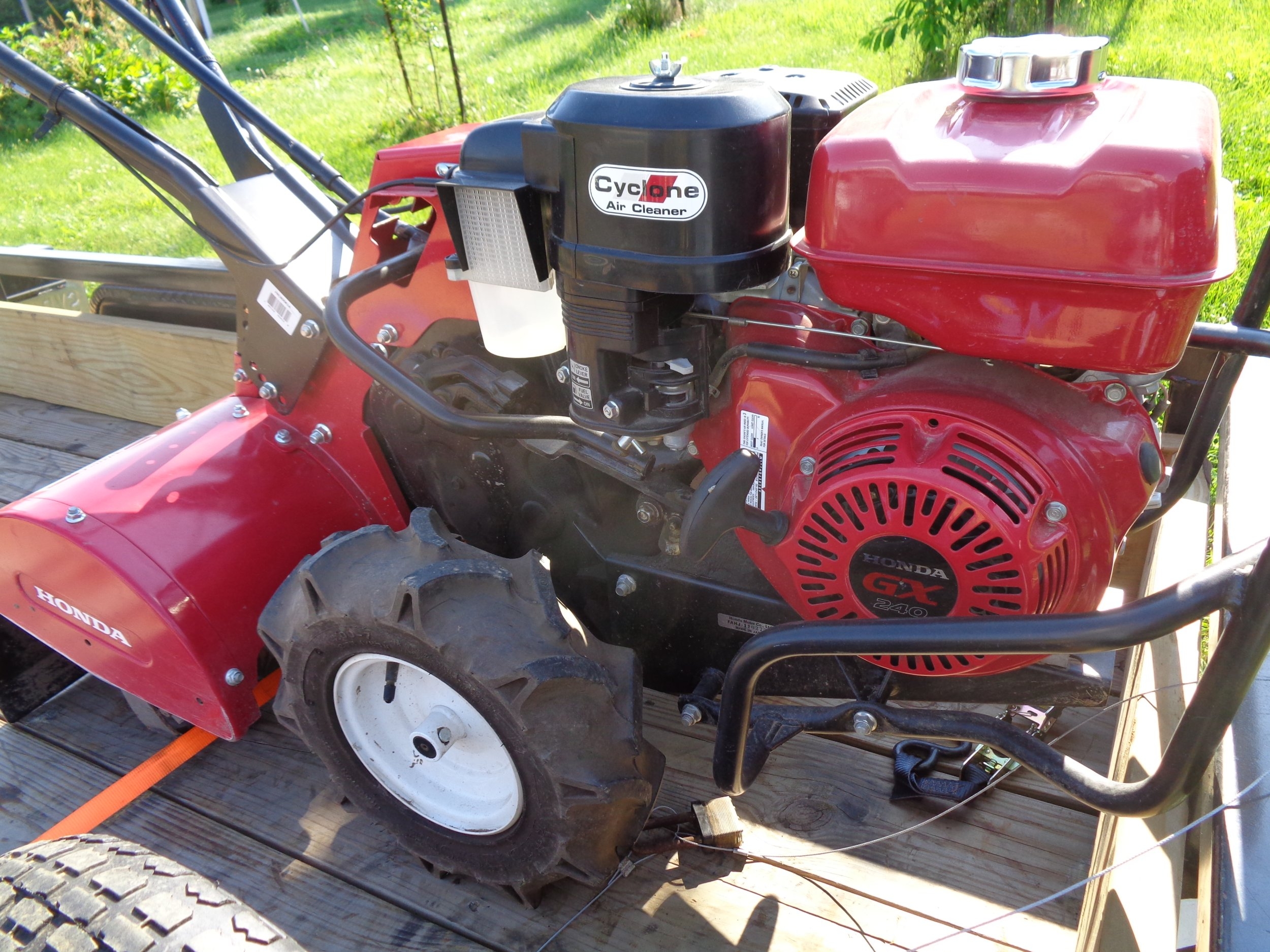

I love my Honda tiller(s). I started off with a FR600 from a local rental place that was selling off some of their equipment in 1998. Pretty sure they said it was 3 years old and showed plenty of use, and I'm sure abuse. It impressed me that it started on the first pull and ran like a charm. It served me well for the 24 years I owned it. It never once failed to start beyond the second pull to start even before I started using fuel stabilizer in fuel here. It still had the spark plug that was in it when I bought it, although I cleaned it a few times over the years. And still had the, as far as I know original drive belt, I know I never replaced it in 24 years. Best part is, I sold it for a little more than I paid for it. But that price was way less than a comparable new one and was still a great tiller, I just decided to upgrade.
Fast forward 24 years, I bought this barely used Honda FRC800 at a consignment sale for half the price of a new one. Paint was hardly worn on the tines. Got the spark plug wrench and owners manual with it still in the plastic case and appeared to never been opened. Looked like they maybe tilled up a couple flower beds, or a very small garden. A bit more to handle than the smaller one when turning, but it is a beast. They do not have counter rotating tines but for breaking new ground simply go a couple inches or so at a time, it will eat it right up. Dirt being a bit moist helps a lot.
But mainly I like that they have 3 speed transmissions. 1rst for heavy tilling & 2nd for light tillering/cultivating and 3rd for tramming back & forth from shed to garden. I don't know now if others offer multiple speed transmissions but I sure do like it.
I made the rear caster wheel for the FR600 to till through leaf mulch I use. It was an extremely wet Spring and literally thousands of maple sprout were popping up and needed a faster way to take them out than a hoe. The drag stake would gather and bunch up the leaves making a mess. Luckily I had enough "stuff" around to build this. I drilled multiple holes for depth settings because I only use it to cultivate when plants get too tall to straddle with my David Bradley's I cultivate with. I only till about 2" deep to fight the seed bank in the top 2", otherwise your just bring up more weed seed from down deeper, plus is a lot easier on the soil structure. The caster wheel has since been lengthened to fit the 800. It also makes it a lot easier to steer around plants when tilling close. It's easily steered with one hand.
They aren't cheap, but if maintained should last most a lifetime other than tines.

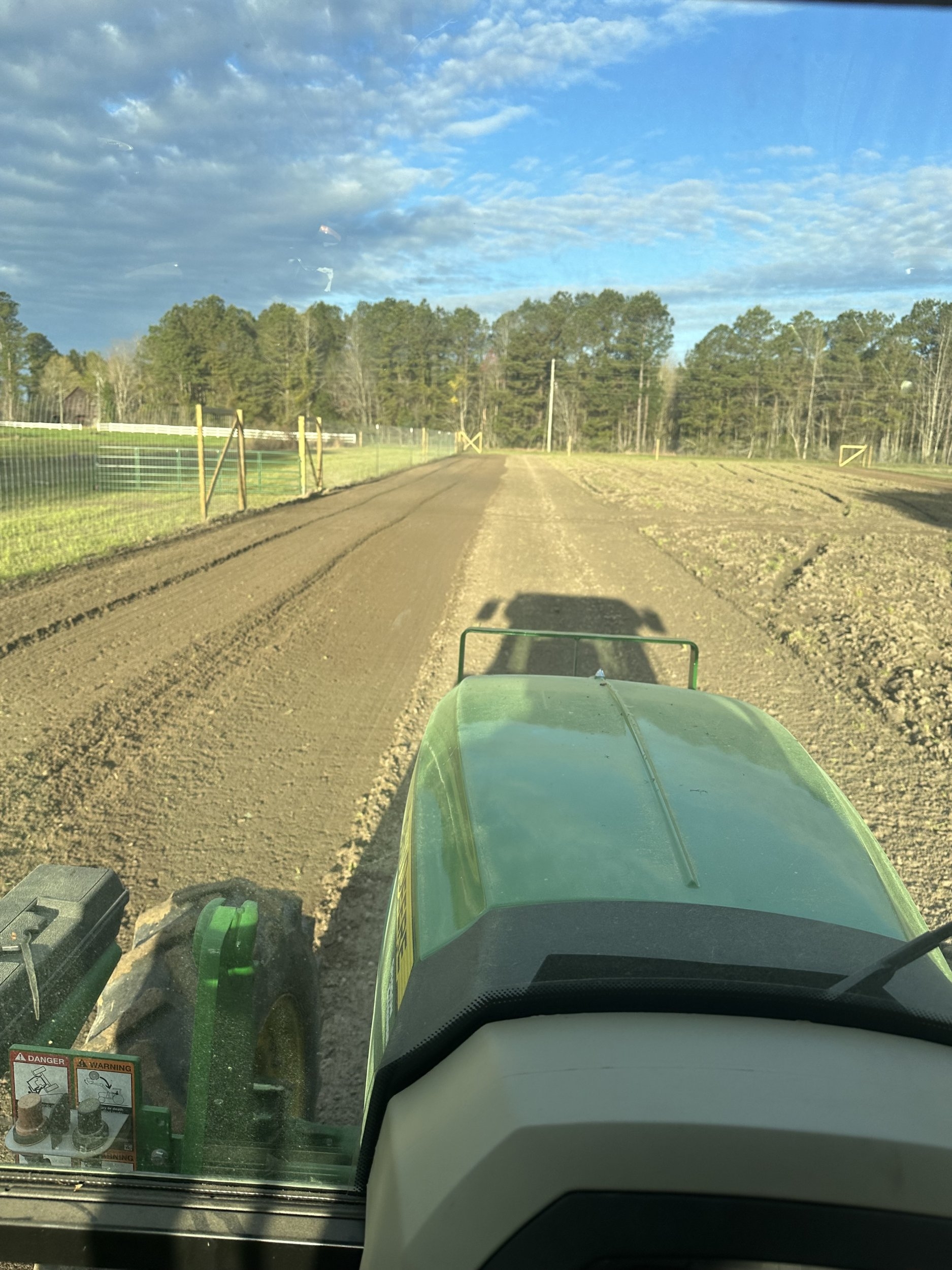

I cultivate with one of these.
