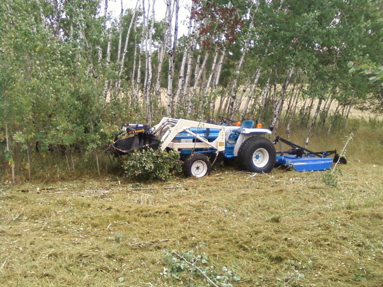

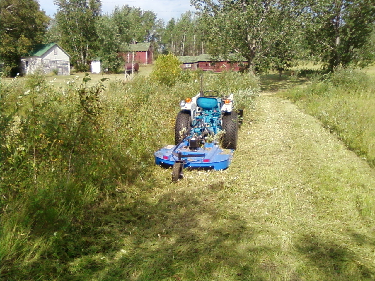

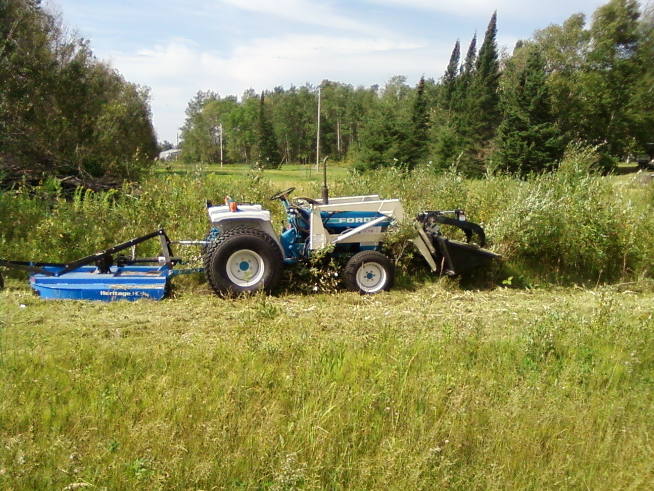

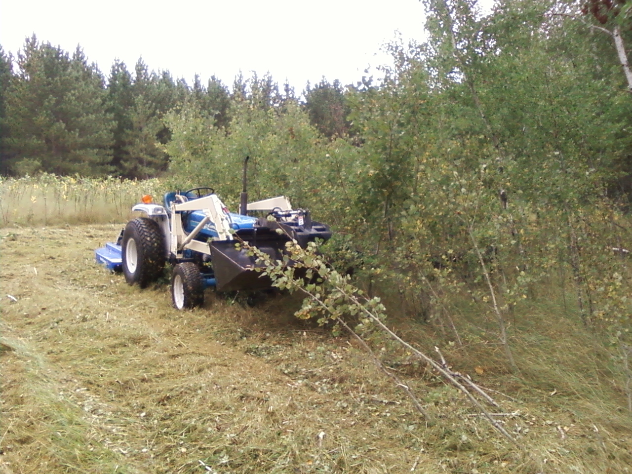

I can't pretend to know exactly what you're trying to cut, but I can show a few pics showing what my Woods HC54 has cut. The first two pictures are poplar up to 1.5" dia., maybe a couple were bigger. Made quite a racket! The next two are a bunch of willow that have taken over old pasture. Some were approaching the 2" mark also. Most were growing in clumps and clusters. I was very pleased with how well it handled it.
Hope this helps.
Joe

That is some pretty rough looking stuff, Woods makes excellent equipment. I noticed that Land Pride has introduced some machines to compete with the heavier Woods cutters.

I'm not surprised how well your cutter held up...I am pleasantly surprised how well your turf tires are doing though.
