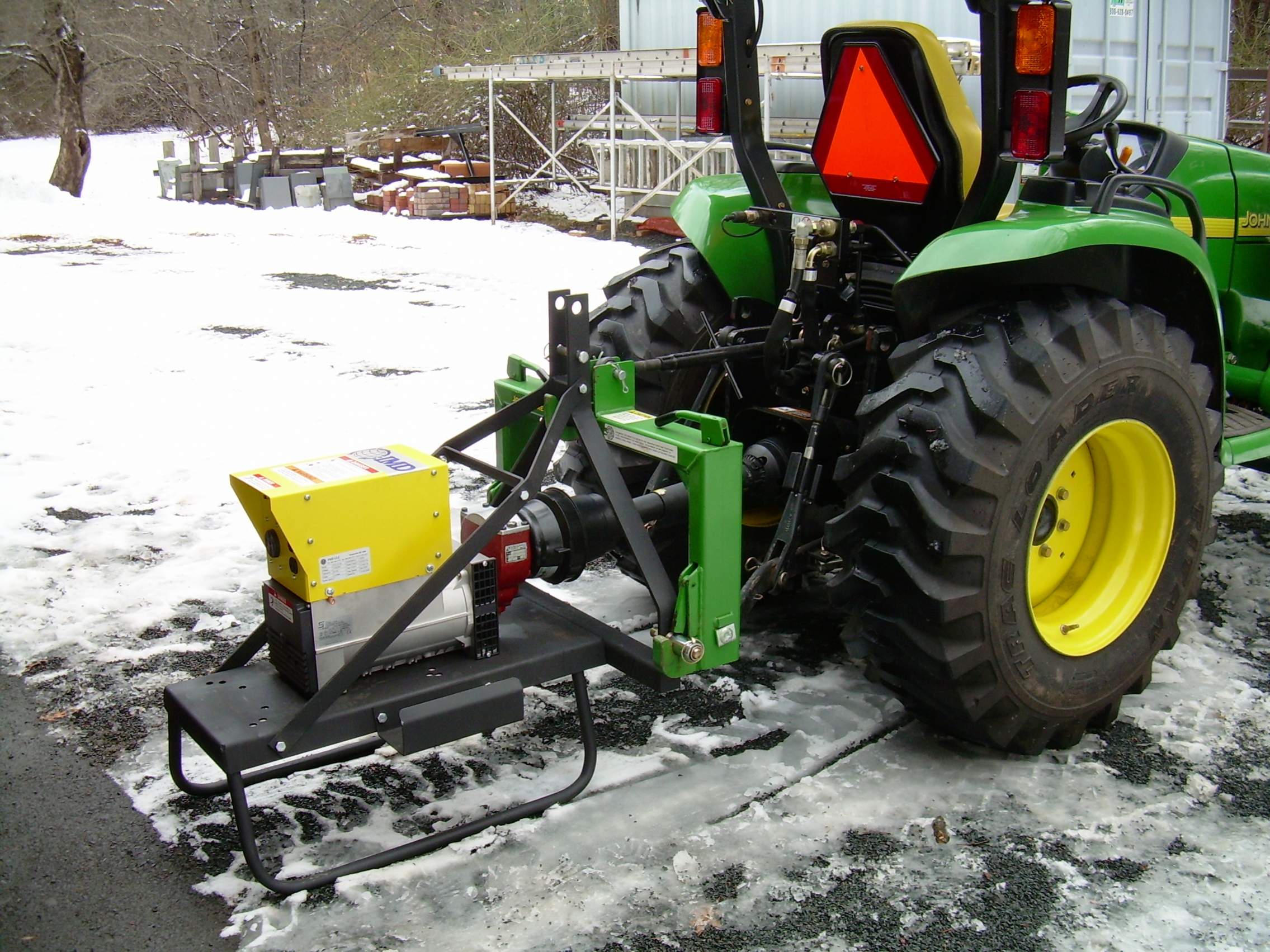

Check out IMD they advertise here on TBN now. I got a 10 KW last year, they seem well made. and they offer a nifty carrier that really makes it quick to hook up and go.
There ad is the second one down when you hit the discussions tab.
IMD, welcomes all Tractorbynet Users!
JB.
