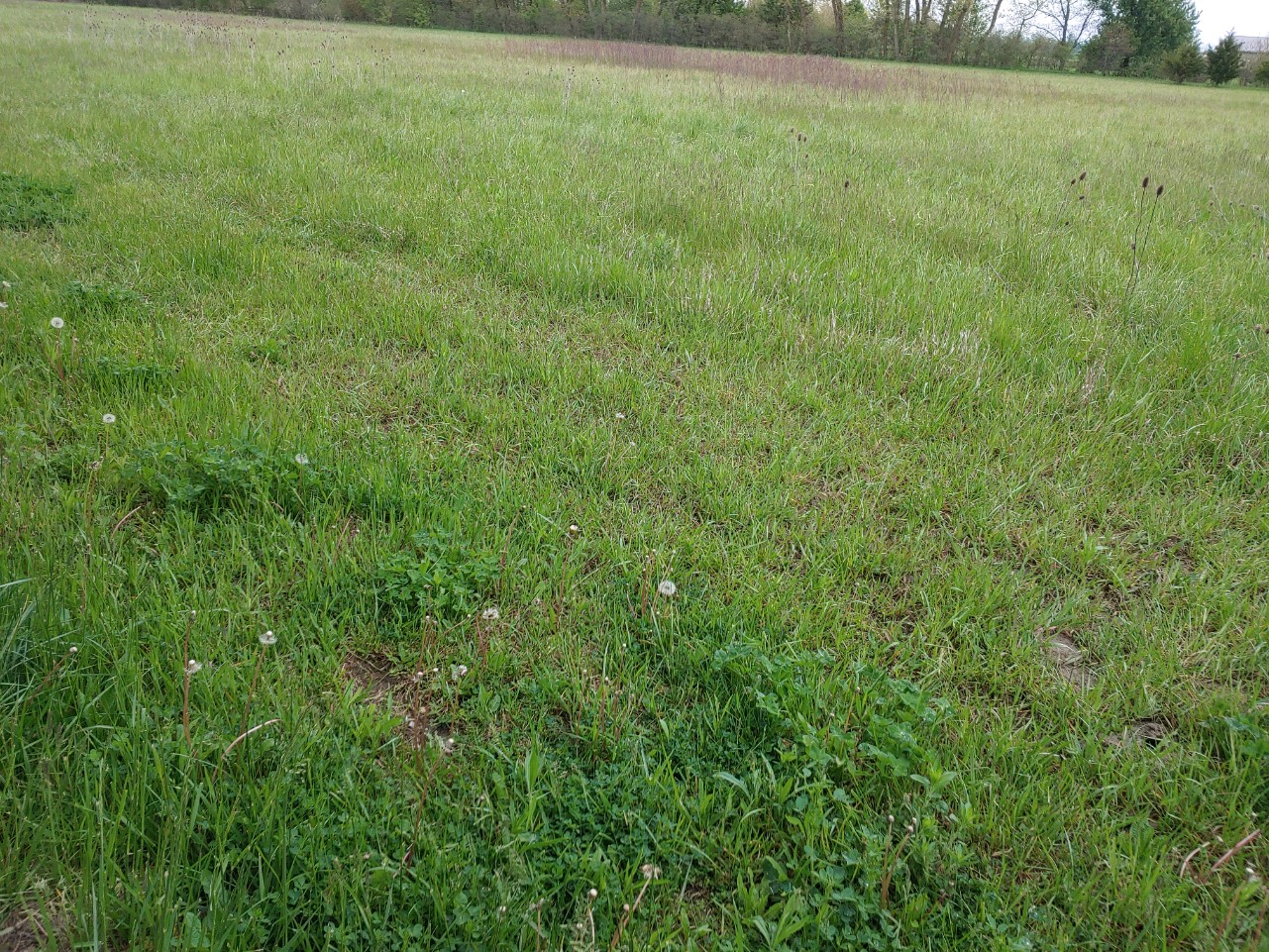

New to tractor life. Have property. Used to be plowed. Seeded with Kentucky 31 fescue and grown for years as wild
Lumpy bumpy flat land in Ohio. I purchased and would like to mow. Do I want a brushog? Finish mower? Flail? honestly, I don稚 know the difference, but I don稚 have anything but uneven bumpy ground. No rocks logs or anything like that.
Suggestions for a mower?

Profile says 1-10 Acres - and sounds overgrown and rough - so suggest a brush hog
   / Which mower? #5
agree. 72" RC should do fine. it will also be able to be used for mowing when it's no so rough.

3-4 acres. Could mow about every 2 weeks. Leaning!

His LS is 25HP and 18 PTO so 5' cutting width.
I would find a used Brush Hog $500 and use that for a year or three depending on the end goal - a house lot, lawn etc.

If real bump finishing mower might not be a good option. If you have brush to mow don't put a finishing mower on it yet. If you want a lawn type cut rough cut mower, many will call a bushog (which is a brand) that is not the mower for you either. A flail mower depending on the flails on it you handle a reasonable amount of brush and also have a decent cut lawn. I like flail mowers but they are harder to make tight turns with and not damage a lawn.
Back to the bumpy ground, why not get rid of the bumps?
