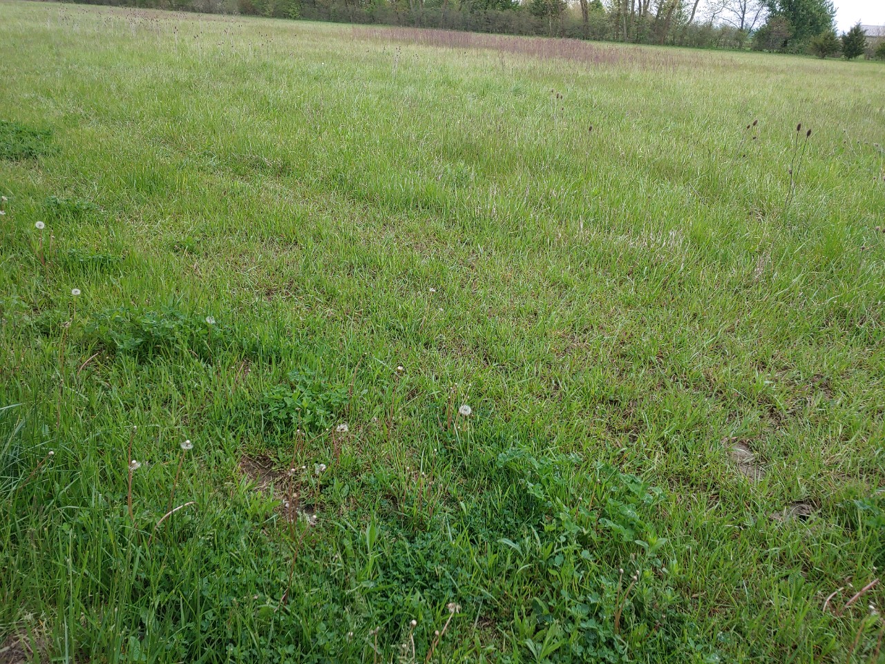

I've attached a photo, although it doesn't portray the lumpy bumpy well. It's pretty safe to walk about but there are holes and lumps here and there.
I don't have a roller. Maybe I will look into borrowing one before I cut.
Now that I see that photo, You could probably do it with a rear mount finish mower as well as a rotary cutter. If you do a finish mower, set it high first couple times in case theres rocks or steer around the rocks and dig them out or weed wack them. We call that a meadow or a paddock, which is a semi-maintained field. Consider a used finish mower. That way you won稚 feel bad when you hit your first rock. :laughing:
You could do a flail mower, but theye more expensive. Unnecessary
It all really depends on what you want the land to look like. Is it a future lawn, future field???

Goal it to build a house and eventually live on the property. I can't seem to find a builder to commit. A finish mower may make the most sense as I could use it through the years as I age.
The girlfriend brought up the idea of mowing and I figured it would be a great way to get her some experience on the tractor.

I would do a 6' finish mower, assuming your machine could lift it easily. Front weights or a loader may be necessary to keep weight on the front.
I ran a 6' Befco finish mower on my old B8200 in similar conditions, but I had to add 150 lbs of suitcase weights up front. Your machine is a few steps up on size than the B8200.
   / Which mower? #17
You could probably do that with a finish mower. But with 18 pto hp, I wouldn't go over 5 foot, and probably 4 foot would be better on a finish mower. Could probably do just as well with a 5 foot brush hog. Once you got it mowed a few times, you could always sharpen the brush blades and it would cut more like a finish mower anyway.
