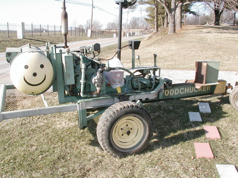

My dads with a 20 HP onan electric start propane engine which had no troubles in the cold.

Here is a picture of my dads unit that includes a 4000 watt generator and overhead lights. This thing he built himself and has a hydraulic cylinder that allows the wheels to raise and lower the I-beam to the ground. I put many hours on this thing. Notice the fuel thank that will last two years.
