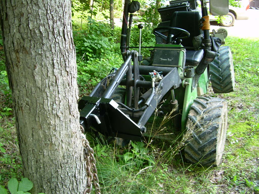

The frame is a standard forklift carrier. I just welded brackets on the back for my 3pt hookup. I use two forks when I move pallets. I also use either one or two forks to dig up plants. You could make up a simple ball hitch adapter for the QA plate if that is what you have.
You can't see it, but there is a 2 in receiver behind the one fork.

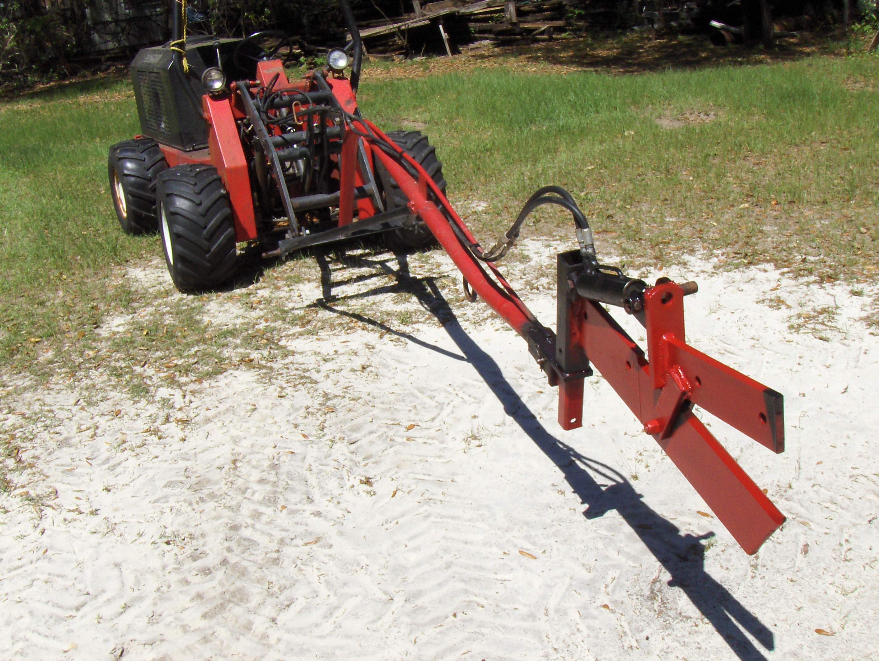

Here is another adaptation for the FEL arms. A tractor 3pt boom with a high reach limb cutter on the end.

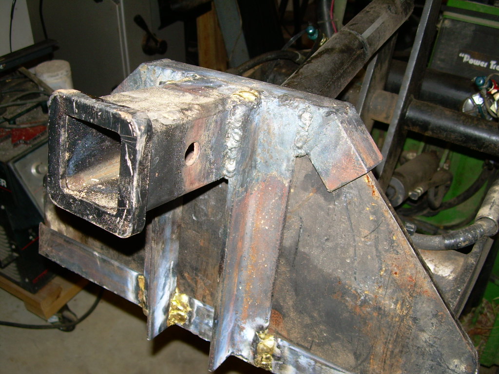

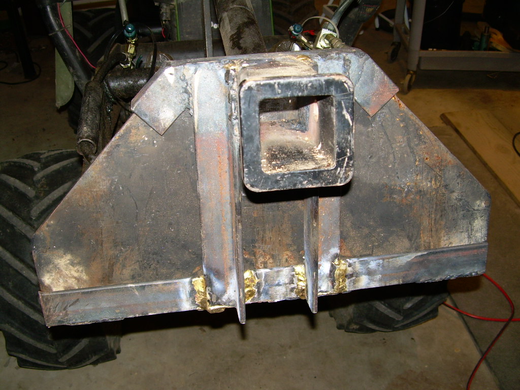

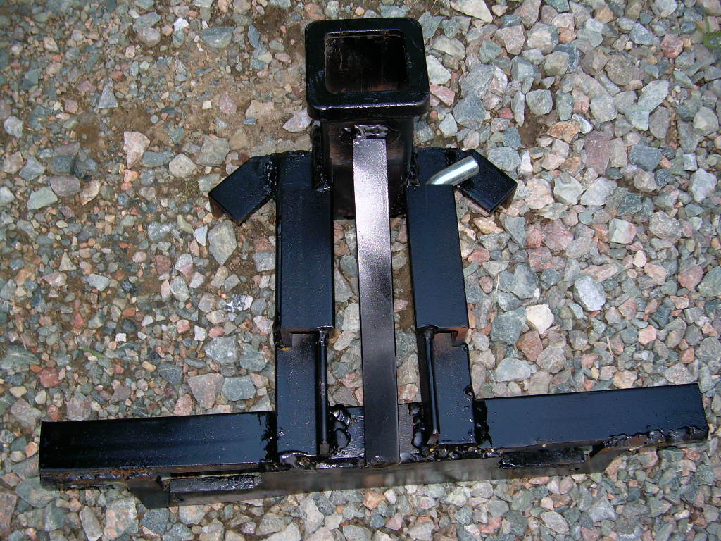

I also did a 2 inch receiver with a home made quick attach plate. It's not as strong I think, but OK for light duty use.
Yes I now have qty 2, two inch receiver attachments. The home made one was very cheap.
