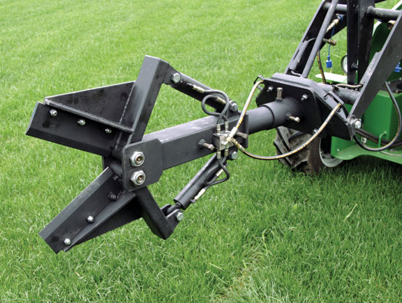

Here is another adaptation for the FEL arms. A tractor 3pt boom with a high reach limb cutter on the end.
That is sweet...... Sorry but i'm stealing your idea. Are the cutting edges blunt or sharpened? NO MORE LADDER AND CHAINSAW!!!!
   / Which hitch receiver adaptor would you get? #24
One blade has a 45 degree point. I would like to shape it like an axe. I used the shank from a subsoiler which is 3/4 steel. It can also be turned sideways, and upside down to cut tree roots. Mine has a small cyl on it, but you can put whatever your design can withstand.
Another picture. The second picture is a tree shear made by Power-Trac, at $3200

Wow, JJ!
That's awesome. You're a genius! Super super cool. Thanks for sharing.

How big of limbs can you cut? Is it hard to get hang of being that far out from the FEL? I have thought of making one with a hyd chain saw, but your idea looks mutch more doable.

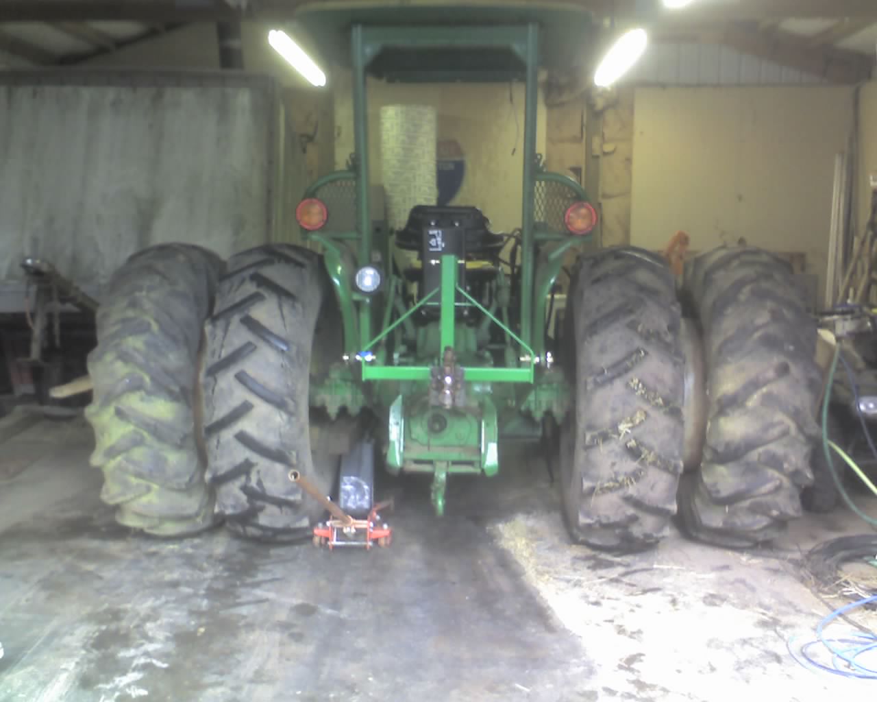

I bought a 3PH receiver from the JD dealer. I believe it cost me $79 + tax. Works great.
The first pic shows the receiver on the back of the tractor and the second shows a trailer attached to the hitch.
For short quick moves, I just back up under the hitch and raise the 3pt and drive away. For longer/bumpier moves or a loaded trailer I get off close and the latch before I move it.

How big of limbs can you cut? Is it hard to get hang of being that far out from the FEL? I have thought of making one with a hyd chain saw, but your idea looks much more doable.
It can cut about 4 in. I have the hyd chainsaw also but I have to make an adapter to mount on the chainsaw. The chainsaw is a closed center saw, so I need to figure how to activate it. Right now, I am thinking of tying the trigger down and operate my aux hyd to power the saw.
