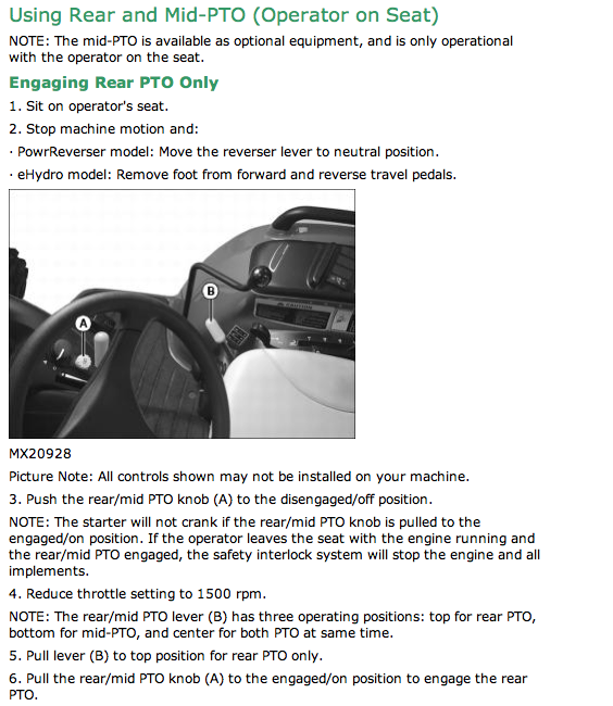

I'm not sure if the PTO selector comes standard with the three choices (see below)--but if you climb underneath and see a small splined stub near the center of the tractor (smaller than the rear PTO) then you've got the optional mid-PTO. I would think that a decent rear mower would be a better long term choice. It should give a good quality cut, is easier to take off and put on as needed, and has a wider range of resale options, and is usually less expensive. I think that the longer you have and use the tractor the more uses you will find for it--hence the logic behind easy removal etc. Also--the MMM are pretty specific to model and brand and therefor not as easy to find used or sell as a used one.
