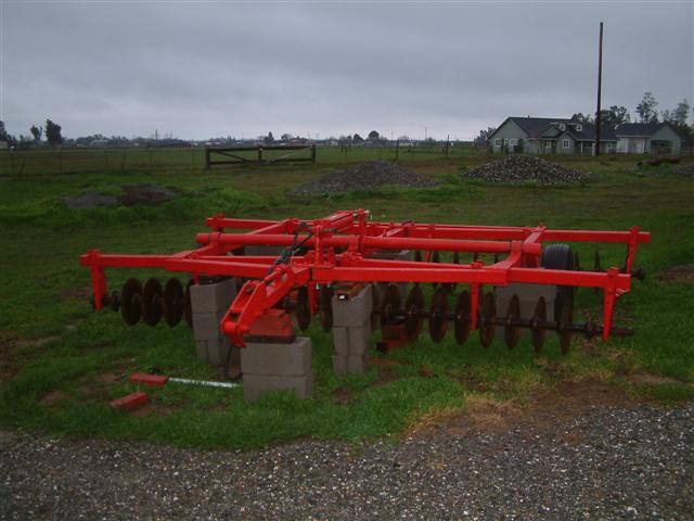

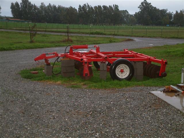

With the hp you have in that 7710, I'd look for a used 10-13 ft wide wheel disc. Here's mine-- it's an old Minneapolis Moline KA-1300 tandem disc, 13-ft wide, made by Krause for MM. I've removed several outer pans from each axle so my Mahindra 5525 (54 hp engine, 45 hp pto) can pull it on my hayfield.
