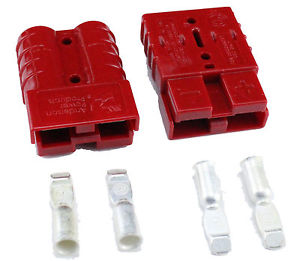

Perhaps the best brand in terms of quality for these connectors is Anderson Power. "Anderson" is often used as a generic name for this style of power connector regardless of the actual manufacturer. I've used one pair of X-H on a 3500 lb winch and never had any problem with them either.

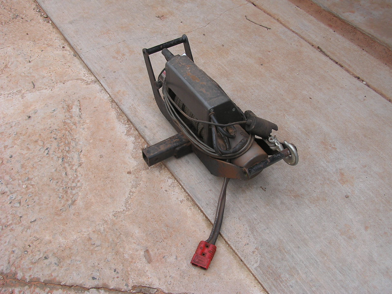

I also use Anderson connectors, they came with the winch and I bought more.

I have a winch on my truck, Jeep and tractor, along with high amperage inverters and 1 gauge jumper cables and use these connectors on them all. Plus I believe they are compatible with Anderson brand connectors, which not all are. I also replaced similar quick connects I had as these have a higher build quality than the others I had.
Use the largest diameter wire appropriate for the task to minimize voltage drop. I use 0 gauge to 4 gauge- depending. On the tractor I have 1 gauge (or maybe 0 gauge) running from the battery back to the 3PH area and terminated with these connectors.
I would email the vendor and verify Anderson compatibility.

For sure those Anderson are great.
Electric fork lifts use them for battery connection and charging
Tow trucks use them for booster cables,
My tractor and truck are equipped for boosting that way as are my cables.
My winch is set up with anderson as well.
To best of my knowledge the clones are compatible with anderson as well.

Anderson is the only way to go. Outstanding quality.
/ which brand quick connects for winch installation? #11
I love Anderson power poles in the 15-45@ range for general usage. Have a couple 75@ ones for RV battery disconnects.
Haven't used bigger ones, but wouldn't hesitate to use Andersons there too.
