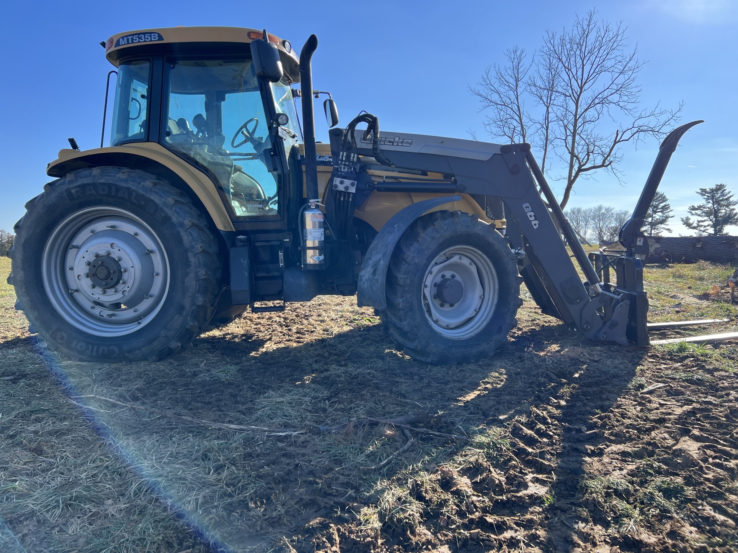

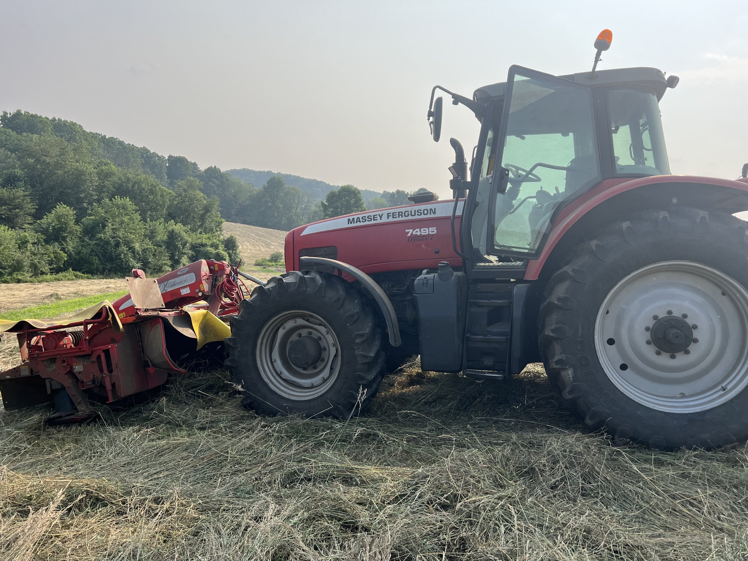

The Challenger has a Perkins in it at 135HP
The Massey has a Sisu turned up a lot higher about 190HP.
The cabs are a bit different, too.
I’ve been running AGCO equipment for many, many years.
I run the AGCO CVT tractors because they have a lot of German Fendt in them, but sell for much cheaper. I find them to be a bit complicated with all the wiring and electronics, but otherwise a great value when all you can afford are used tractors.

Cat or Perkins, same thing. Perkins knew they were not going to make emissions coming up and Cat wanted its own small engine instead of buying them from Mitsubishi.
So cat purchase Perkins in 1998. They redesigned the head/turbo at mossville tech center and put a cat fuel system and ECM on it.
The go down the same line and it’s just painted different colors depending on what brand it is.

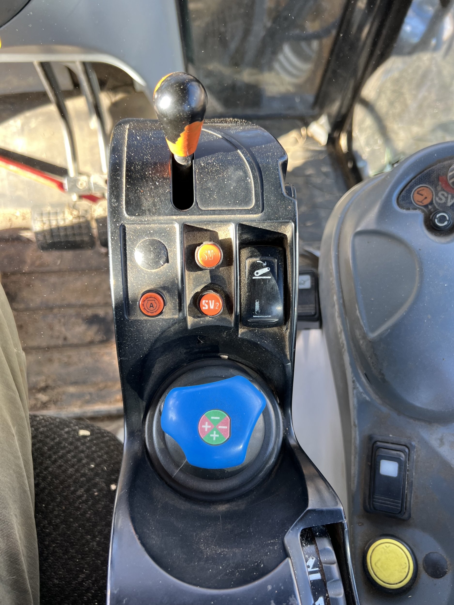

For the OP:
Here’s the arm rest finger tip CVT control in my Challenger. Massey looks exactly the same. If you can move this controller forward & backwards it speeds you up or slows you down. This along with the small reverser handle on the left of the steering column and the steering is about all it takes.
The small button the a gear around it and an “A” inside the gear is the “auto” mode where the throttle response is directly correlated to the CVT fingertip controller demand for more or less ground speed.
