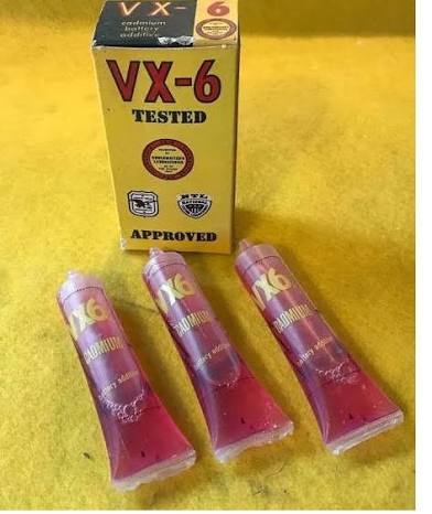

Maybe VX-6
There was an additive I used a couple of times that really worked… first time it was on a neglected boat battery… it was good enough to last a summer week on the lake.
