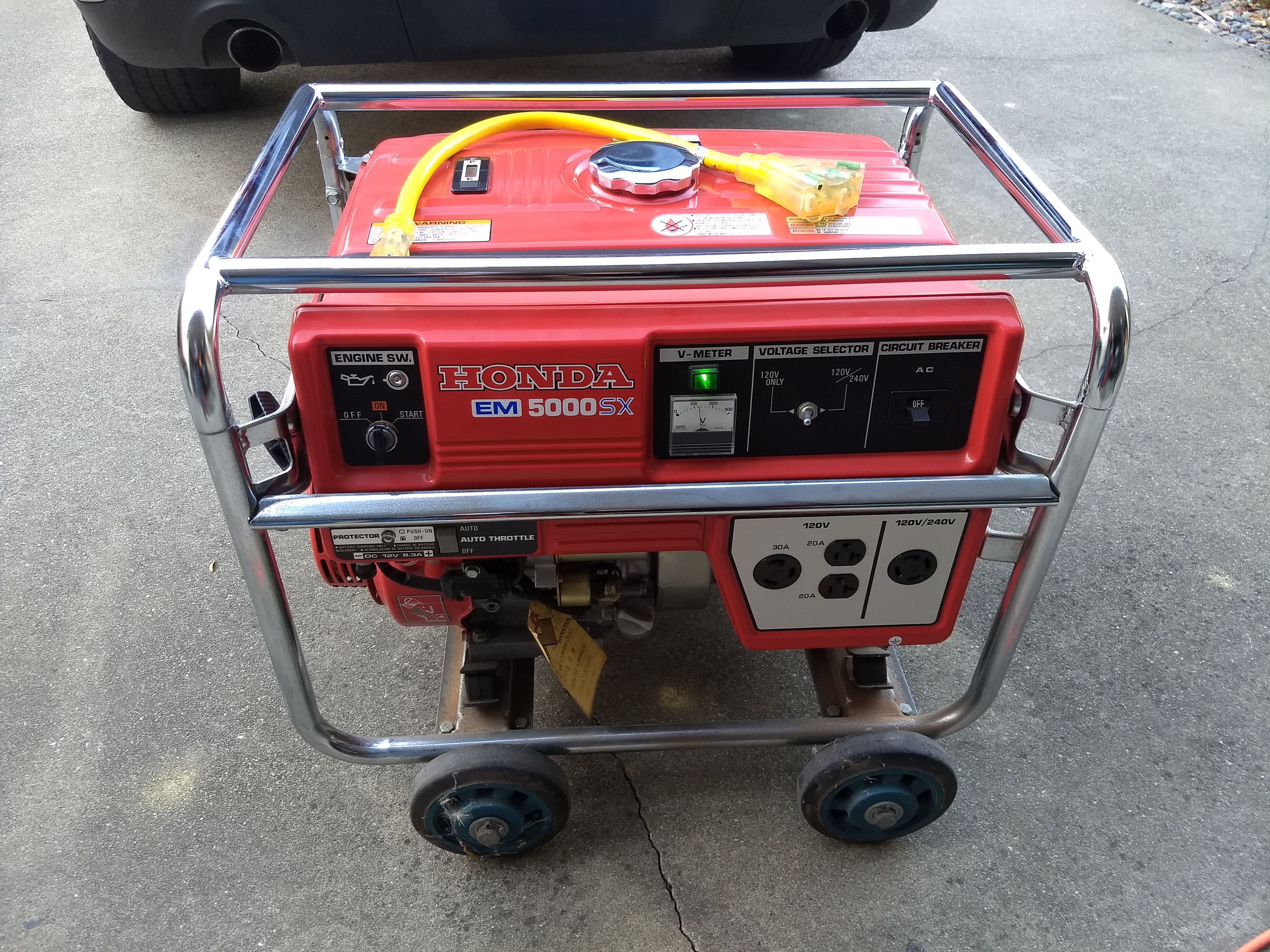

Will need to check others but my 40 year old EM5000 says Japan.
Nothing bad to say about it!
