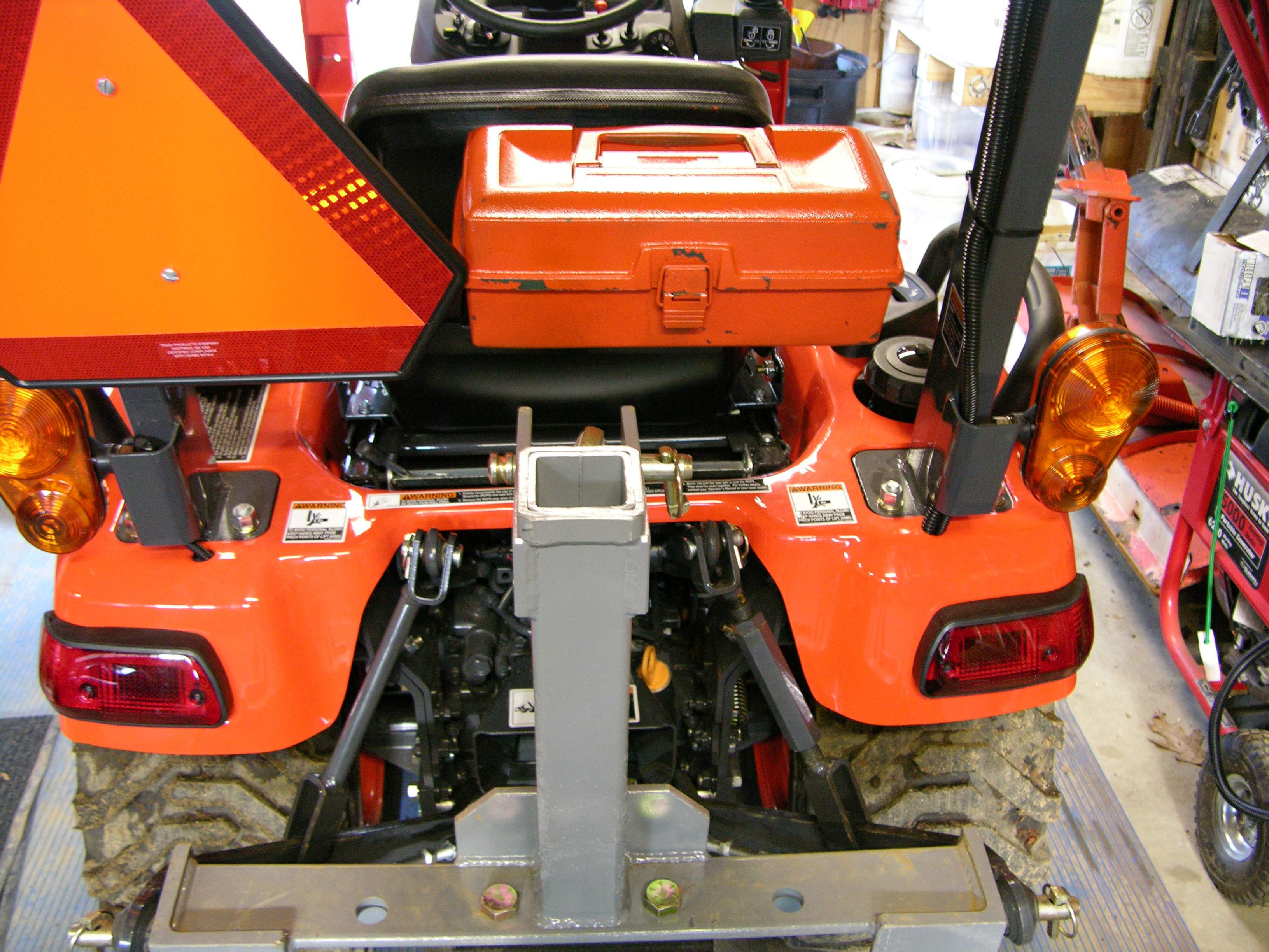

   / Where to put toolbox on little Kubota? #14
a picture is worth a thousand words

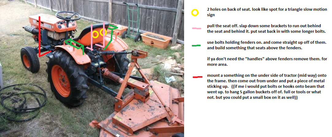

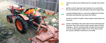

   / Where to put toolbox on little Kubota? #15
those cheap little tool boxes with a little flip latch on them or a tool box with a clasp for a paddle on them are junk on a tractor. i have tried them. and the locks just fall apart on them. just way to many vibrations, and cheap flimsy metal used.
ammo containers. have a better flip latch on them to hold them closed.
myself i prefer 5 gallon buckets. and hooks located around the tractor to hang them from.
a side note, another reason for hooks, is to hold the 1 to 3 gallon jugs of water or tea. or buckets to hold the cold beverages with some ice in the buckets.
some folks use bungie cords to hold the water jug on. not for me.
edited your picture to show various spots.

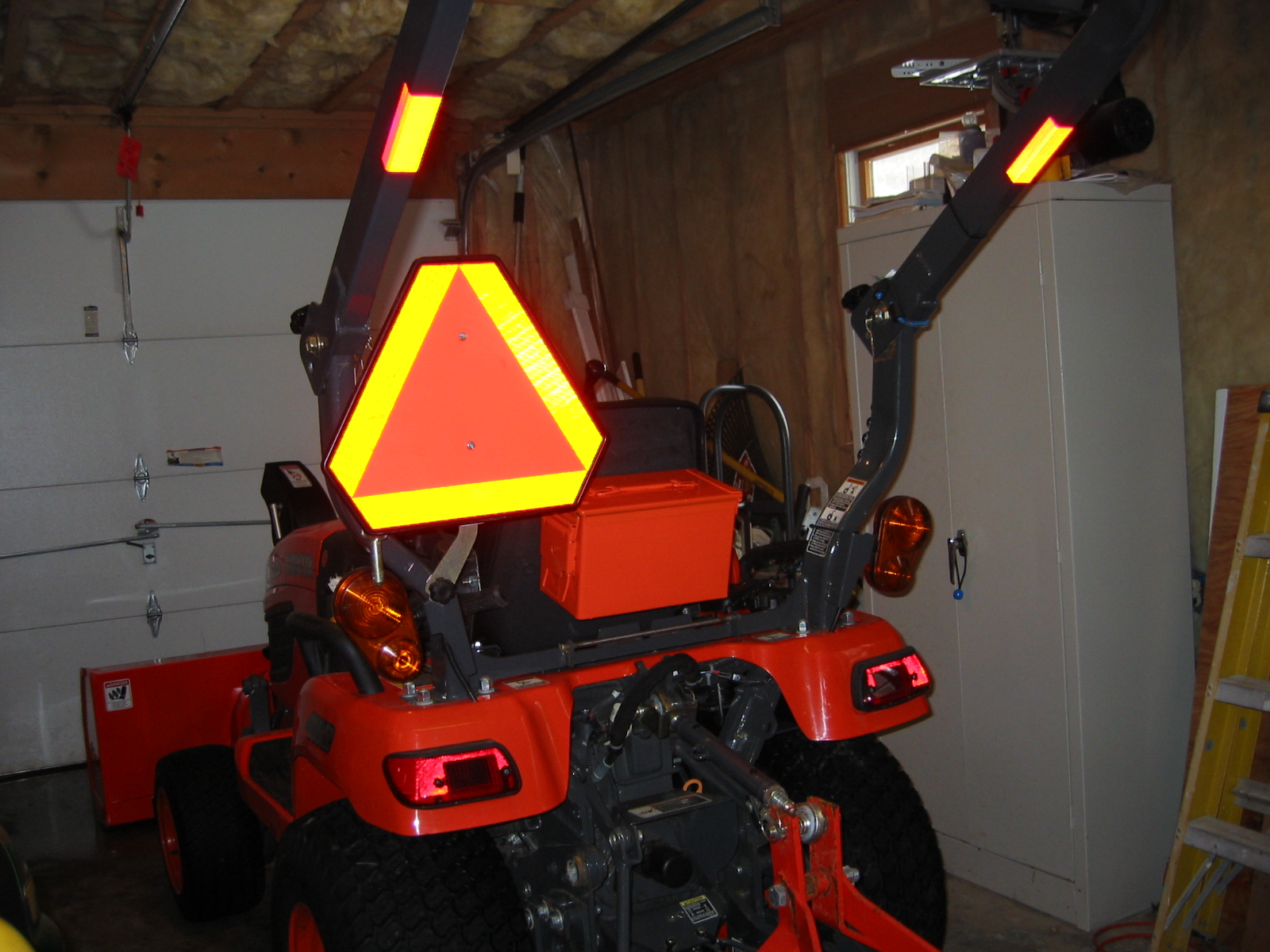

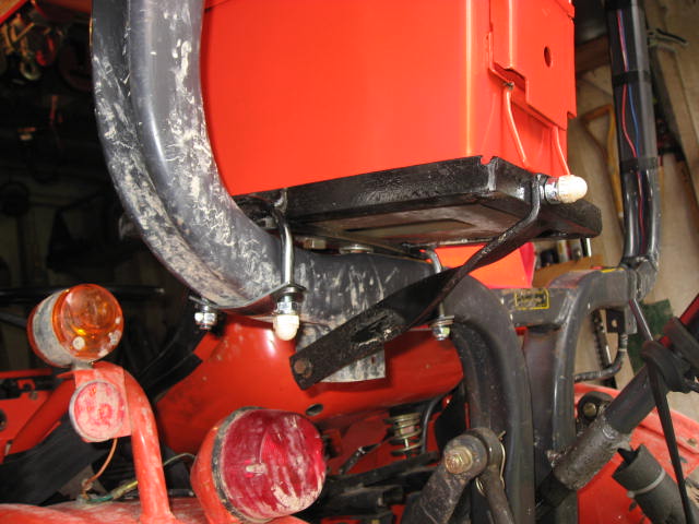

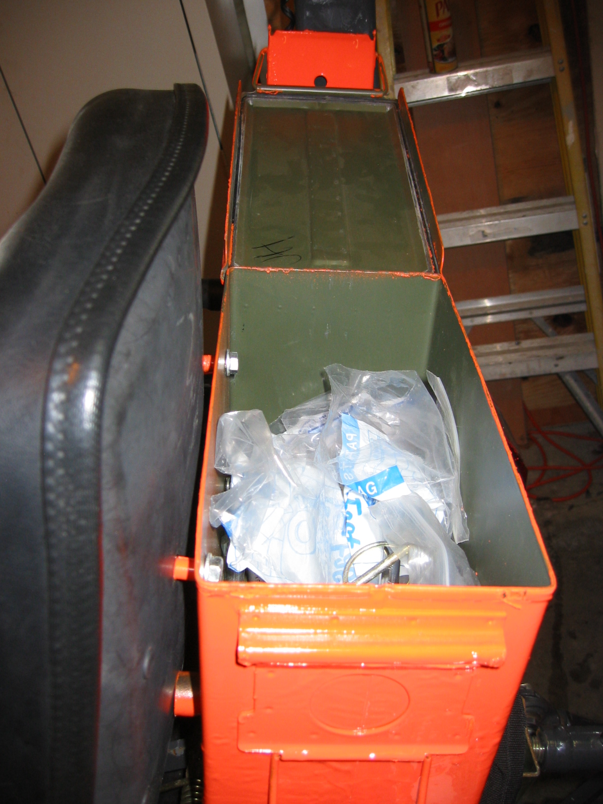

   / Where to put toolbox on little Kubota? #17
I have a BX 25 and on the back of the seat are plastic plugs and behind them are lugs for attaching arm rests. I got a 50 cal.ammo box and drilled out holes to match the ones in the seat and mounted one there. I don't know if your seat is set up the same way though,but if it is,it's a good place to mount one. My seat also has to turn around for the backhoe and the toolbox doesn't get in the way. If you need pictures I can post them.They are on my other computer. My post should be in here somewhere under "Toolbox for BX25"
Her's a few pictures
