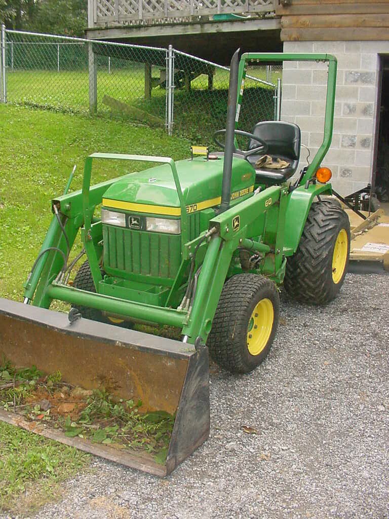

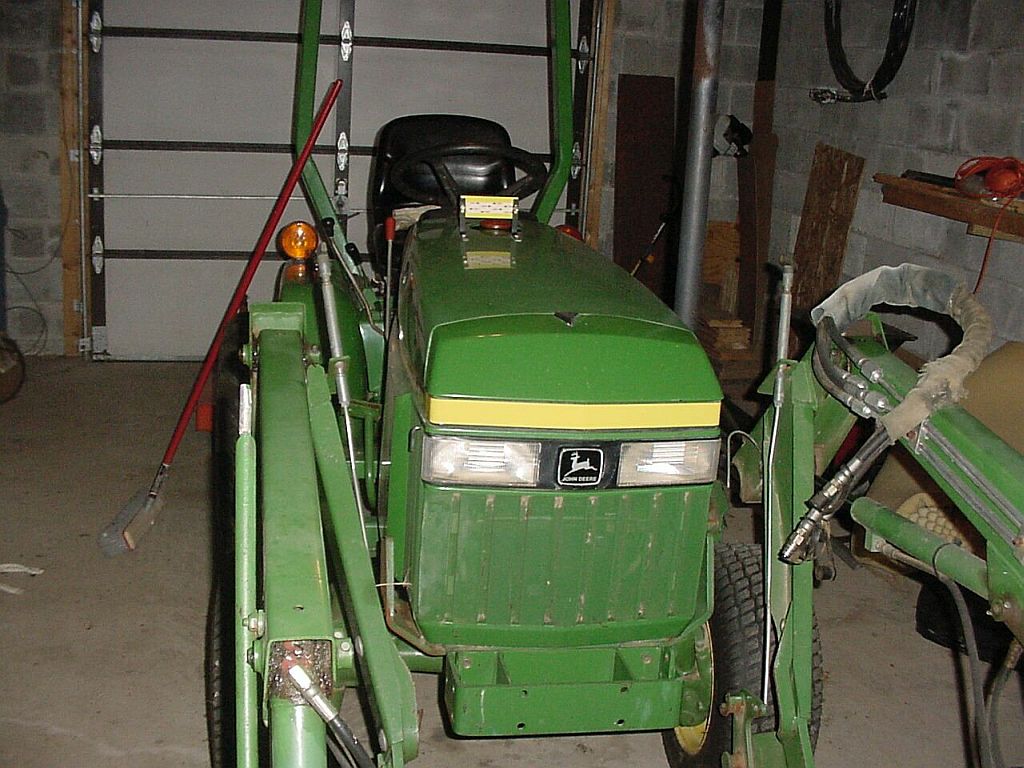

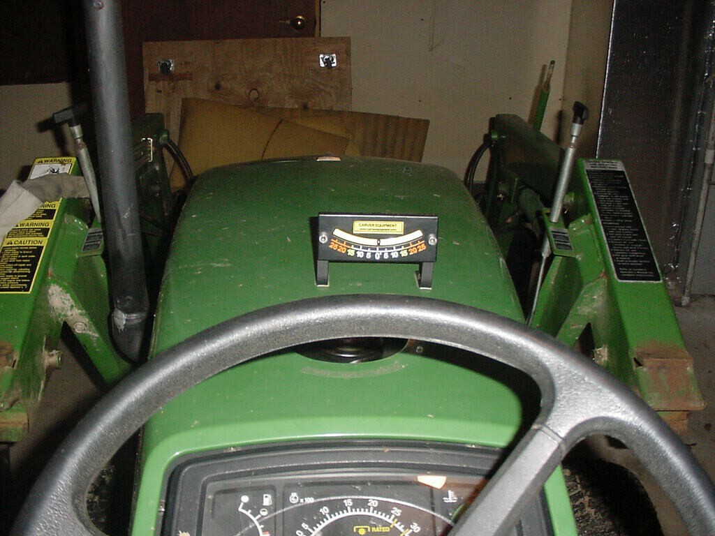

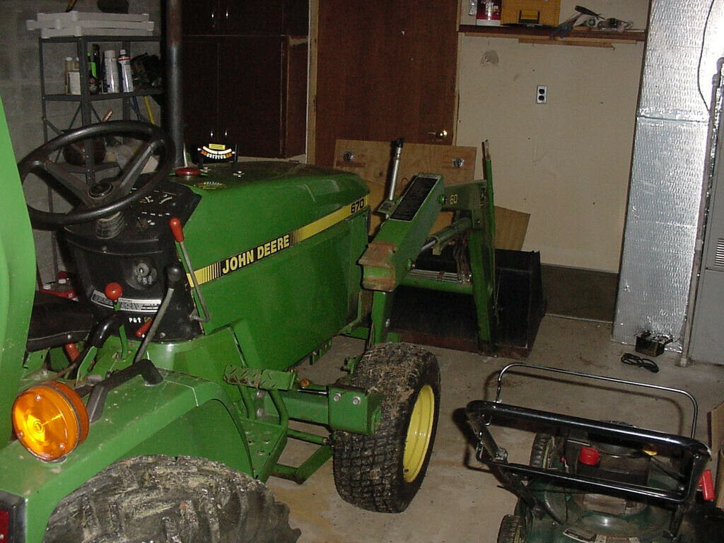

This is where and how I mounted mine (attached pics). The pics just give a few different views.
Make sure you're on a fairly flat, level surface when you mount the tiltmeter.
I drilled my hood (it was a used tractor anyway), but the double sided tape is quite robust if you don't want to drill.
This was on a Deere 670 which was the 790's older brother.
Now, I'm sure you're going to ask why I didn't mount it on my 790. Well, the 670 was the first tractor I had operated since my Dad passed away, so I wasn't real used to them. Also, I'm much more aware of my property so I don't feel the need for the tiltmeter as much as I did. And, with a lot more hours, I'm more familar with the machine's capabilities and limitations (not that I'm getting complacent).

Good point, Jerry, that the current mounting system allows for side-to-side leveling. But looking at Roy's setup, even though it's "fixed" side-to-side, it looks much more stable than the current bracket with the single block in the middle. I'll have to see how my wife feels about me drilling thru the hood. I'd feel more confident about the double-sticky if it were on the ends like Roy's. Hm, I also wonder how well that stickum would hold up to the occasional diesel spill.
Roy, thanks for the photos. I have a "from the seat" photo of our 790, and was trying to imagine how the meter would fit in front of or behind the fuel cap. Hard to get that perspective/scale with just a photo in one hand and the meter in the other. Your photo of the meter installed demonstrates how visible it is, even mounted on the far side of the cap. I'm gonna give that location a try. I was hoping to find a way to mount it to the top edge of the instrument panel bezel, but I'm sure it would be visually blocked by the steering wheel.
BTW, why is yours off-center a bit? Seems like, with the slight "crown" of the hood, it'd be most level dead center.

Actually, I eyeballed it in place. Once I realized I'd drilled the first hole off center..well, being perfectly centered wasn't too important. The camber of the hood makes it look more offset then it actually was.
The main thing is that it be level to the ground.
