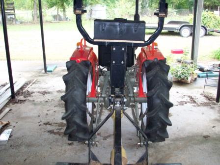

i have a VN ROPS and there more of a flat spot that on Scotty tractor. I took and old metal toolbox and mounted it on top of 3/4" plywood I put under the tool box for stability and put a piece of plywood inside the tool box so the bolts would not rip through and u bolted it all to the ROPS. Its right behind the seat. I keep a few wrenches, sockets, huge cresent wrench (for lift pins etc), bungee coard and extra pins. I also have the small maybe 1.5" tall toolbox on the bell housing. Which is good for pins and maybe the most common wrenches for the tractor like 10,12,14,15,17,19mm but not much more.
/ Where to mount a tool box? #12
Here is a pic, I had to look back through my previously posted pics

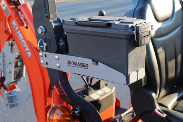

Rather than trying to build one, here is one we make that comes with all the hardware and mounts on the ROPS. Many people purchase the extra ammo can so boxes can be swapped according to the task at hand. Takes about 5 minutes to install the bracket and can be placed in almost any direction on the ROPS. Here is a link: BXpanded Tool Box
