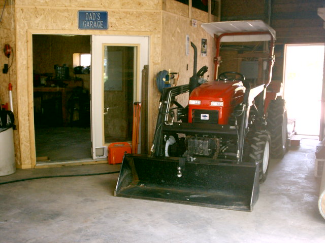

I will second the receiver hitch. I put 3 hooks on mine. One on each end and one in the center. The only place I have found weld on hooks was online and at a little mom and pop hardware store.
Hard to see the hooks but there is one on each corner and one on top of the hitch.
Chris
/ Where to get weld on hooks? #20
Chris
It appears the bucket where the receiver is bent down somewhat, is that caused from use of the hitch?
