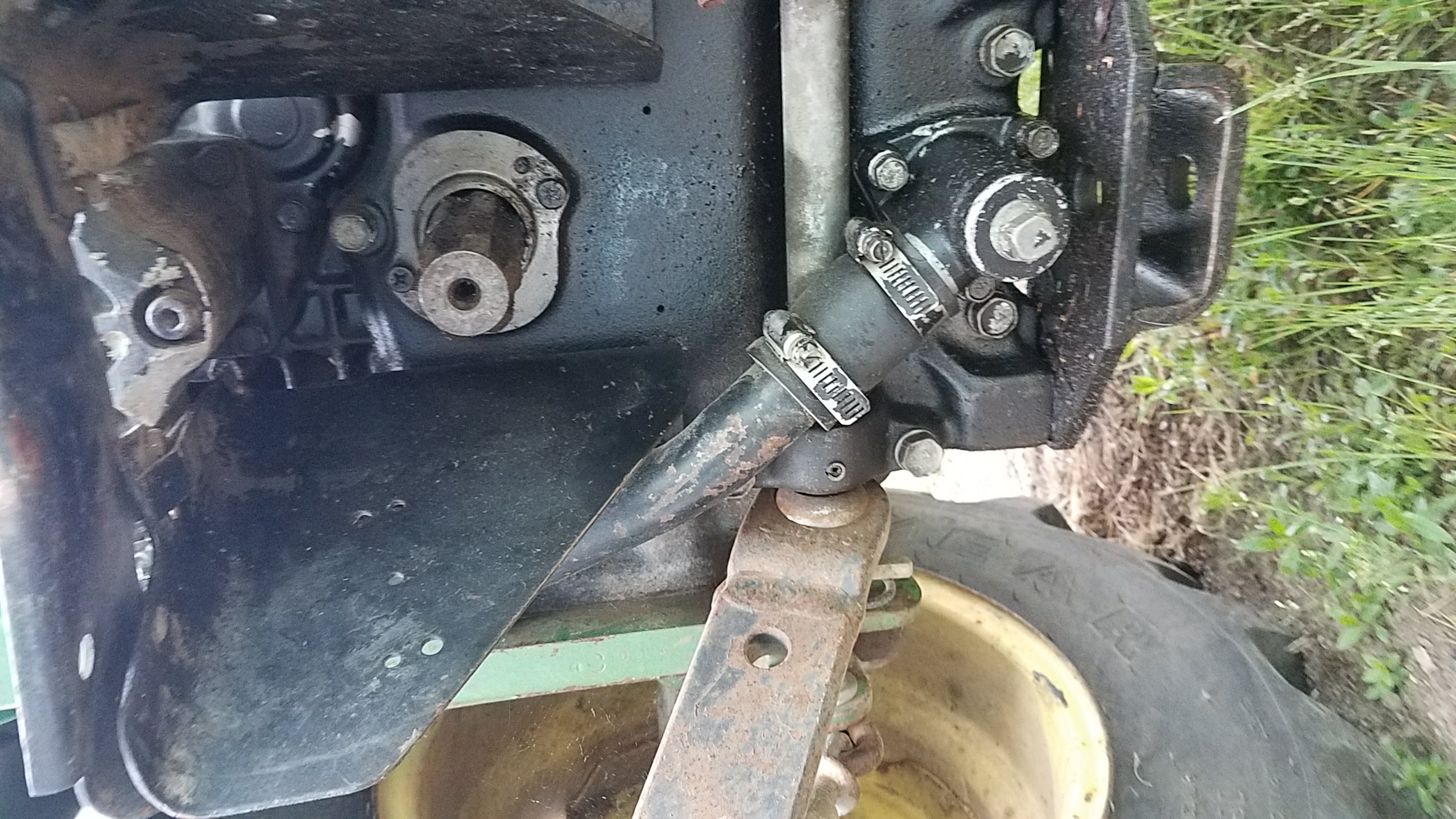

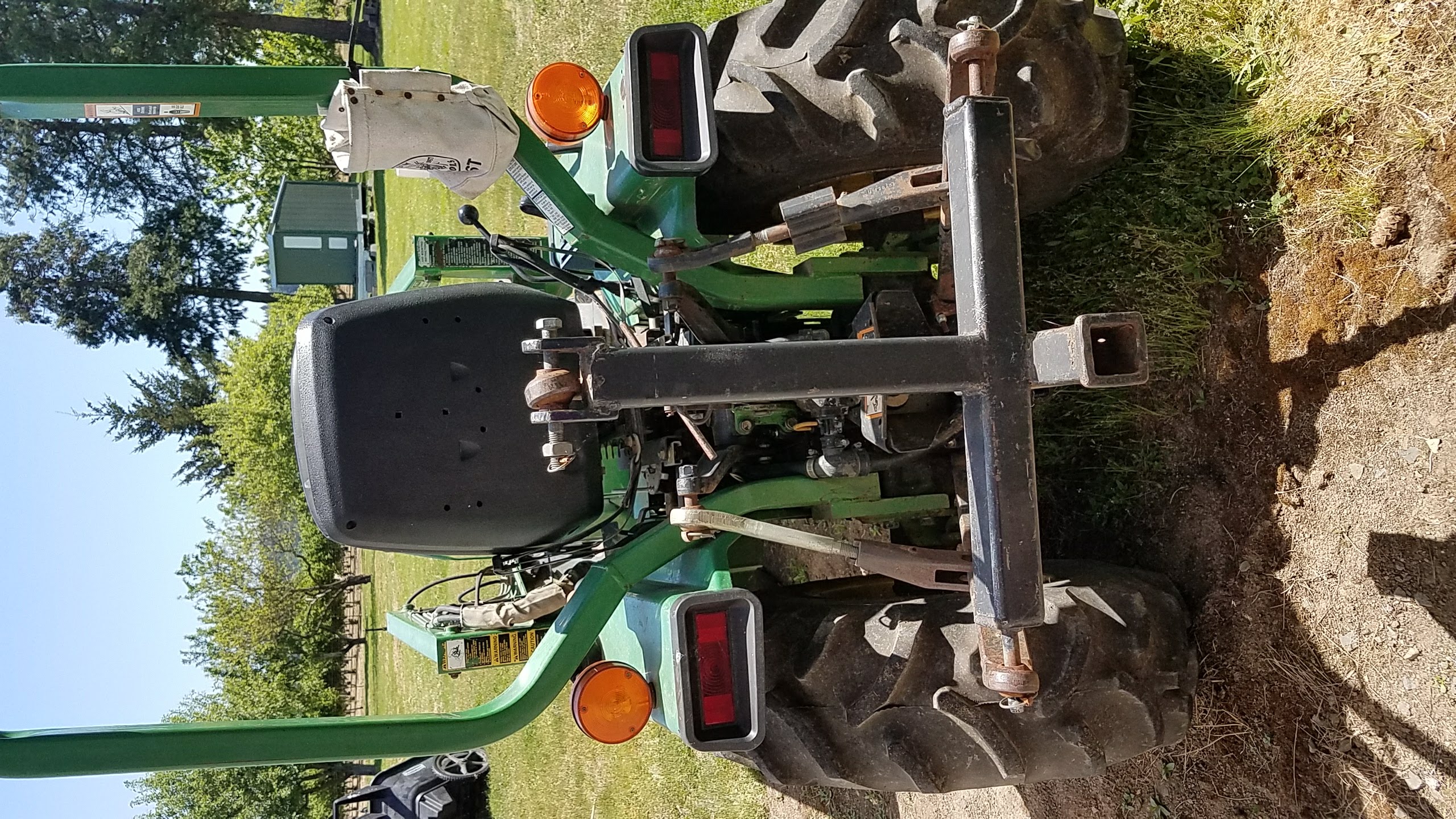

I am trying to locate the model year of my John Deere 955 Tractor. I called JD dealer they said the plate with the serial # would be around the PTO shaft but I can't locate it anywhere. Can someone help?
View attachment 554614View attachment 554615

Your plate is missing, it mounts where you see the two small holes
With no plate you can do other guesswork for a close enough date. Deere usually has a date stamped in the rim of their wheels. You can try that.
Also, there are changes that occur after a S/N break and you can search parts diagrams for changes.

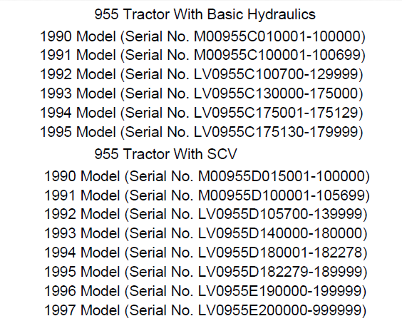

955 sn.PNG Like others said, you are probably going to spend a little time in the pc looking for changes at s/n breaks but here is the chart, available at the JDparts catalog online. Good Luck

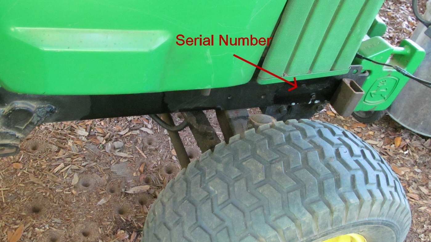

The operator's manual I have covers 755, 855, and 955 models from serial numbers 100001-. It states on page 123 that the Identification number is located on the plate below the rear PTO and stamped into the frame at the right front.
My 855 has the number in both locations and begins with LV0855. Looking at the chart above yours should begin with LV0955 or M00955.
A picture being worth a thousand words I took one and drew an arrow to the location of my frame stamped number.
