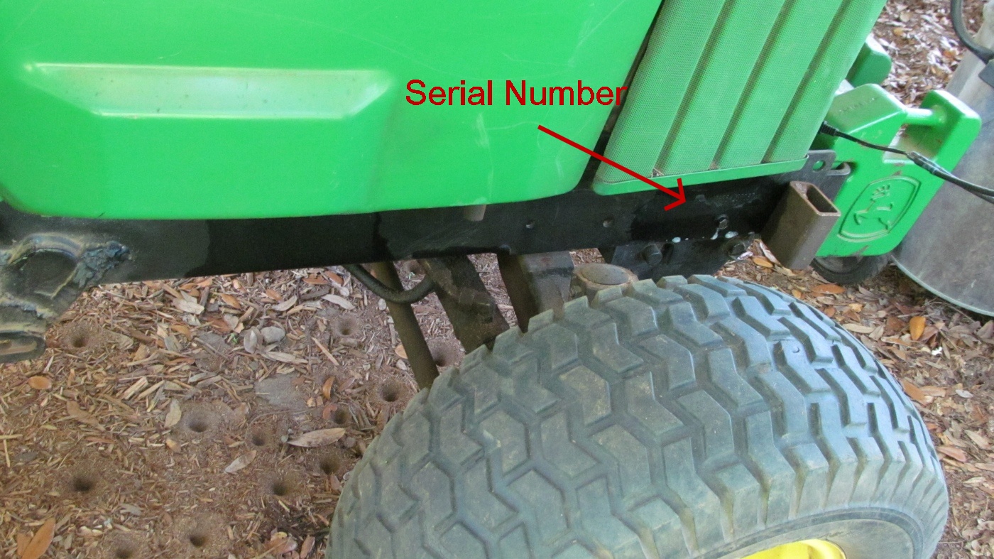

The operator's manual I have covers 755, 855, and 955 models from serial numbers 100001-. It states on page 123 that the Identification number is located on the plate below the rear PTO and stamped into the frame at the right front.
My 855 has the number in both locations and begins with LV0855. Looking at the chart above yours should begin with LV0955 or M00955.
A picture being worth a thousand words I took one and drew an arrow to the location of my frame stamped number.
