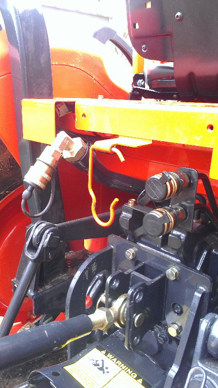

The fitting(s) my dealer put into the HYDRO fill port on the upper right side of the trans, replaced the large red rubber plug with 'Shepard's hook' vent built in. Mine has two fittings - one the same size threaded metal male fitting into which a female QD is screwed, that allows me to plug in one hydraulic hose from the hoe. The other hose goes into either the A or the B factory installed rear remote female QD. I was told this routing would allow for the hoe to run better due to more adequate cooling of the hydro fluid, if one tended to run the hoe hard and hang her up wet.
There should be no cross threading issues, nor should there be any powder coating issues either.:confused2: Recent models, like my 2010 DK, have a place on the opposite side of the transmission to install a smaller vent port into the housing by removing a bolt and installing the 'plug/vent'.

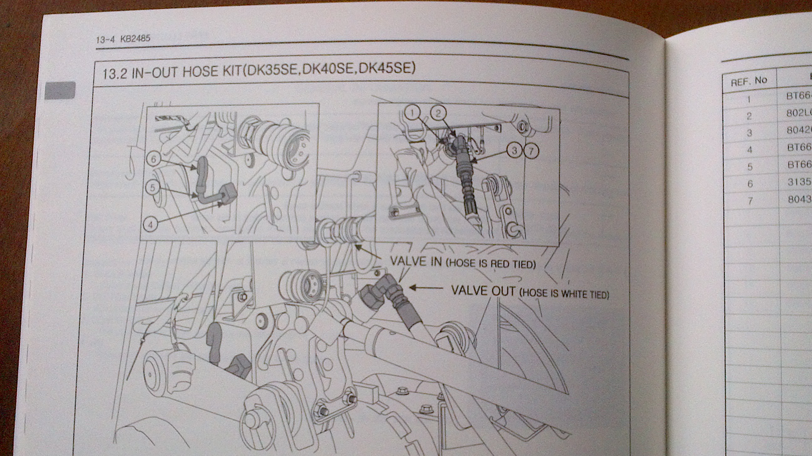

It clearly shows the kit in the owners book for the Hoe, sect. 13-4
I just purchased DK40 with backhoe and am now waiting for the backhoe to arrive and be installed. I for some reason get the feeling that they will hook the return line up directly to the remote and I do plan on working this machine So in an effort to avoid confusion when I stop to talk to the salesman I would appreciate if someone could scan this page/section of the manual and post it here so I can copy/print it and show them exactly what I want from the start. No confusion no going back and redoing things and cooler running machine with less jerky movements is what I want/need.

Just tell your dealer to install the hoe kit that routes the hoe's return through the fill port, instead of through the standard QD return fitting. There's little room for confusion.

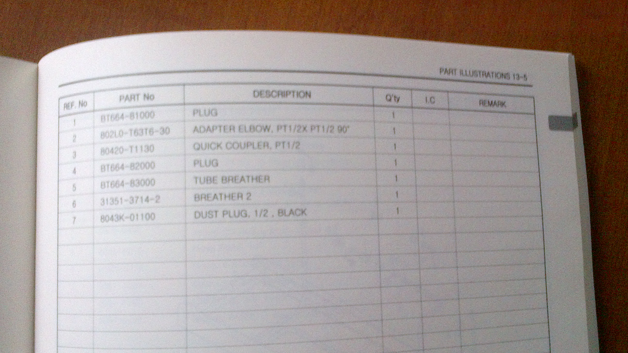

I talked to the dealership yesterday and the salesman didn't seem to know about this kit. I explained it the best I could but he still seemed a bit confused on it.
Would it be possible to get some pics of the installed kit? You know what they say A picture is worth a thousand words!

This is the factory kit on my CK 35HST.

It's in the Backhoe Manual on page 13-4 and the parts list is on page 13-5. Hope this helps.
That's a good pic, and on the DK series it's on the opposite side of the tractor. And the relocated breather shown in the backhoe manual, in the post after yours, is similar but somewhat updated as to where/ how it connects to the side of the tractor.
If it were me I'd talk to the parts dept guys instead of the salesman, especially since he doesn't seem to know what you want....
